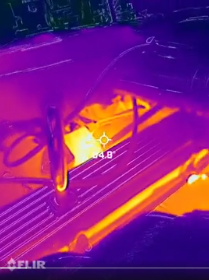

fyio.. that heat riser IMO is a waste. My choke maybe adds 2 minutes to come off high idle and even recent below freezing temps..it gets hot without it, and always has a restriction and risk of failure..
about 1 minute in is choke hot air
https://www.corvetteforum.com/forums...d-to-warm.html
I like OEM too.. and quite frankly would love headers too.. but for me and a packed 79 ac engine compartment. not enough squeeze at this time., can always add later.
too bad Allens is no longer..i think i am all in from manifolds back including spacer for heat riser ~ 550 bucks. and walmart mufflers dynomax were 200 of that.. ss band clamps at RA are cheap and high quality,
