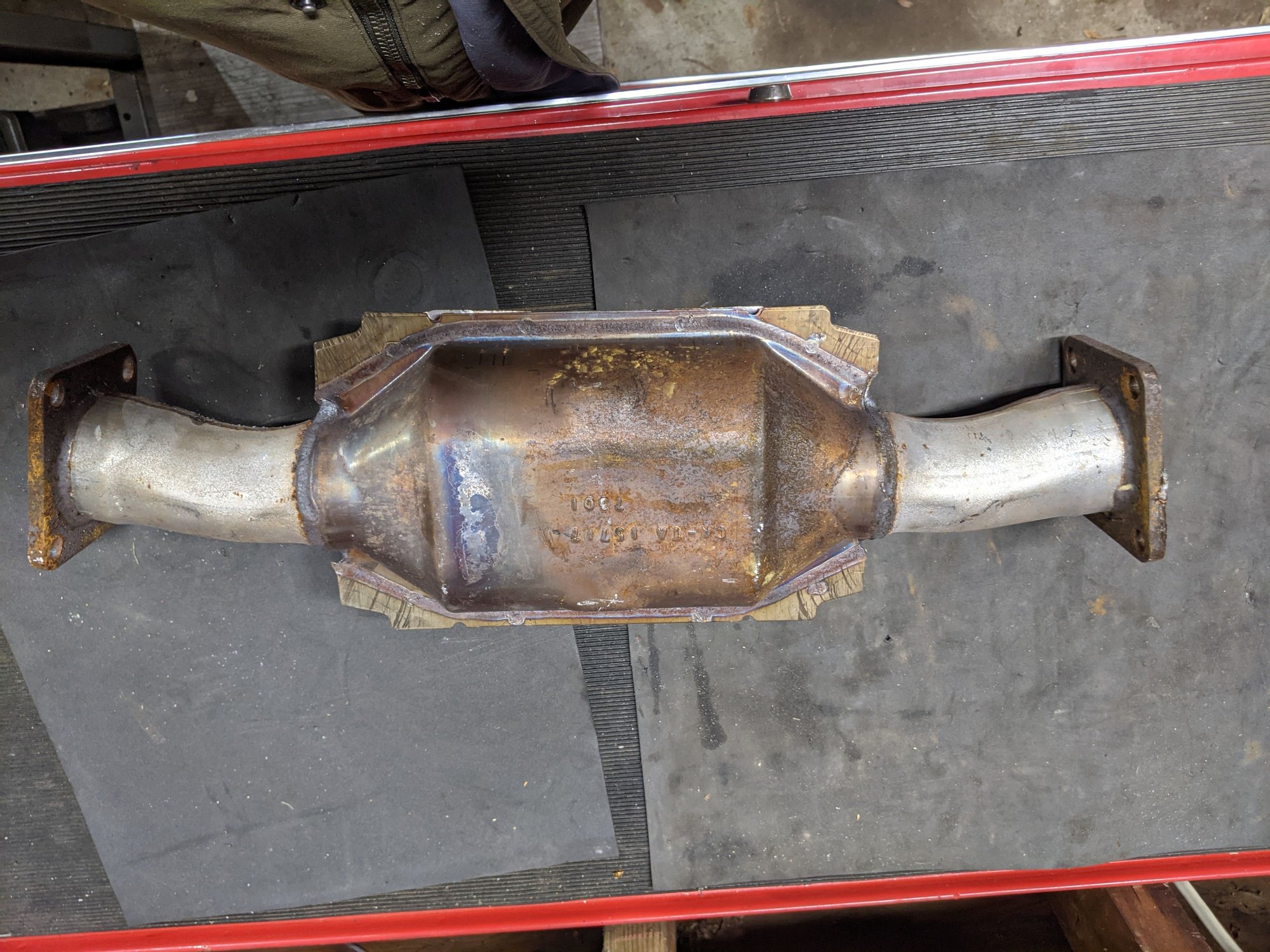

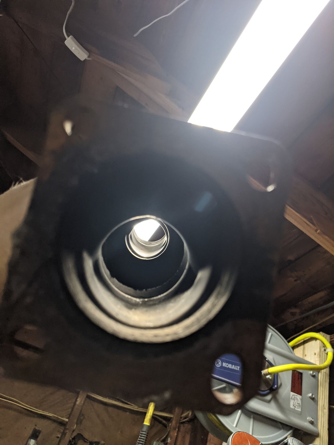

If u r still wanting to just replace the cat with a pipe.... I saved the one that was on my car. It turns out it was a pipe incognito of a cat.😁 It measures 19.25 right down the center. If u r interested in it you can have it, just pay the shipping

I'll take it I sent you a message via here.....
