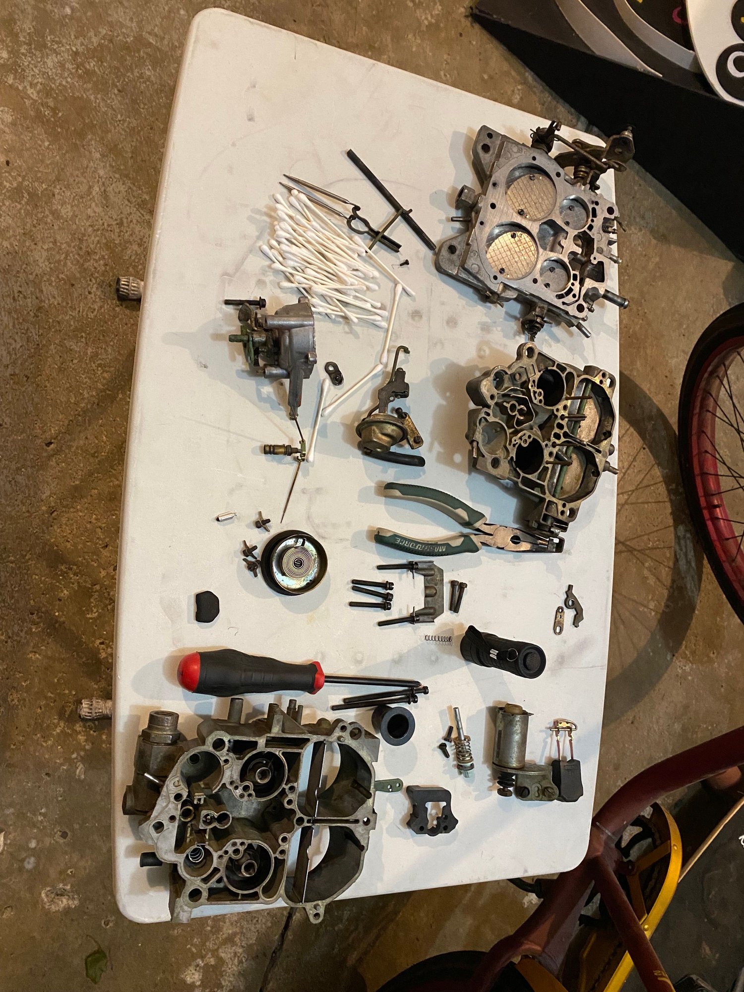

Hey there, I purchased a 76' in the spring. Carb was in decent shape (Original Quadrajet) but went ahead and tore it apart. I have never rebuilt a carb before and am pretty green wrenching on a car in general. If you have the time and patience it can be done. I ordered a rebuild kit from Cliff's High Performance, watched several youtube videos (Be careful here they are not all equal in accuracy) and took it apart myself. A ton of photos on my iPhone for reassemble purposes and cleaned the crap out of it. Looking back it was really easy and fired up on the 1st crank. Granted, It was in decent shape to begin, most notably bogging when we accelerated. Fun project and learned a lot by DYI and got a better understanding of the vehicle in doing so. Good Luck. I would have sent mine off as well, but had some time this summer in the garage and new if I jacked it up or lost my patience I could send it out to a pro. Not for everyone, but just sharing my experience. Good Luck!

Thanks for the confidence builder and sharing your experience. I also don't think the car runs like it should. Lars tells me that timing is key. So I plan to check that soon. I've already done the plugs & wires (what a bear!) and changed all the filters/fluids. It's got the electronic ignition too. So it must be in the carb / timing area.
I always enjoy father - son projects so will likely "dive into the deep water". I would also think the carb on my '73 is more simple in design than your 79 too.
