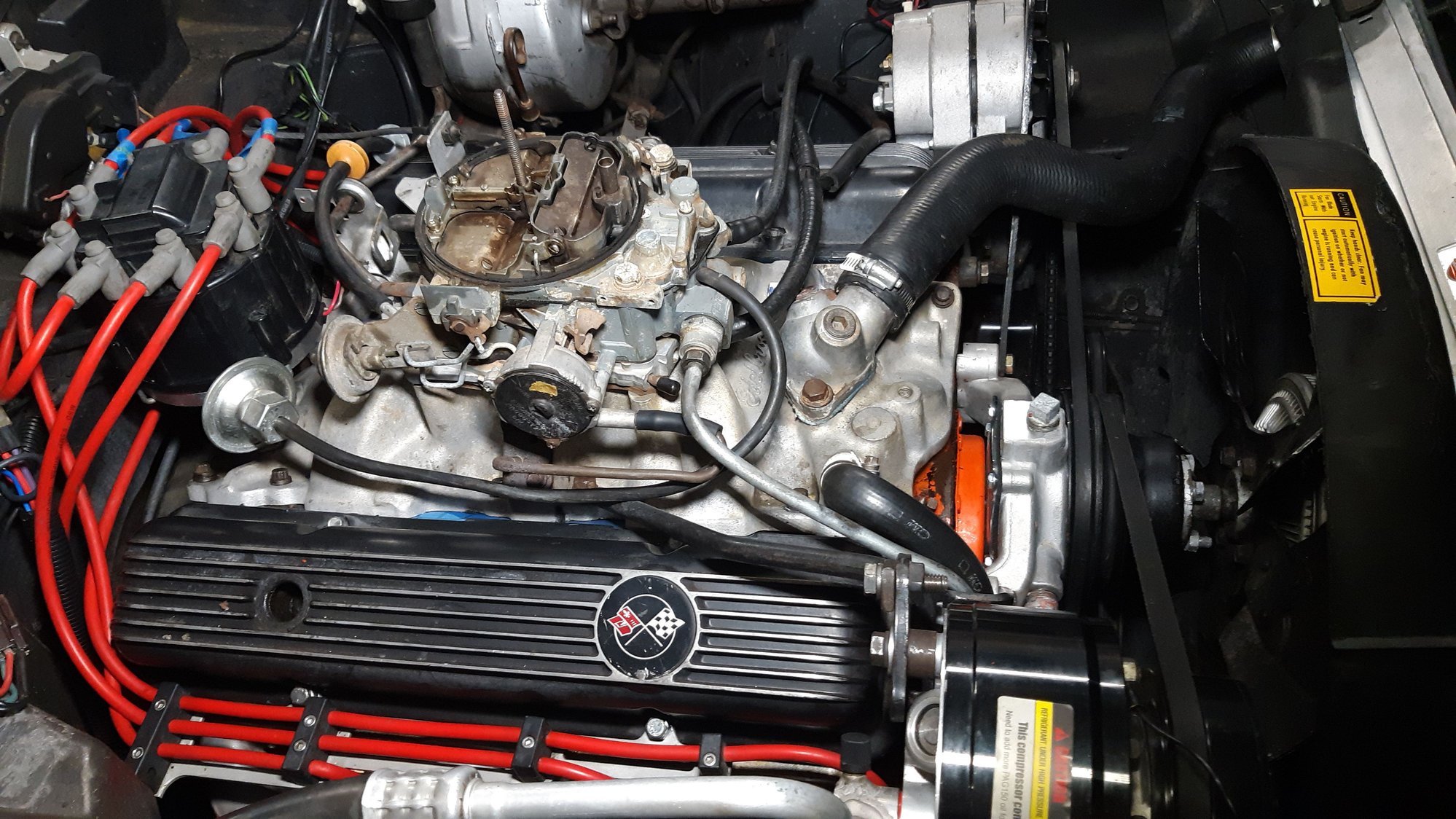

I know you want full manifold vacuum to the distributor, but here's my dumb question. Which is full manifold vacuum? Do I have mine set up that way?

Right below the fuel inlet line there’s a fitting with a rubber cap. Manifold vacuum.

All ports on that carb are manifold vacuum except the port coming out of the throttle plate on the forward passenger side at an angle (with the black rubber cap on it). That port is ported vacuum.

Just to clarify for me please? The stock hose connection as picture in the OP's post is manifold vacuum?

Start it up and see if it sucks your finger at idle! If it does....then you have full manifold vacuum......

The OPs hose is not connected to the stock location. It is connected to a manifold vacuum port normally used to supply vacuum signal to the A.I.R. pump diverter valve and to the EFE through the manifold thermal vacuum switch. The stock vacuum advance location is the forward, driver's side port in the float bowl, which is also manifold vacuum on that carb.

Thanks Lars! I see he is missing a vacuum pot/diaphragm (above and fwd of choke) that has a link that goes to the secondary butterfly's. What effect does this create?

He is running an incorrect Heavy Duty Truck version of the Q-Jet, which uses a rear choke pulloff only. That 1-ton truck carb does not use the standard Corvette/passenger car forward pulloff, and is an ill-suited carb for his application. The rear pulloffs are also notorious for leaking, seizing, and failing, so there's a really good chance that it's defective as well... The OP would be well advised to locate a correct vintage Chevy passenger car carb for his Vette.

Lars, thank you sincerely for your comments on.my carb. I knew it was not a correct carb, I even knew from your papers it was a truck carb, but what I didnt know was how potentially bad it was. I will start my search for a correct carb. Anyone have a correct 79 L-82 4 speed carb lying around??
