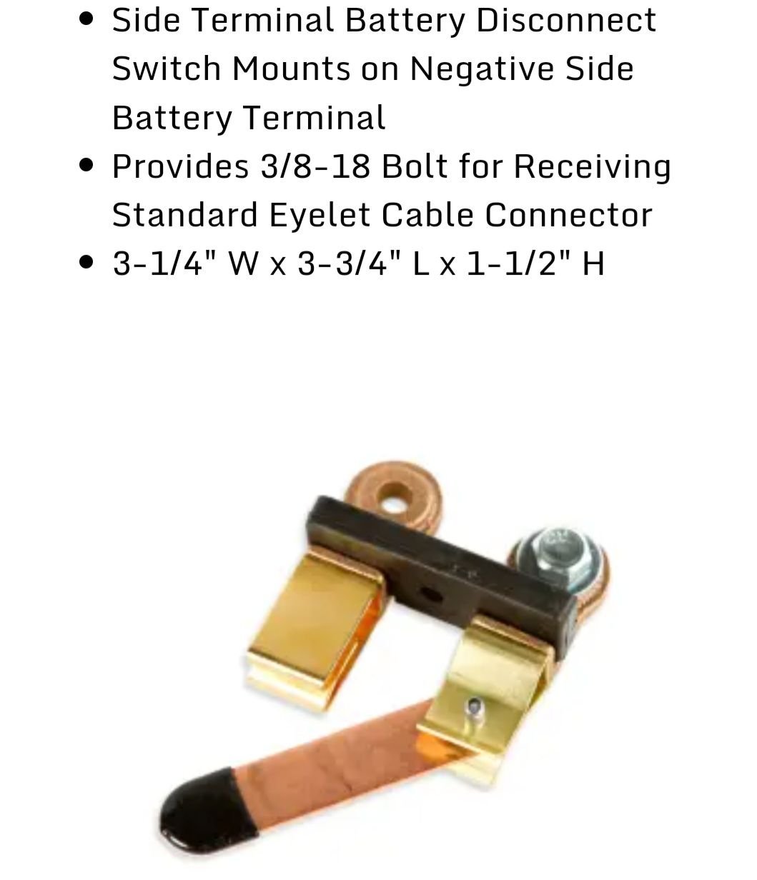

I use this.

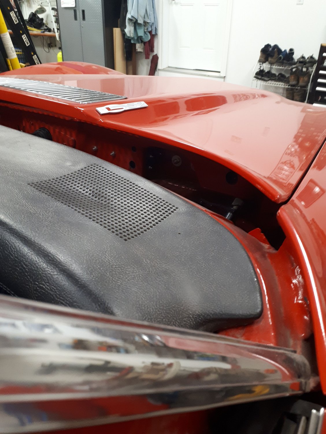

I bought a weather proof connector from an RV place and installed it on the passenger side of the wiper tray.

I guess I'm just old - fashioned:
That's how I have done mine for years, easy connect and go. The only issue I can was one year there was a power spike and burned out the charger. The cost of a new one with free shipping was about the same as the warranty replacement that you had to pay for shipping, so I just bought a new one.
