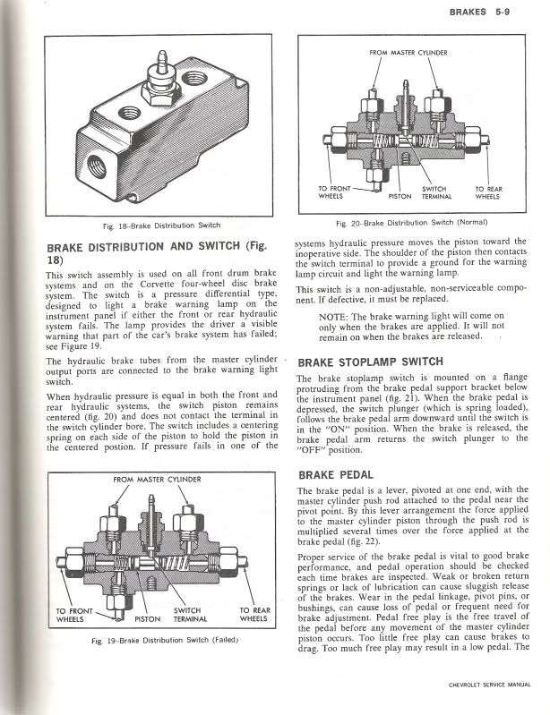

What year is your car? It makes a huge difference. Take a picture of the valve. Sometimes people install the wrong valve. The earlier cars DON'T have a normal proportioning valve. It is only designed to light the brake light and shouldn't be stuck to one side or the other. If it is stuck,,,, it's a bad valve.
If you have a 74, it should be the new style, pressure difference shutoff, valve. It is only designed to shut off pressure to the failed side.

If your car has the original valve,,,, it isn't a proportioning, it is just a brake failure light switch. It isn't supposed to stay stuck to one side or the other. If it is, the switch is all gummed up. It should only light the brake warning light when you have a failure and pressure on the pedal. It does not shut off pressure to either side of the brakes when working properly. If you don't have front brakes, there is a different problem.

Read the "note".
