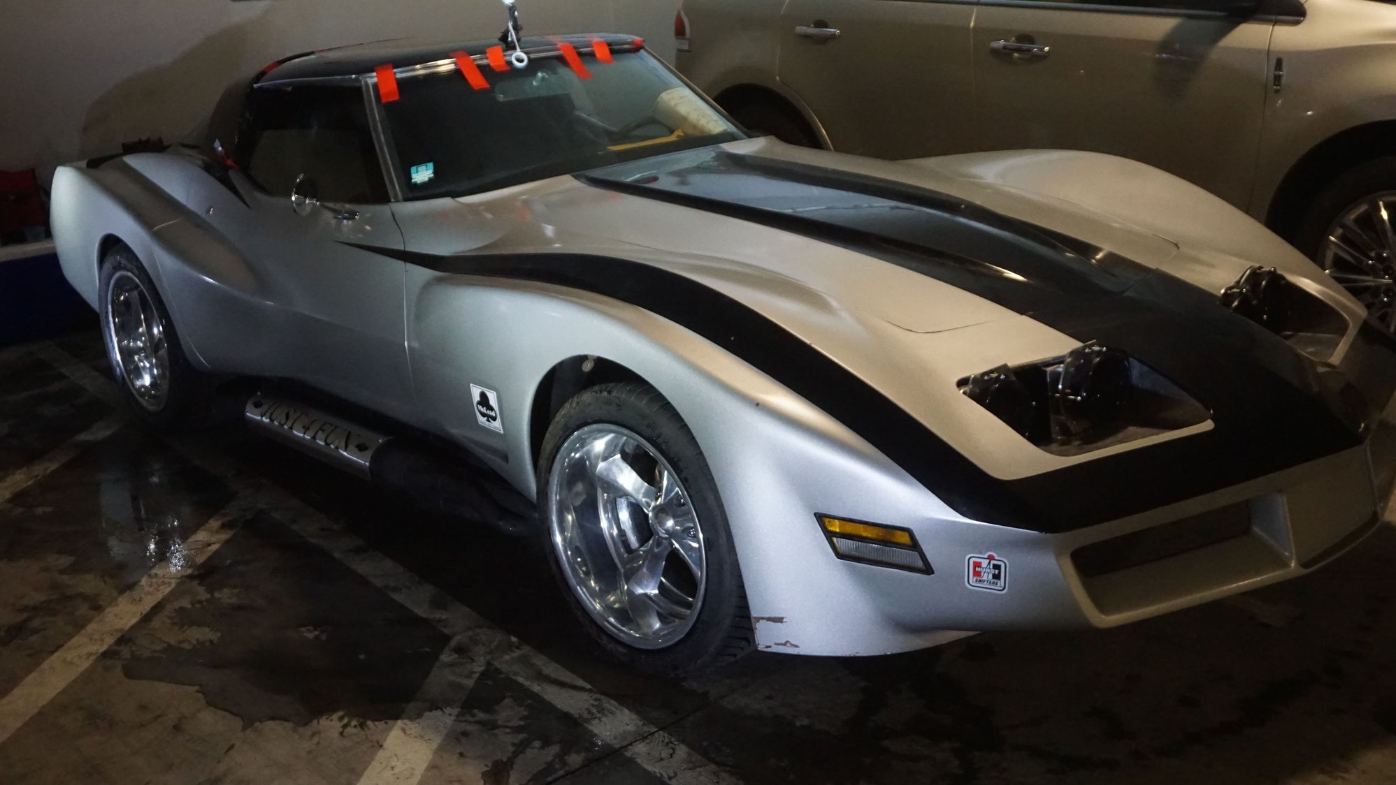

1968 Chevy Corvette L88 Replica. Heavily modified with an Ecklers Cam Am wide body kit fitted from Greenwood Corvette, frame off restored, custom 30G stainless fuel tank with baffles.
Windshield - Cracked , no wiper system yet, electric side windows, shaved door handles with some sort of popping device (not Installed).
Drivetrain: Dart 4-bolt main 415Cu block, Crane billet roller cam/rockers, Forged Eagle crank, Stef's aluminum oil pan, Bordix intake, Brodix heads, FAST EFI fuel system (not installed), Tremec 600 5-speed, Lakewood shield, McLeod dual clutch, U-Joints 1310, Driveshaft shortened 2”, 3.70 rear end gears.
Suspension: Borgensen steering, tubular control arms (Tie rods not tightened down, wheels out of alignment during transport)
Cooling: Be Cool radiator, Fans (tbd)
Brakes: Hydro boost brake Sys (not working), Willwood calipers (not working), Boyd wheels
Interior: some present (not installed), Inteletronix Gauges (not installed), Vintage Air (not installed), and Ron Francis Wiring Harness (not installed).
Lighting: L88 Style headlights (1/2 installed).

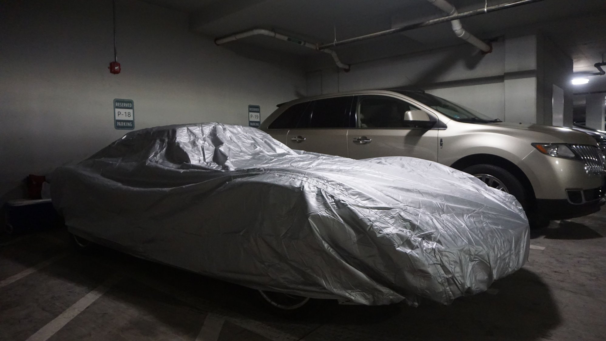

it in here parking spot for now.

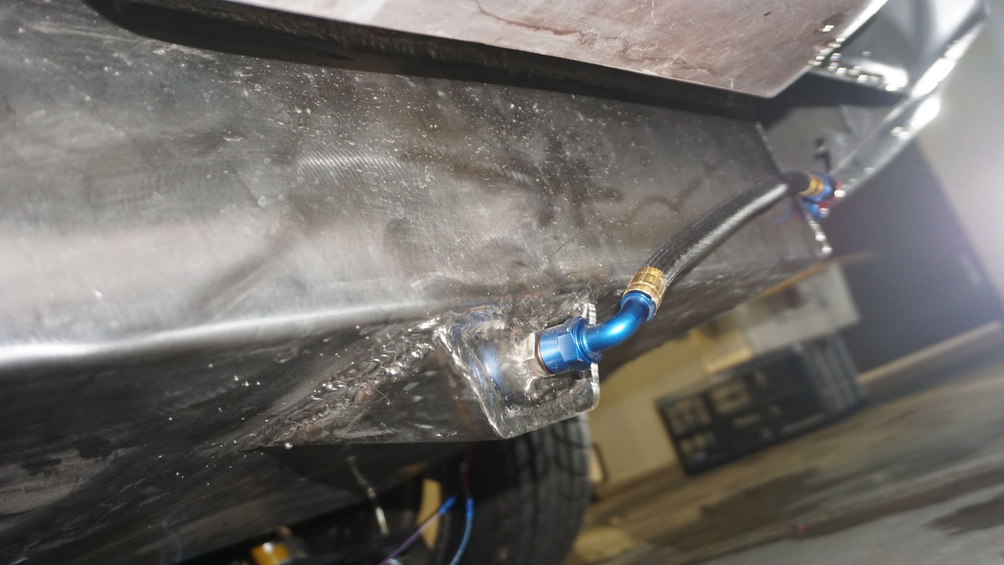

I'm very interested in how the motor runs and sounds. It was my last 3.875 stroker that I had laying around. Do you have the cam card? I'm pretty sure that I put a billet XEHR comp cams in it.

Can you provide more info on gas tank?
Sagebrushrebel here on the forum was a most excellent race car fabricator from many years of circle track stock car racing and later on Dwarf car racing. so the stainless tank is just a stock car tank made with internal baffles. You can buy them.

I just talked to him and he made the 30 gallon SS tank

I would love to see some pics of the gas tank myself. Good luck with this. Keep posting pics so we can enjoy the show...

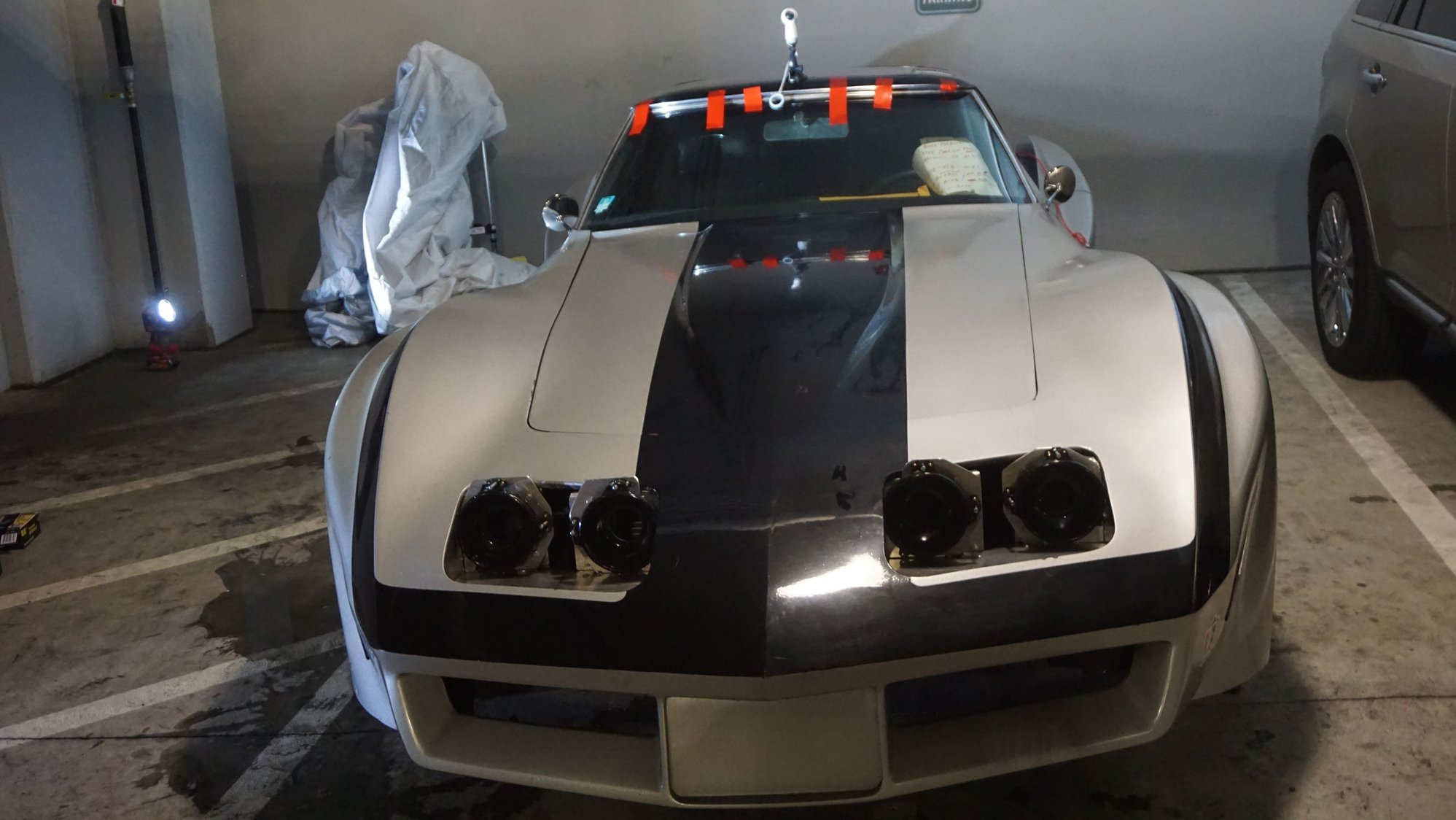

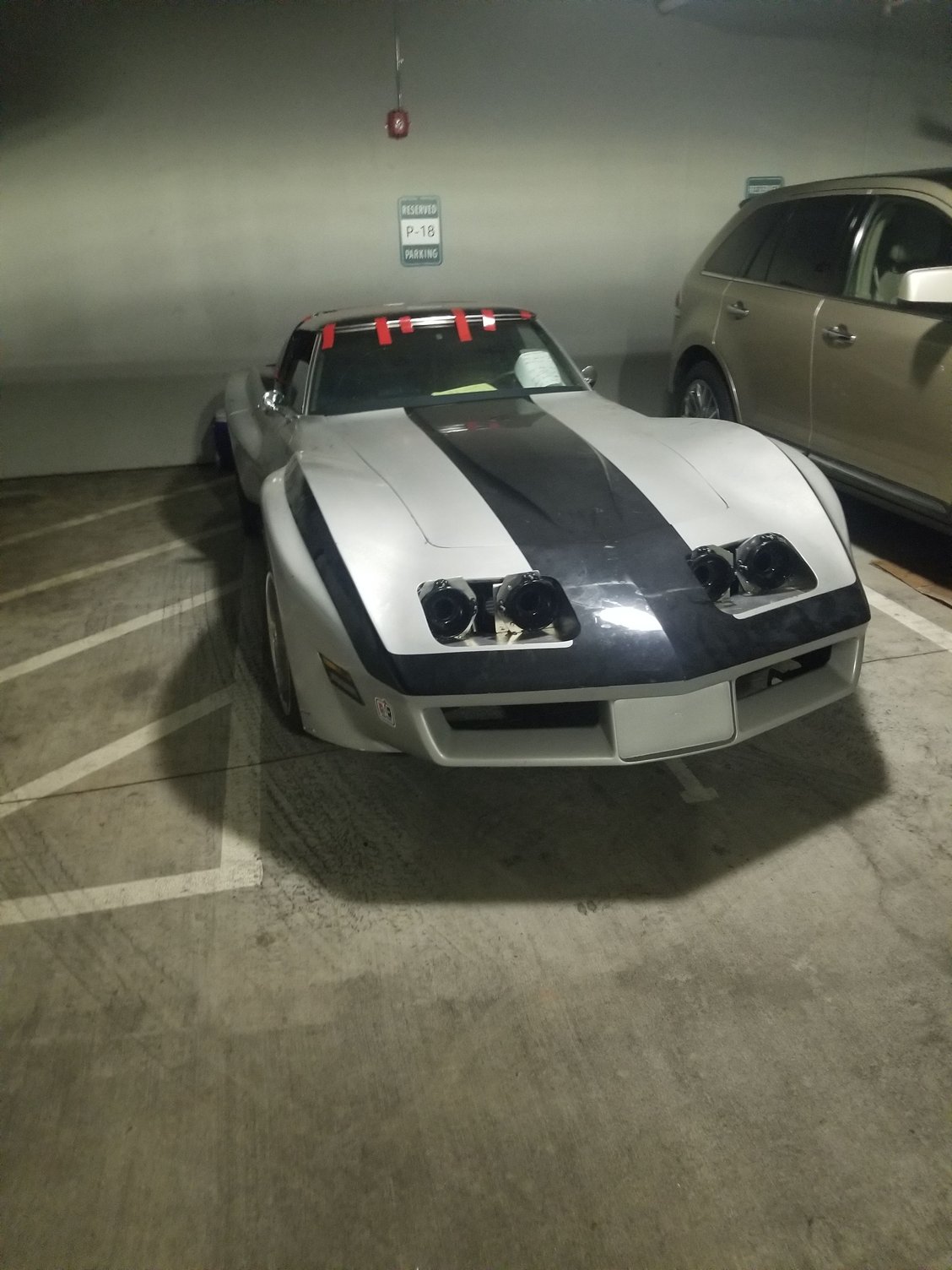

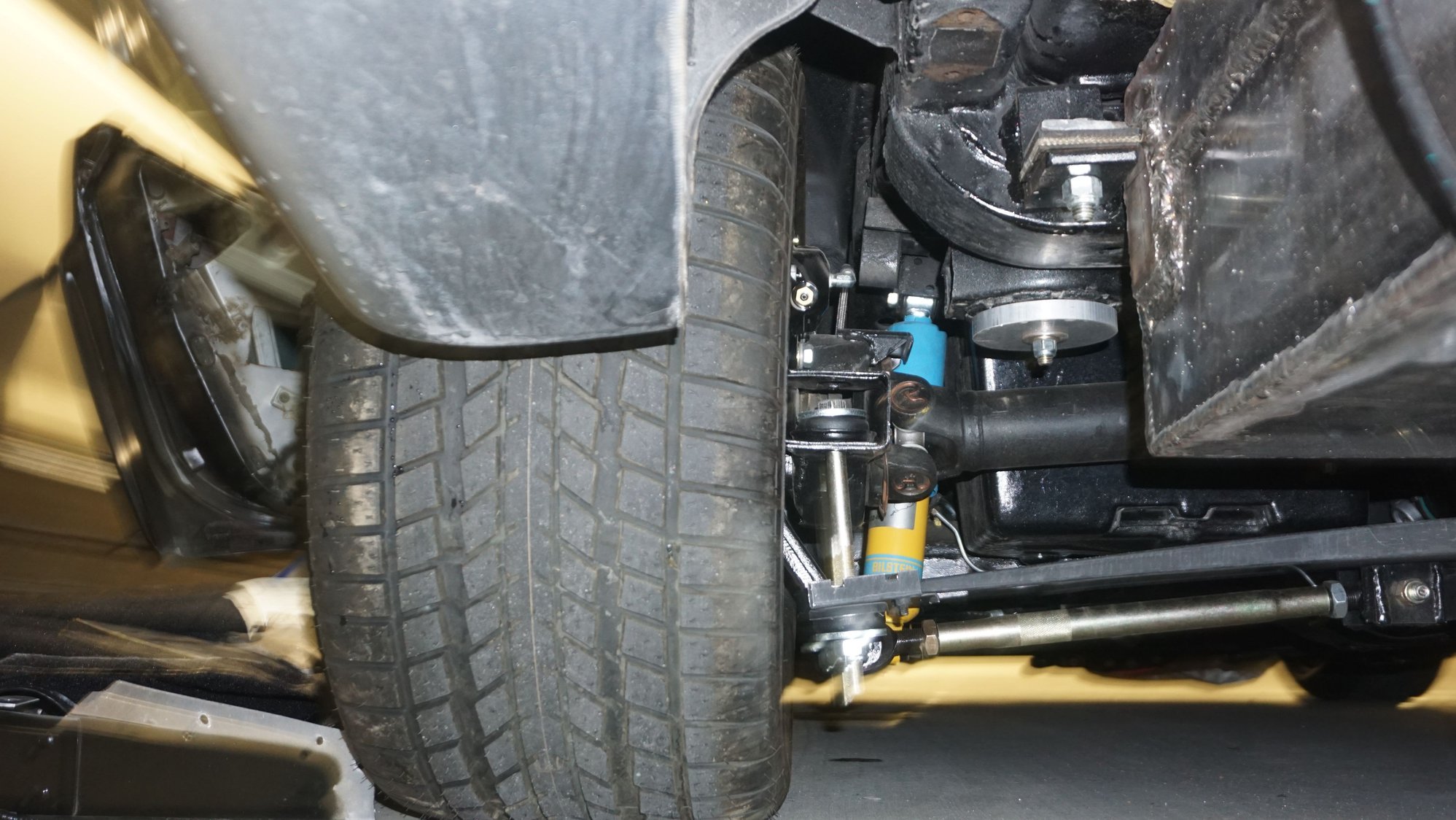

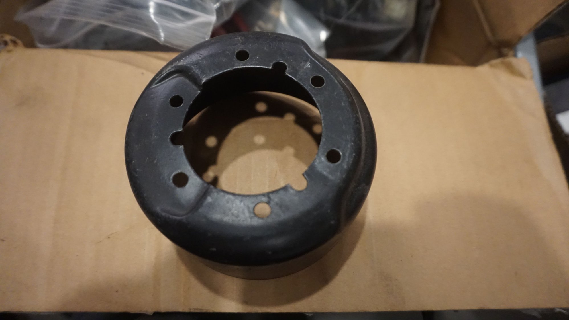

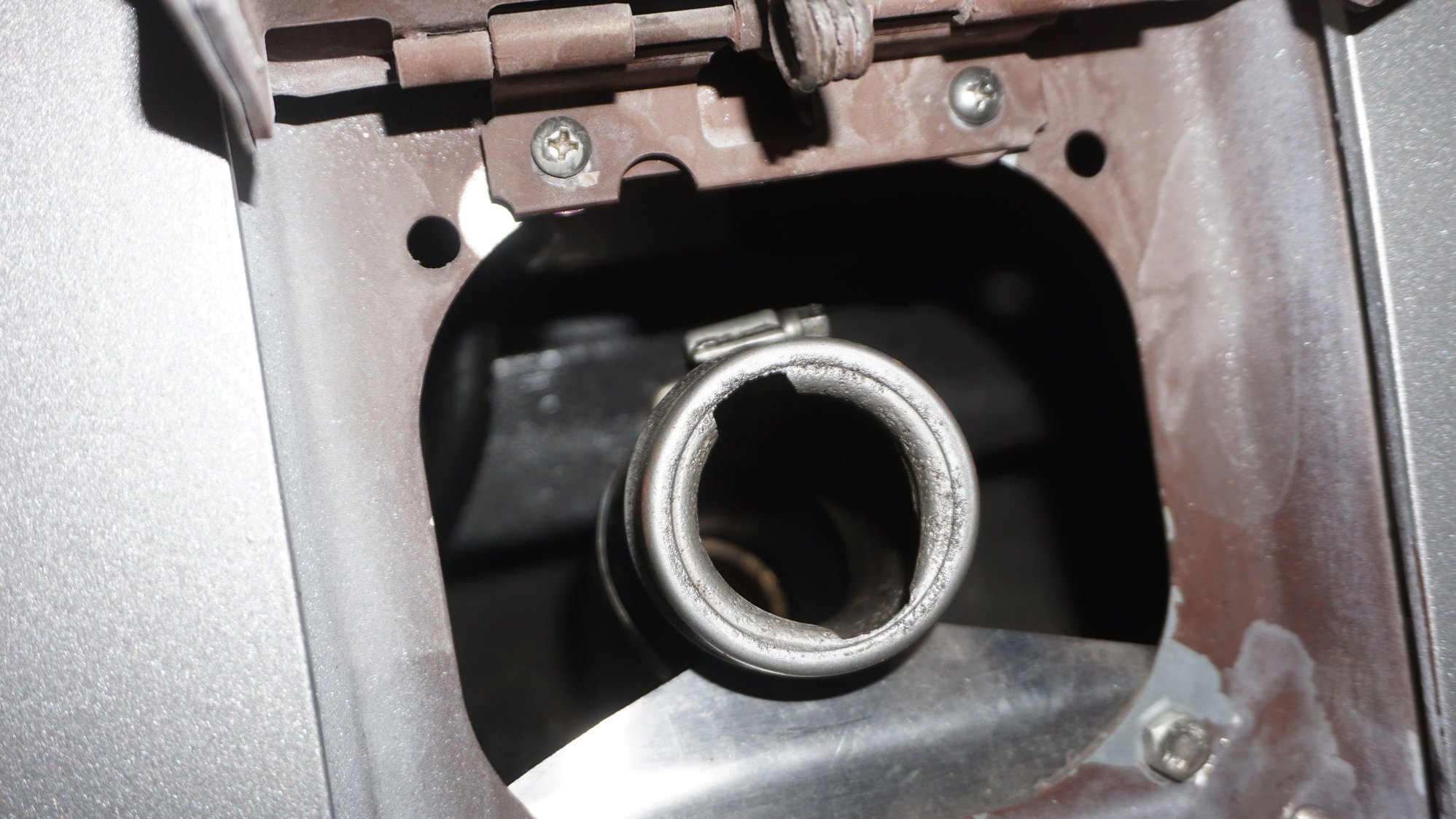

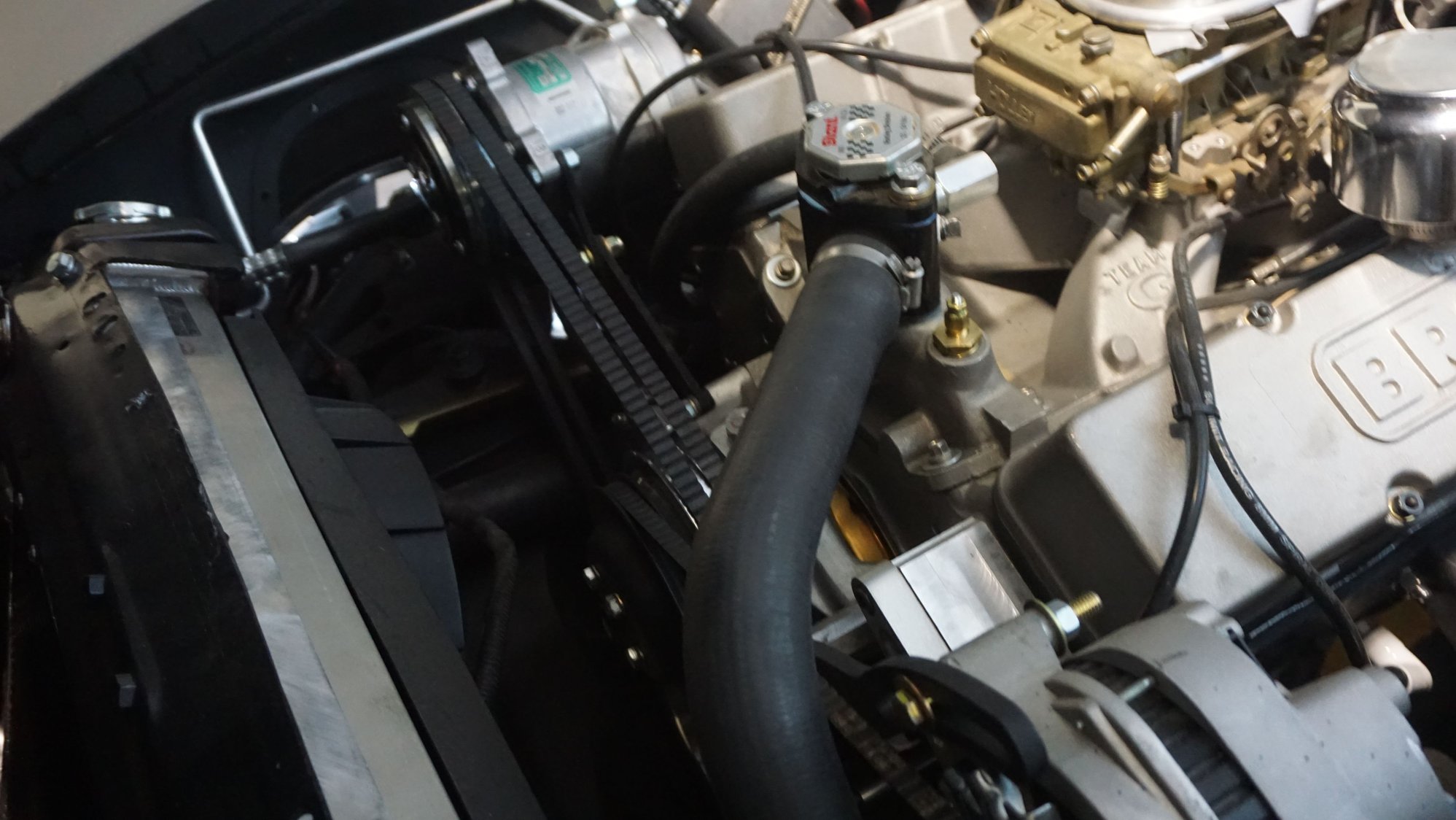

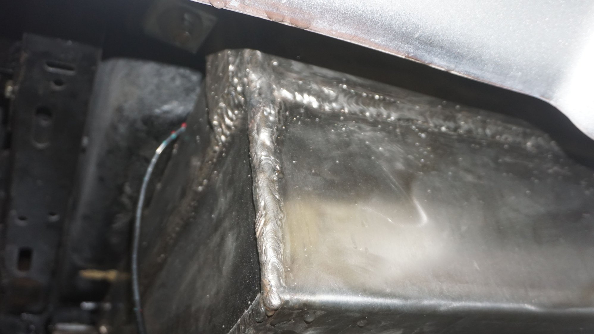

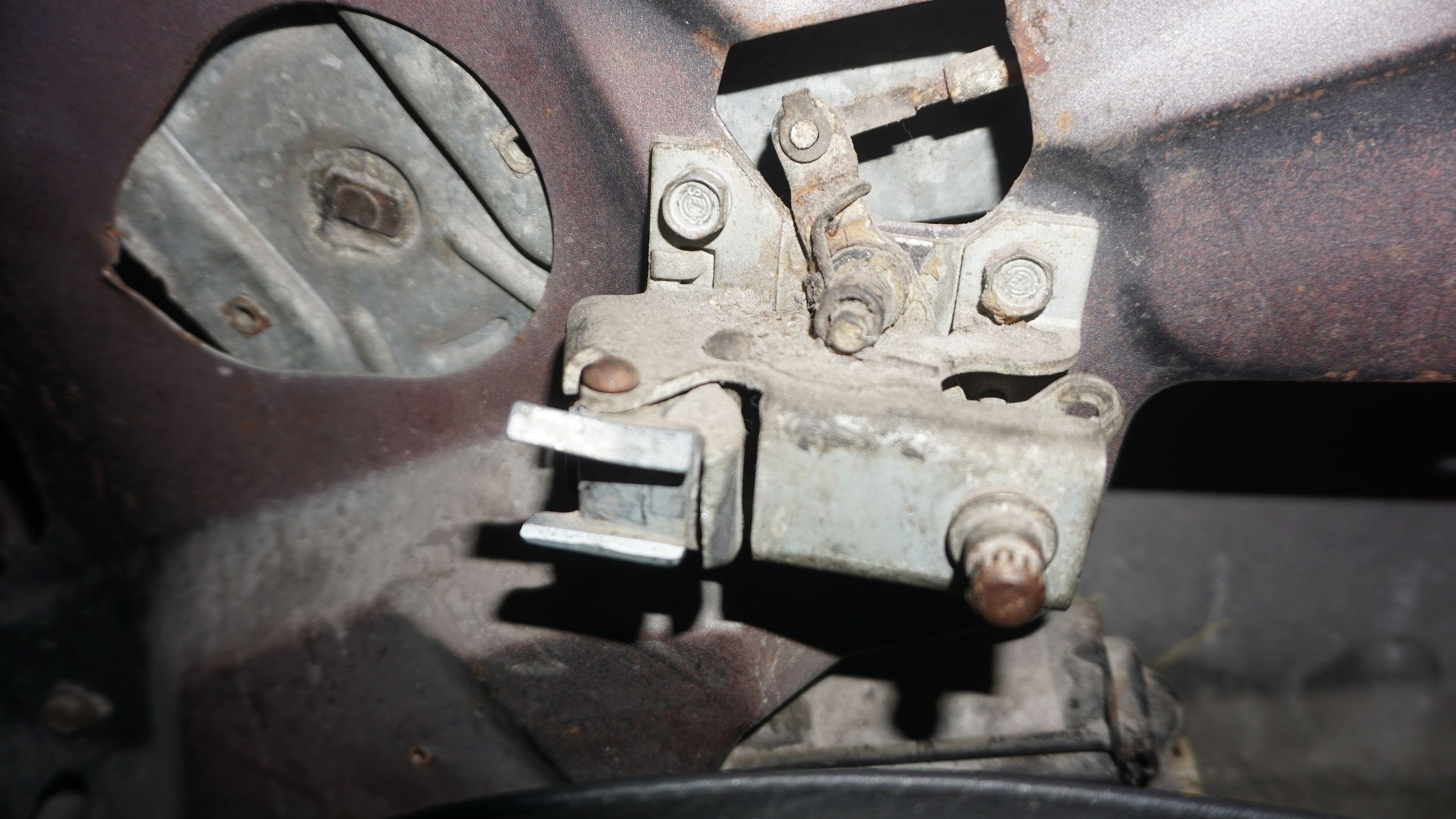

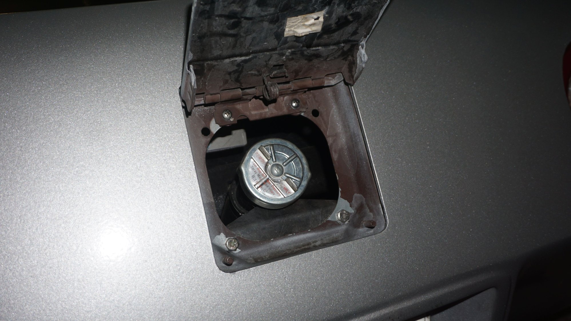

Aloha all,

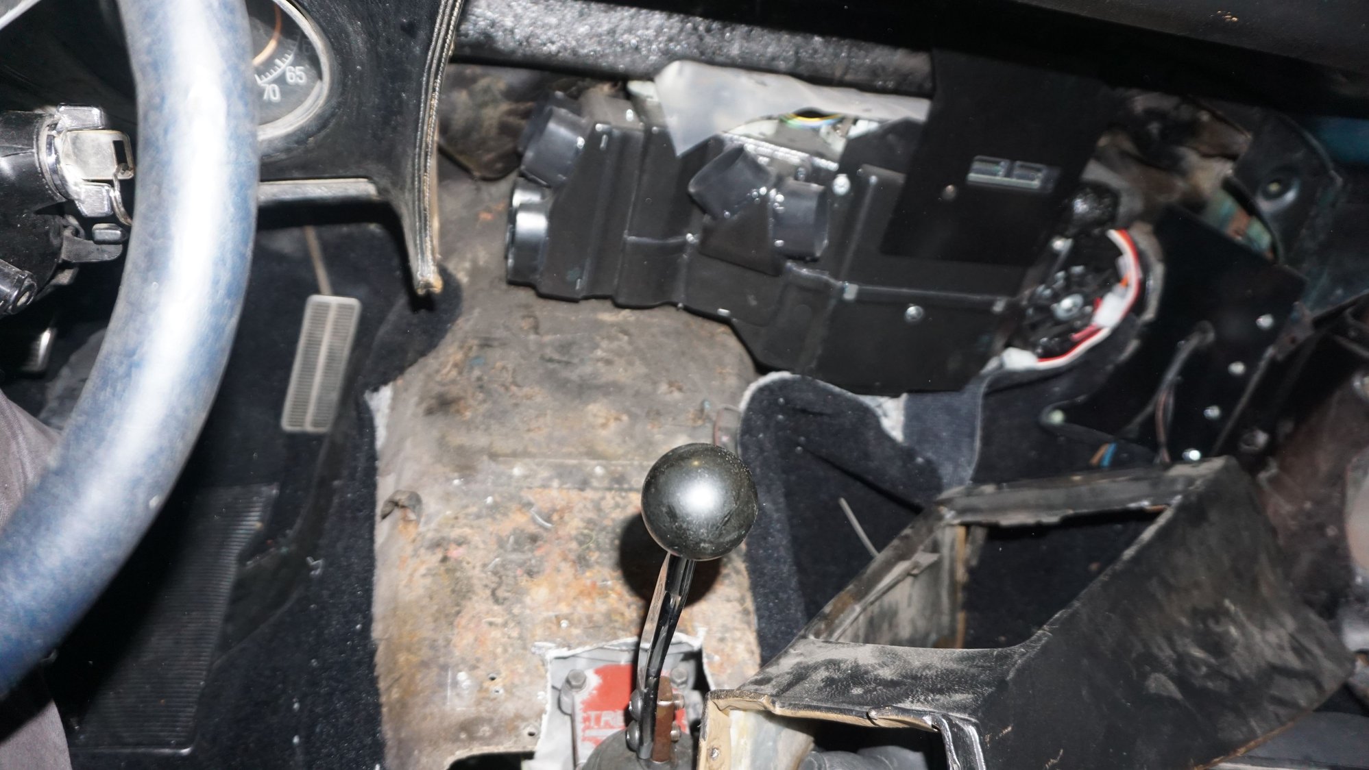

Last night was the first night I could get in the car. I got all the pieces out and started sorting them. Here is what I have so far and there is still a long way to go. Tonight I plan on starting laying Noico matting and maybe figure out some of the wiring. I think all the wiring should be incased split wire loom, heat shrank, then wrapped in Tesa tape (at least in the engine bay). This is going to be a long process, and will need the community to figure out some things as I have boxes of pieces that I don't recognize or know where they fit. here are a few pictures, including a few of the bottom of the fuel tank. Should I start a new thread on the matting and keep different sections separate or just keep this thread going longer and longer? thought rules, thanks. Time to wash/wipe down the interior and get ready for matting.
Ron Francis Wiring
Engine Bay
Engine Front
Driver interior

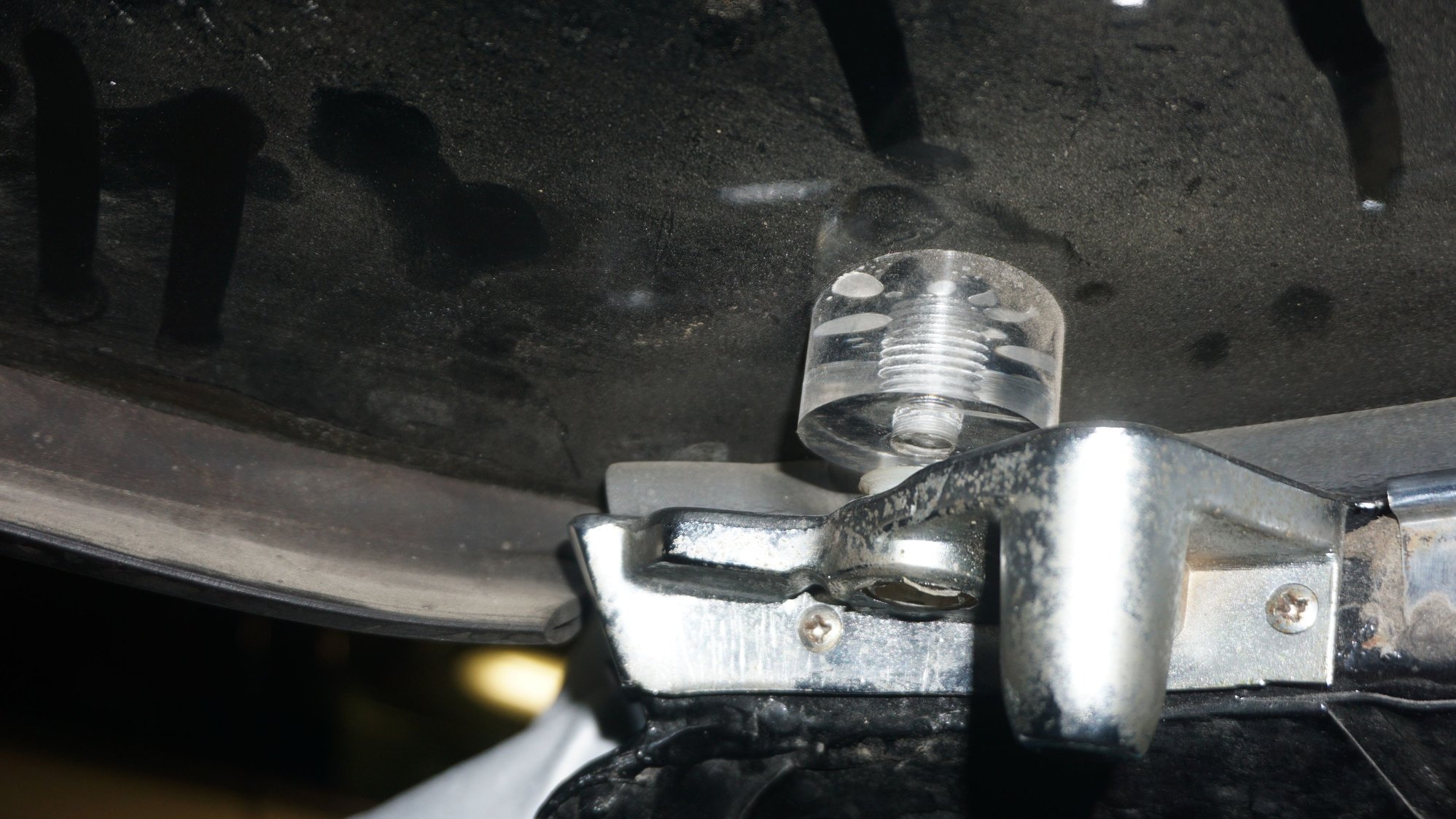

Poly one piece top no bolts, anybody have ideas, maybe something with easy turn handles

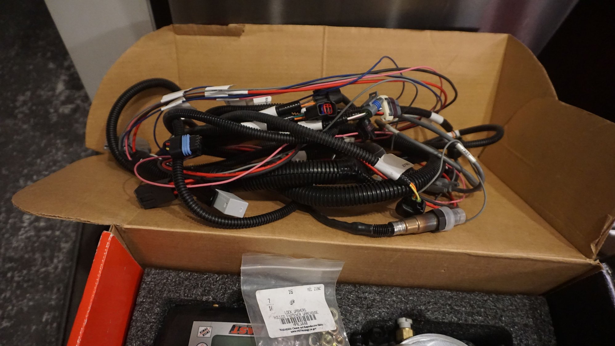

FAST EFI

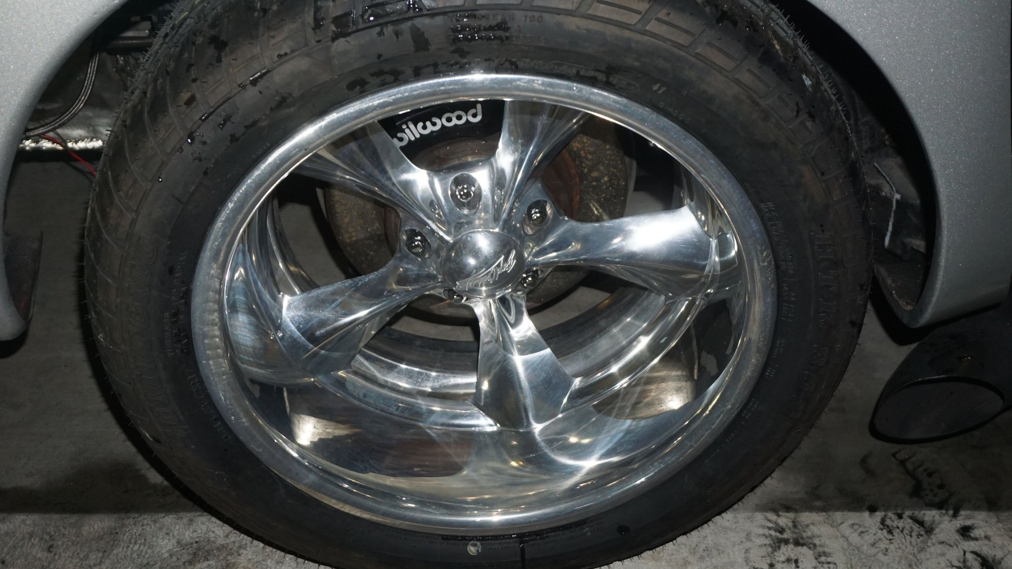

Rims and tires
Fuel tank back, I may need to make a fiberglass rear skirt to cover?

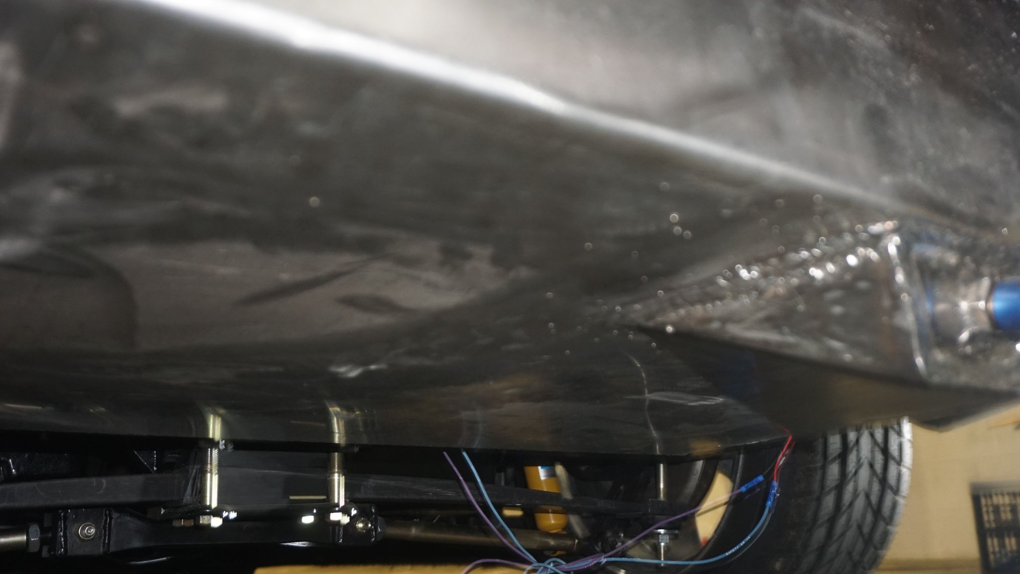

fuel tank driver side and rear suspension
bottom fuel tank
side fuel tank welds
rear vehicle and fuel tank filler
Fuel tank filler

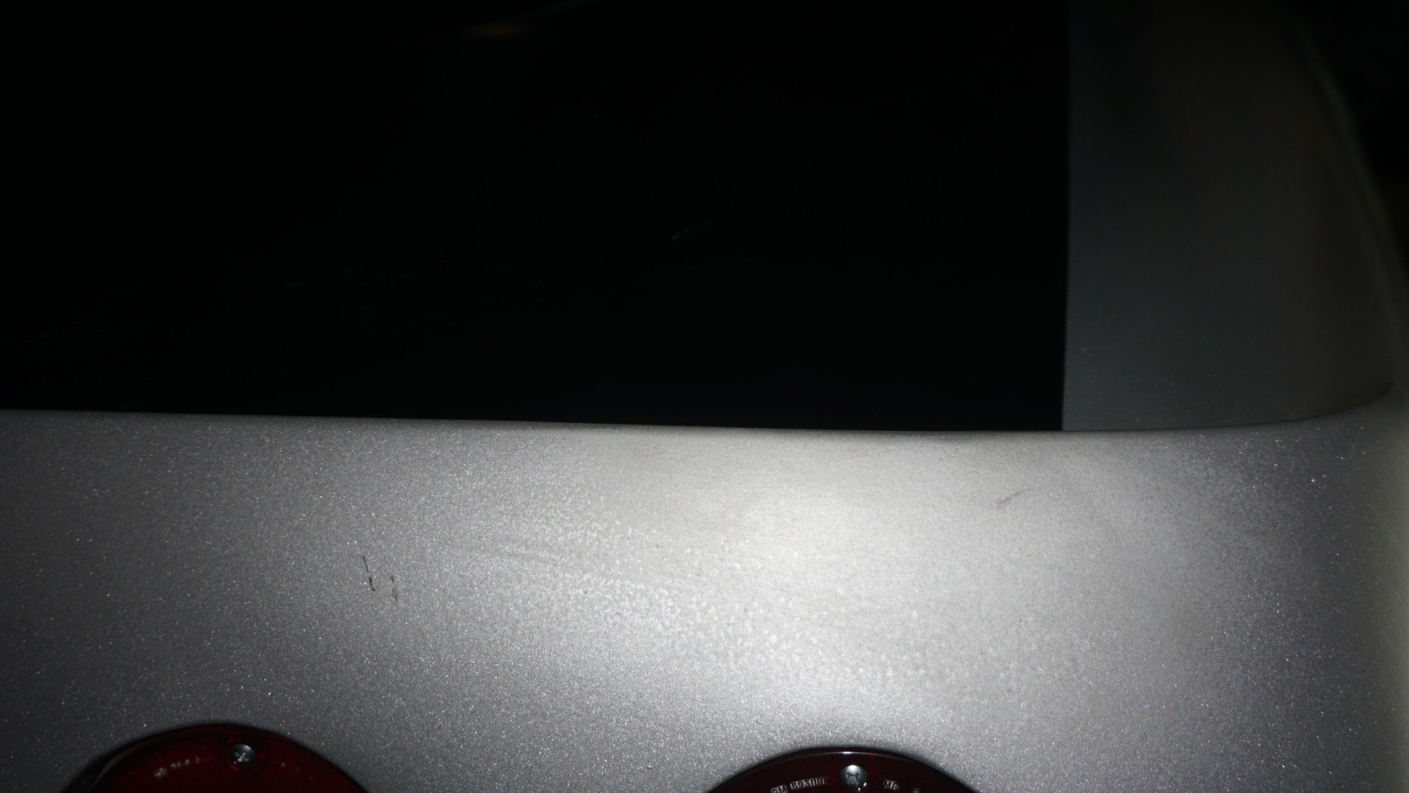

Just noticing Transport damage
Just noticing Transport damage 2
?? part of the steering wheel, anyone wanna help me out

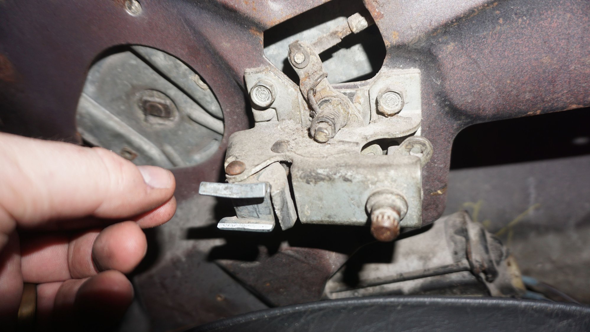

Passenger side door latch, tabs broken, will need a new one
Passenger side door latch, tabs broken, will need a new one 2
center console
FAST EFI
FAST EFI 2
Ron Francis 2
Parts

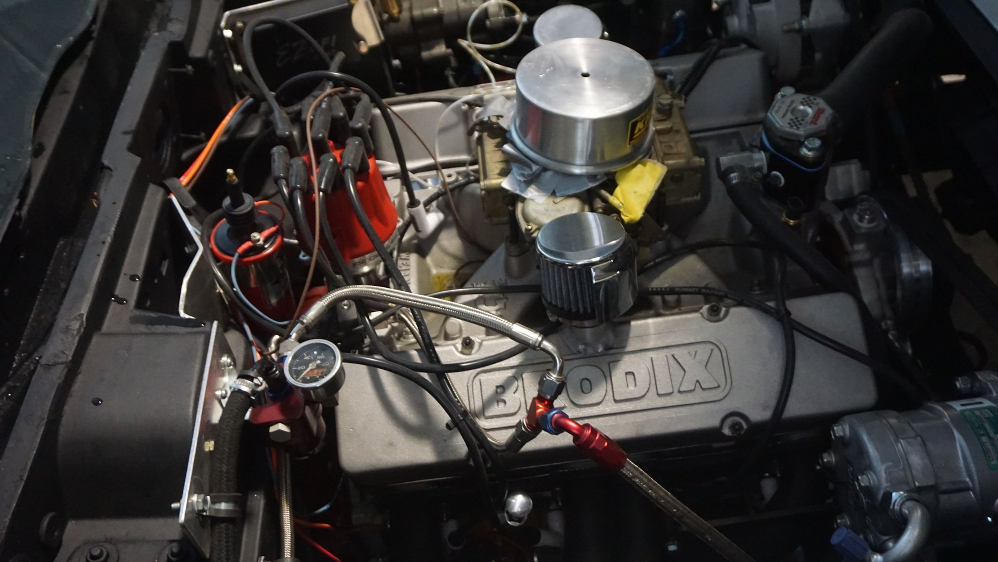

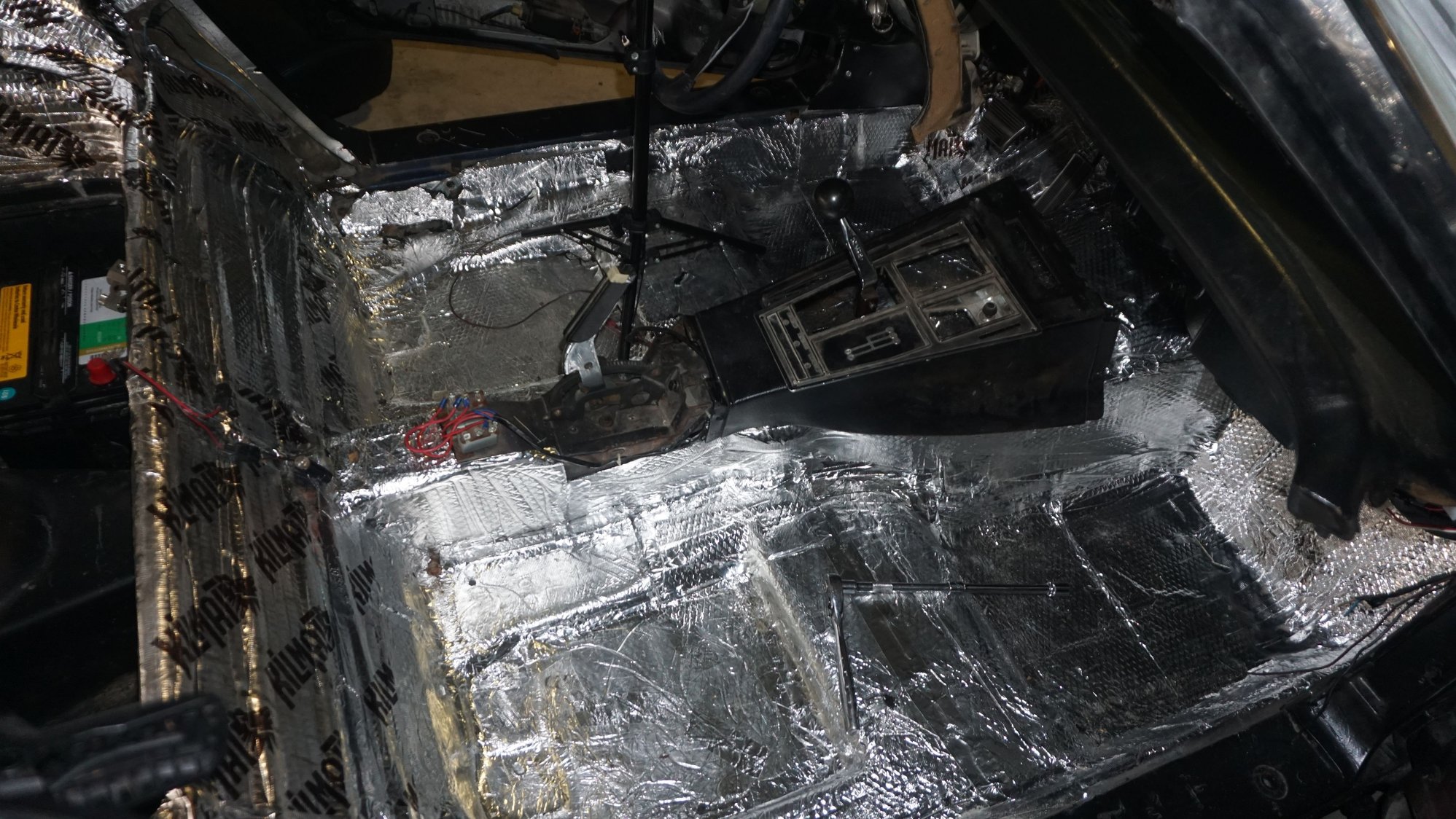

Update 18-20 July, (my weekend) I put down matting, and put in 1/2 of the FAST EFI System. I originally only got 36yds of Noico Matting and some aluminum tape, I got from the firewall to just past the seat and ran out, When I went to order more it couldn't get here till Aug. So, I decided to get another 36yds of Kill Mat as I could get it the next day. I also ordered some LED headlights, they should be here in a few days. Next Ill have to figure out and order some tail lights as I have no sockets.
Tonight I got some Tesa tape and wrapped the FAST EFI harness, installed the carb, lines, and routed the wires to the interior of the car, as I think the original mount in the engine bay may get too hot. Next few days I'll make a plan to run the Ron Francis Express wiring, MSD ignition box, and headlights.
Does anyone around Northern Virginia or Maryland know of a Junk year or C3 part cars. I need to source a few automotive style bolts, hood latches, and I'm sure I'll find more as I put this back together.
Back Section Kill Mat
Front Section Noico Mat
Back Section
FAST EFI mounted, still need to clean up Spark Plug wires.
FAST EFI mounted and ran
Engine with the Holley Carb

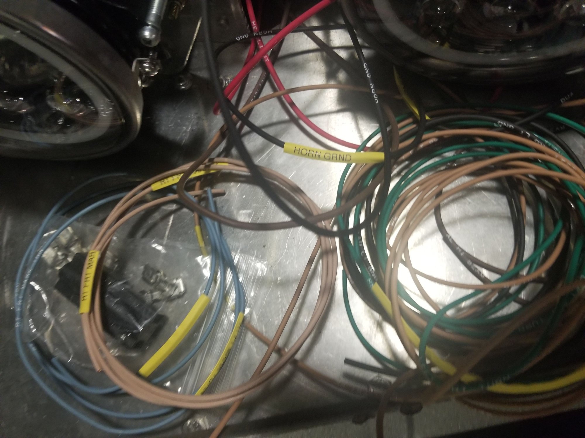

So far I have been laying out the wiring harness, I heat shrink labels on both sides of the cable to indicate what they are, started running then through the car.
Then I plan to tape it with High Temperature Heat Resistant Polyimide Tape every 3" or so, ensuring they all works properly. (lights, signals, etc)
Then, remove the harness re-tape with Tesa Tape, before reinstalling an hooking up the connectors.

Its been a good weekend, I appreciate all the good vibes and messages on this project, I printed heat shrink labels for all the wires, ordered and started putting in the New LED headlights, started putting quick connectors on the Inteletronix gauges and routing the wires through the car. Once I have all the wires in place Ill do a soft electrical test, then start wrapping them up. Its a slow process but I would rather do it slow and correctly than doing it twice.
I've been reading about people who put Reflect (HVAC shielding) over the matting and under the carpet to help keep the interior cooler. It doesn't seem too expensive a roll is less than $30 at Lowes and the aluminum tape is under $10 a roll. Anybody actually did this? is it worth it with side pipes?
Next days off, I plan to put GM connectors on the fan controller, obtain a horn and hook it up, and keep chugging along. I'll keep ya'll posted on updates.

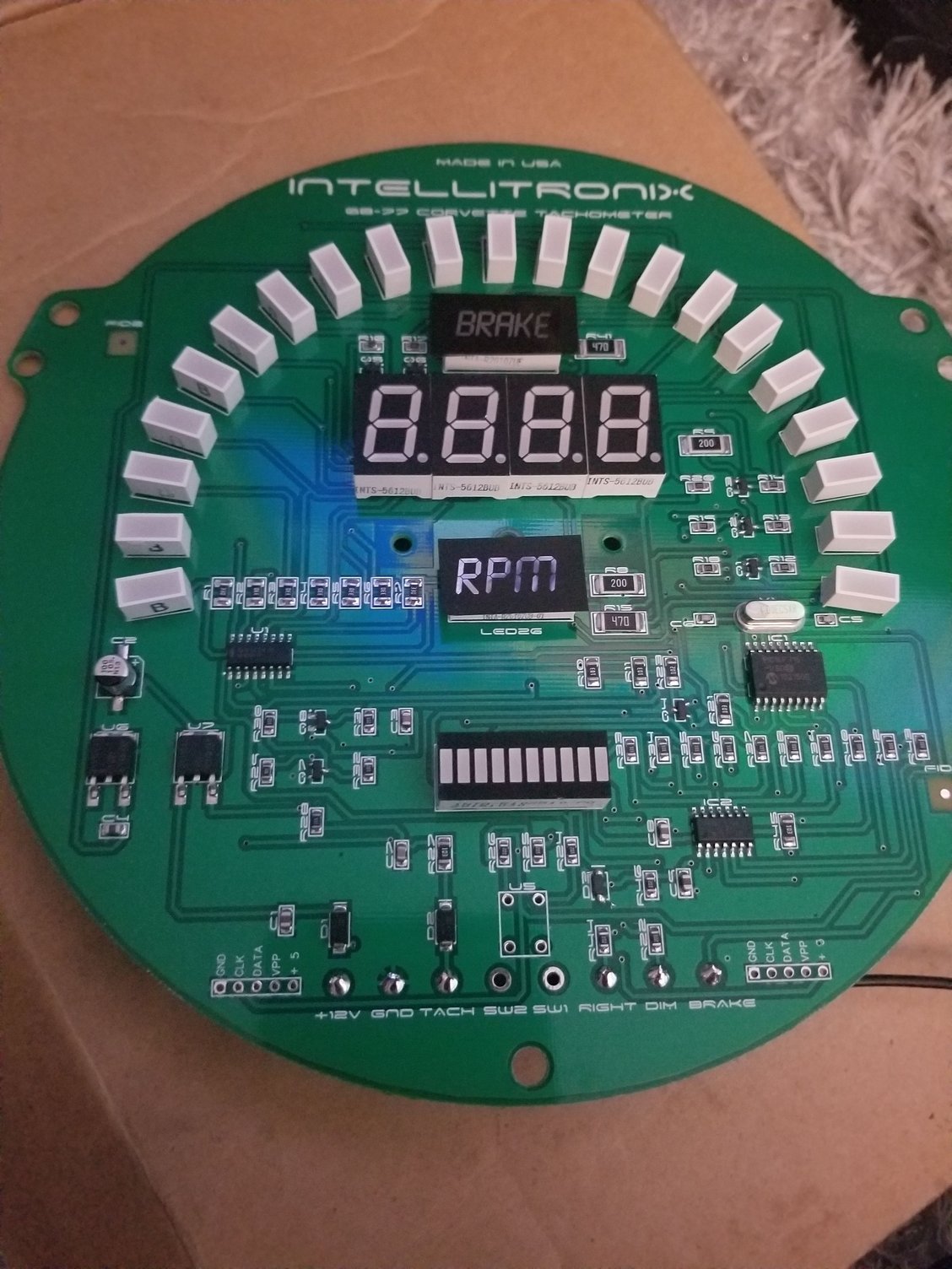

Inteletronix Gauge
Wires with Heat Shrink labels (used a brother P-Touch label maker)

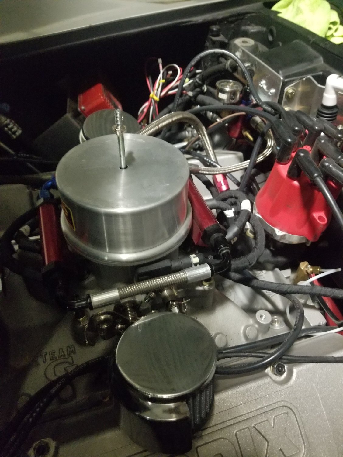

Its been slow since my wife returned but I did get a little done this last weekend. Since the Vette is mostly fiberglass, I decided to place a mesh network of grounding points that connect not only the grounding blocks but back to the frame as well. I have the front headlights, turn signals connectors, marking light connectors, fans, all wired up and in conduit back to the firewall. I need to get a power source and test each system before I Tesa tape the conduit and secure them to the firewall.
I also relocated the EFI brain

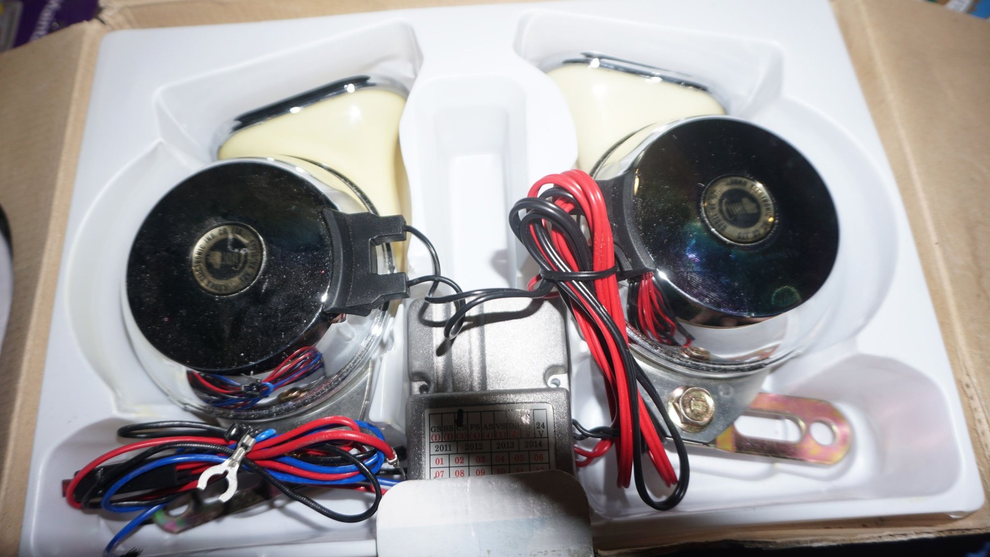

Nice 2" hole punched right in the blower cover
My new Korean Taxi Horn, straight from Korea last week.

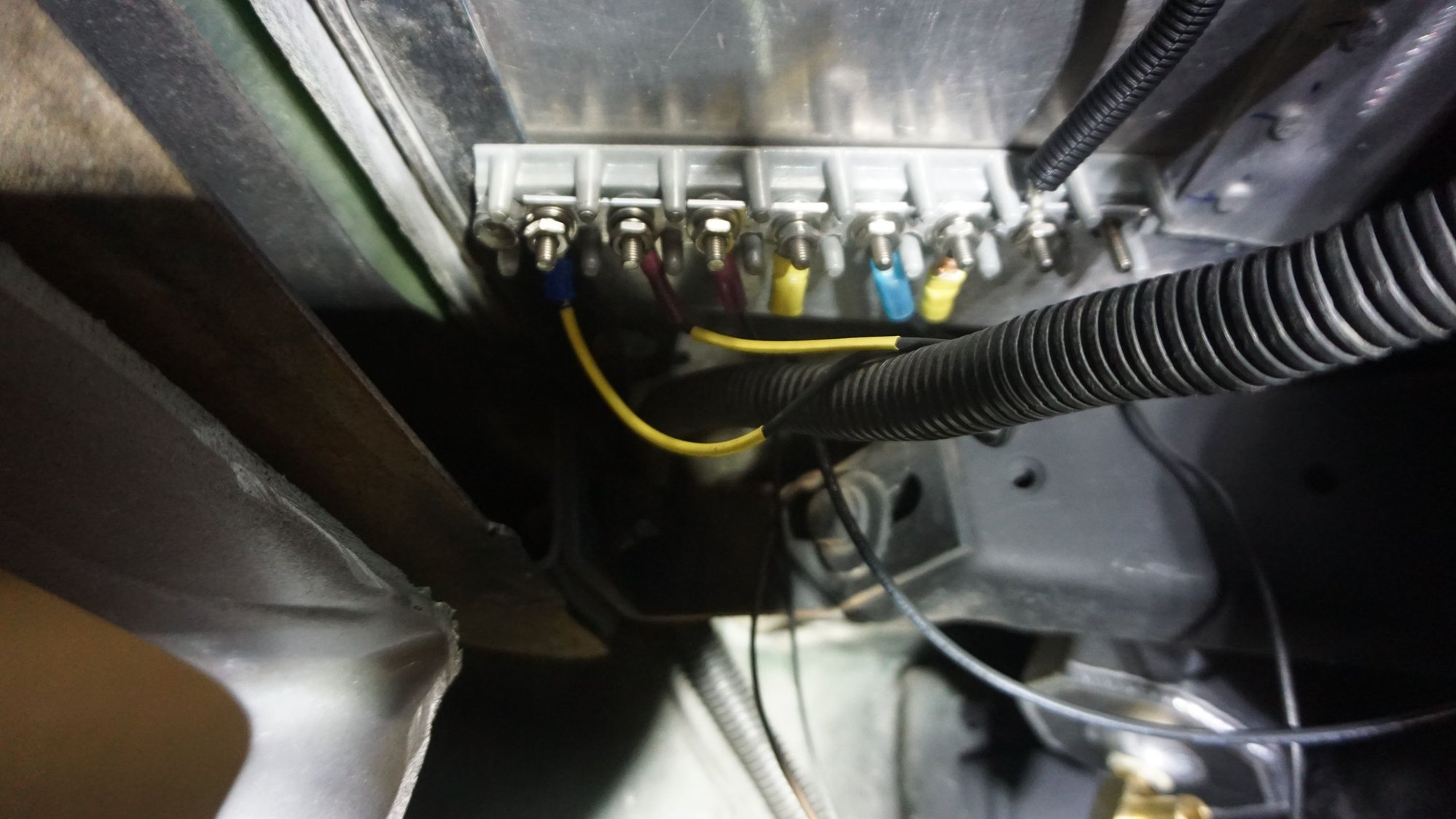

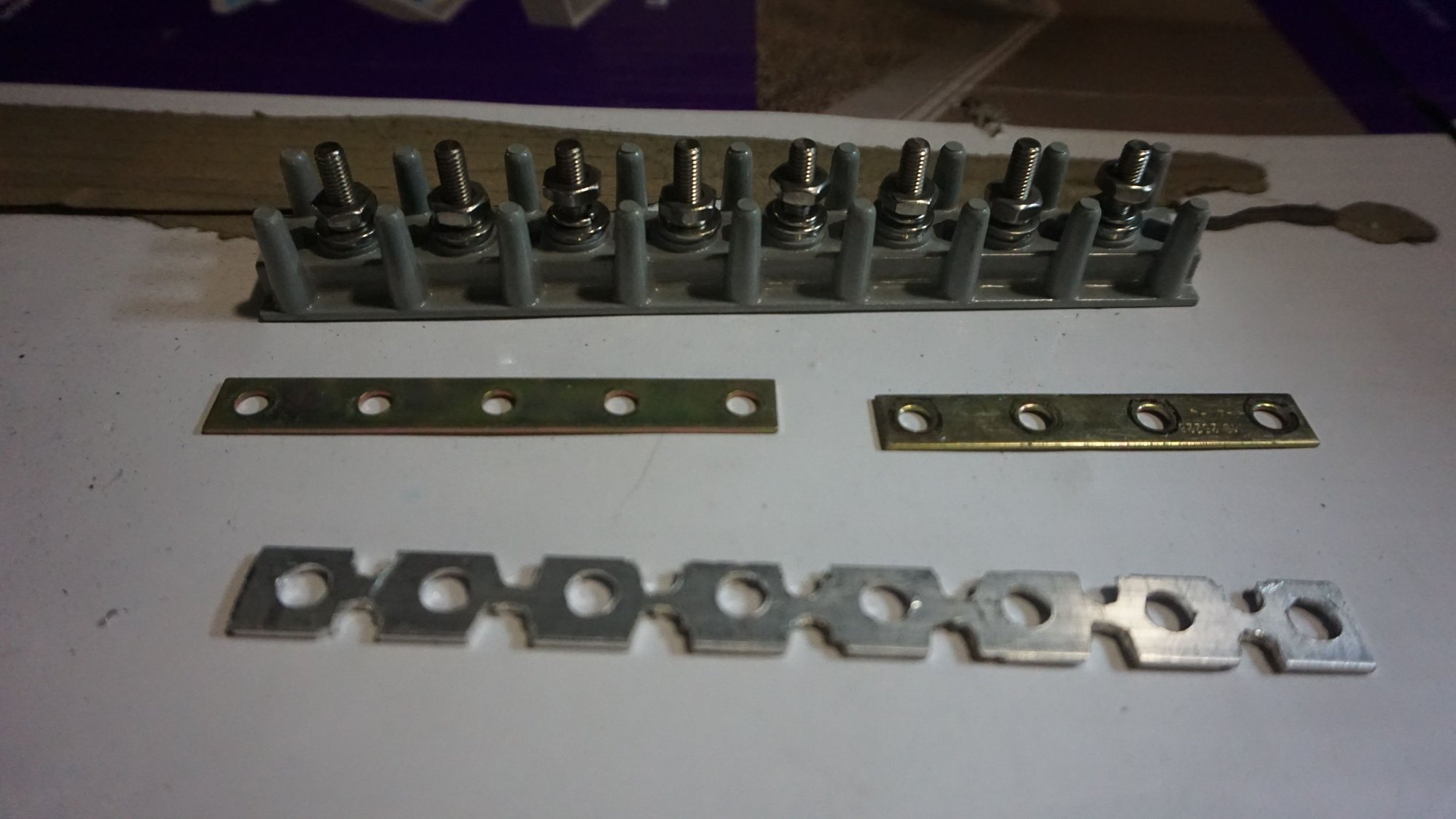

The grounding blocks I found to use, then used some aluminum to drill out a longer connecting rod.
Front grounding blocks mounted under the headlights. (I should have thought about mounting them at a different angle, as its difficult to put the washers and nuts on upside down.

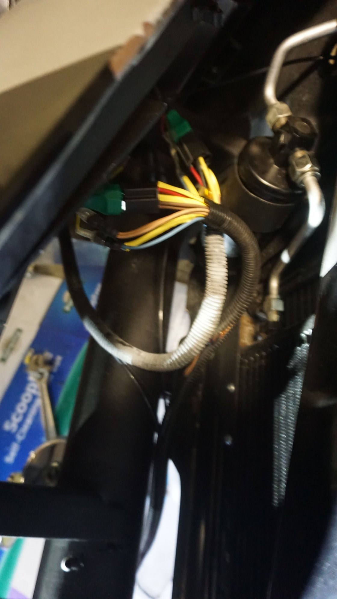

headlight harness in conduit awaiting testing/tesa tape
to the inside of the vehicle as I have read that the excess heat and vibration from the engine can effect the FAST system. Luckily I had access to a Green Lee hydraulic knockout , which punched a hole through the blower motor cover like butter.
I didn't have a horn, so my cousin bought me a Korean Taxi horn for my Birthday. Which, I think will be hilarious as they make a loud bong sound that wavers as it fades out (BOOboonboonng.....).
