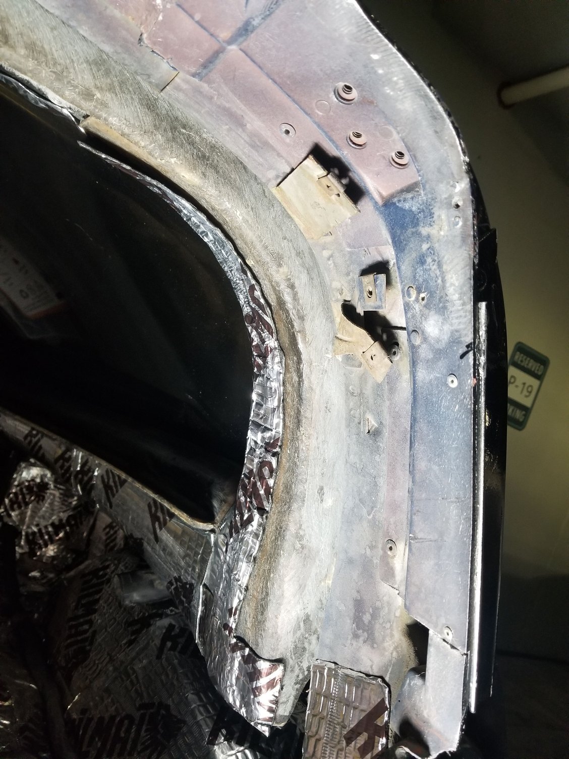

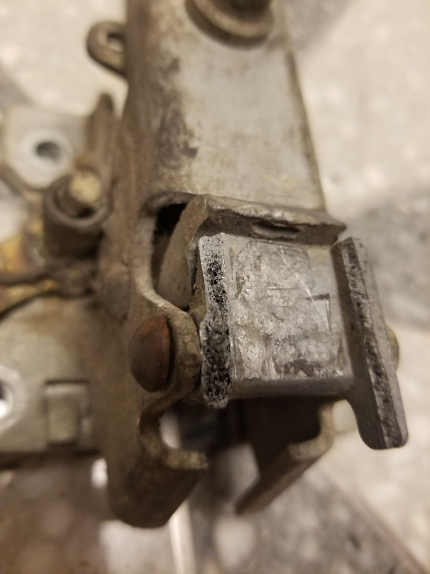

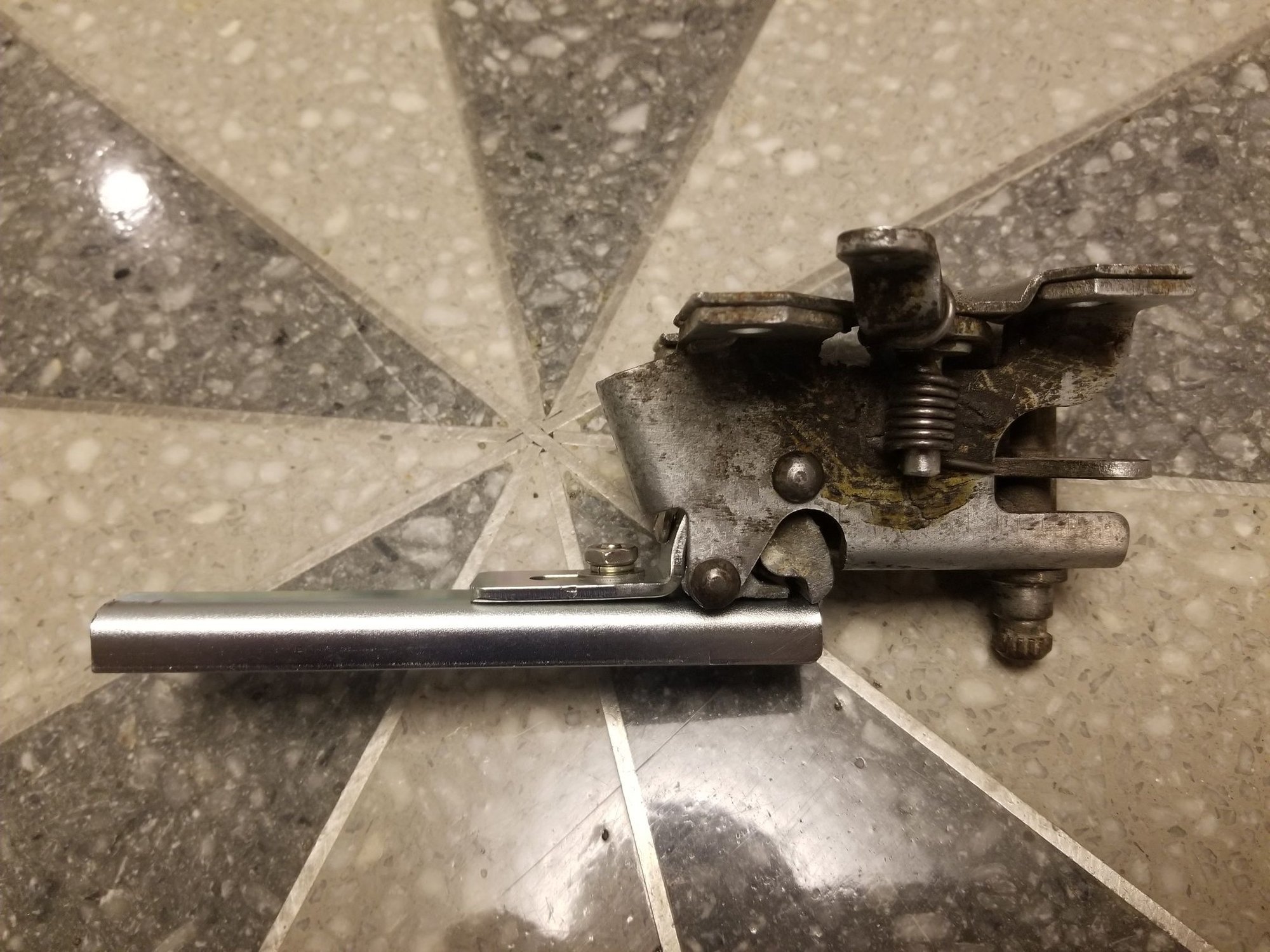

Tonight I decided to fix (Temporarily) the passenger side interior door handle. With no outer handle it was a pain trying to find the wire to pull the handle opening the passenger door.
This is a temp fix, goal is to get the car together and running then make it pretty.
Noticed there is a threaded hole under the handle, which I could put a screw in. Then, drilled a hole in the center of where the handle should be, from here it was just some junk metal to make the connections. It's not pretty, but it will work for now.
Original
Broken section
Repair
side repair
Repair front

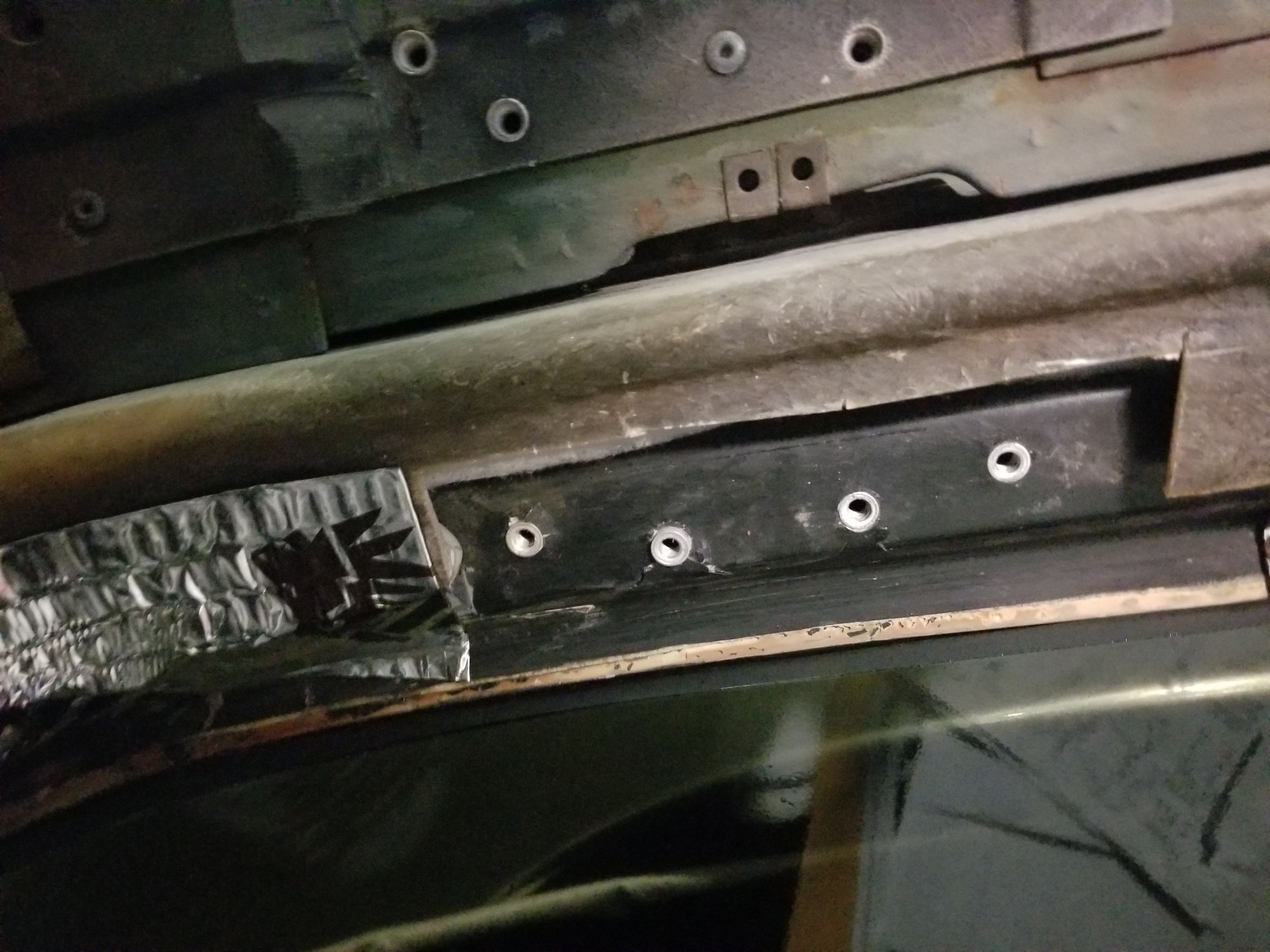

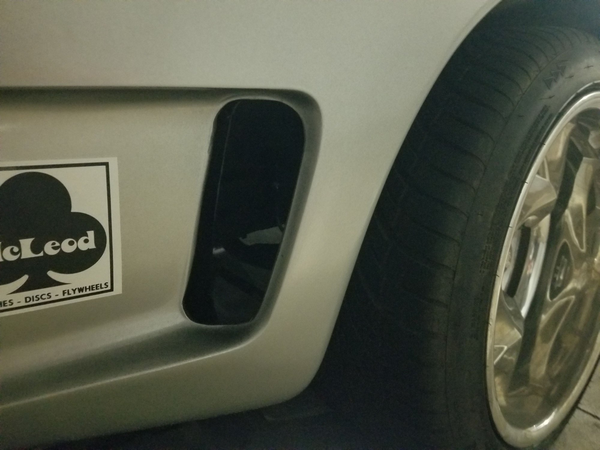

Aloha all, hope everyone had a wonderful Thanksgiving. things have been moving slow but are moving. I have most of the dash in (pictures tomorrow), new hood hold down latches, sun visors and almost all the wiring done just need to finish the wiper motor and waiting for a backup light on order.
here are a few pictures from last night, I have a few holes that I need to research and fill if anyone can shoot me a picture of the areas that I'm missing that would be great. Thanks.,
Karp
tonight I'll finish the dash and hopefully start bleeding the brakes.
Front grill area area missing pieces
Side cutouts are there grills for them? Or ill make some later
Hood latches not sure what goes here
area missing interior pieces
New hood hold down latch
Still need to get carb linkage as well
Old Dec 7, 2022 | 12:03 PM
BigBS's Avatar
BigBS
Joined: Oct 2022
Posts: 1,770
Likes: 293
From: Owens Cross Roads, AL
Have seen screens for those openings on eBay.

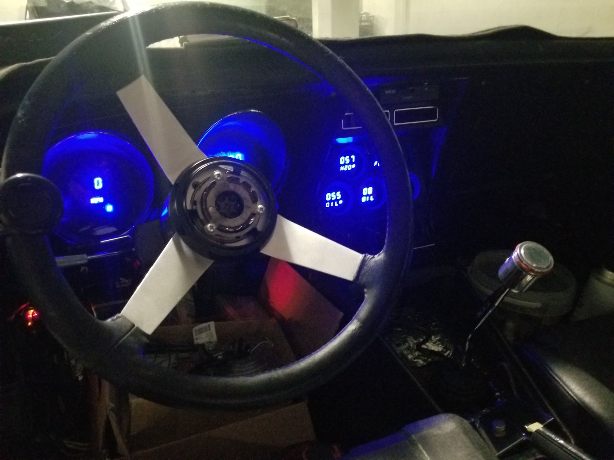

. My weekend is done, back to work.real.job tonight. Yet here is the latest status, I have power to gauges they seem functional, pass seat is in, and the power steering pump belt is on. Next weekend is definitely brake bleeding time.

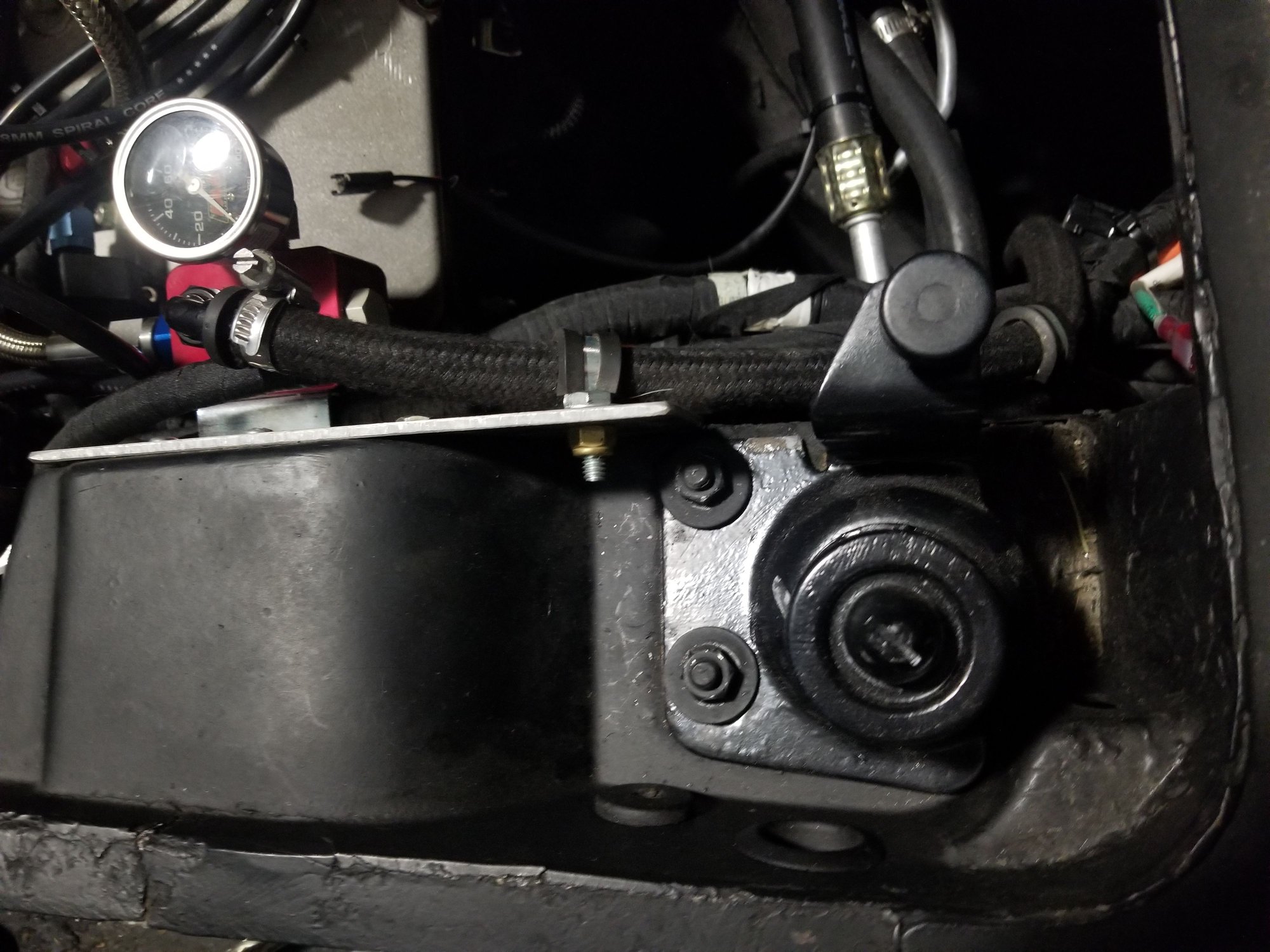

Freezing weather and the coldness are making the project go slower that expected. But found a leaking brass distribution block on the front brake, think I have it fixed so added a little fluid and placed some paper towels around the leaking area . I will be checking it every other day till i get off work next week.

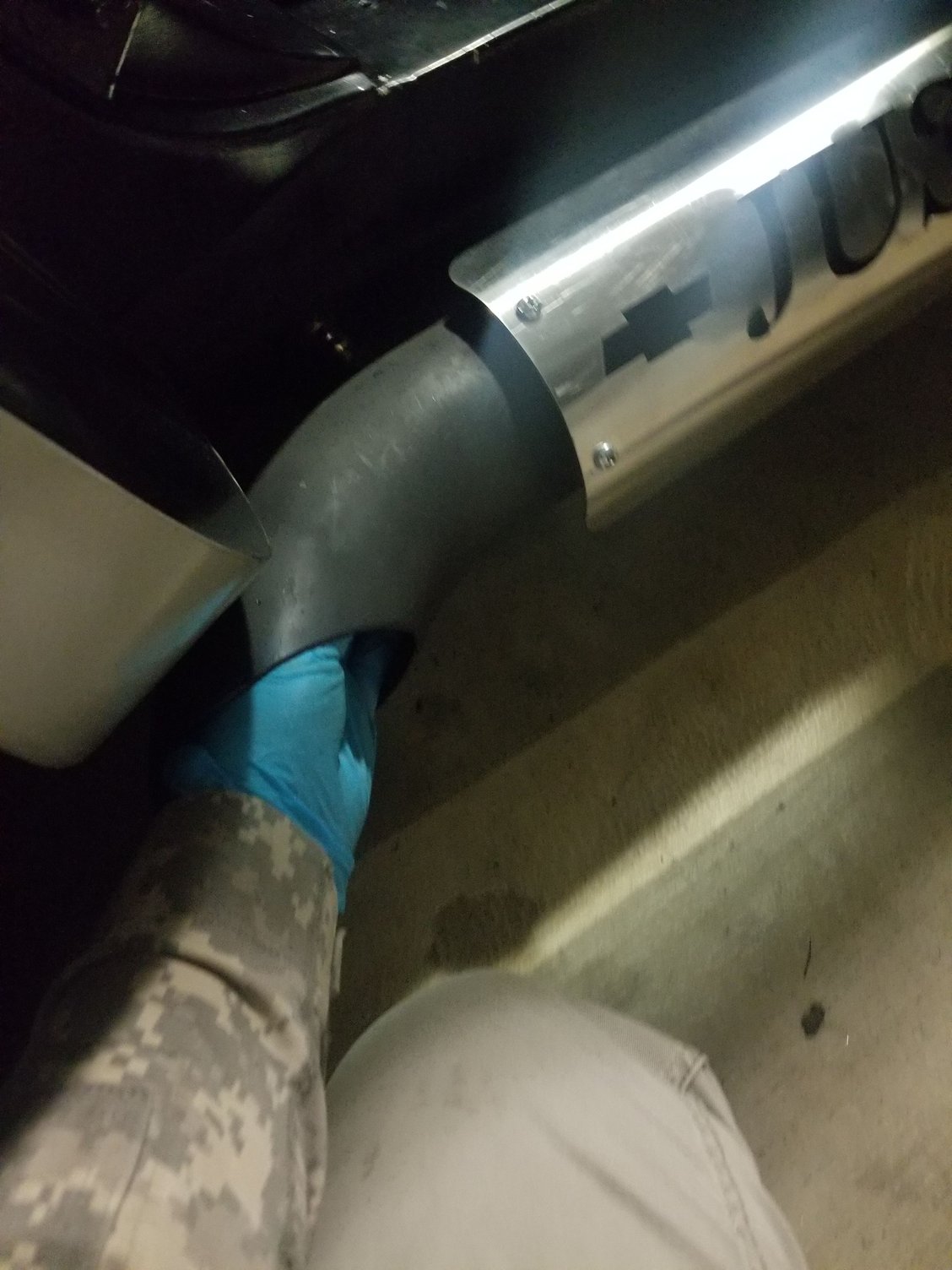

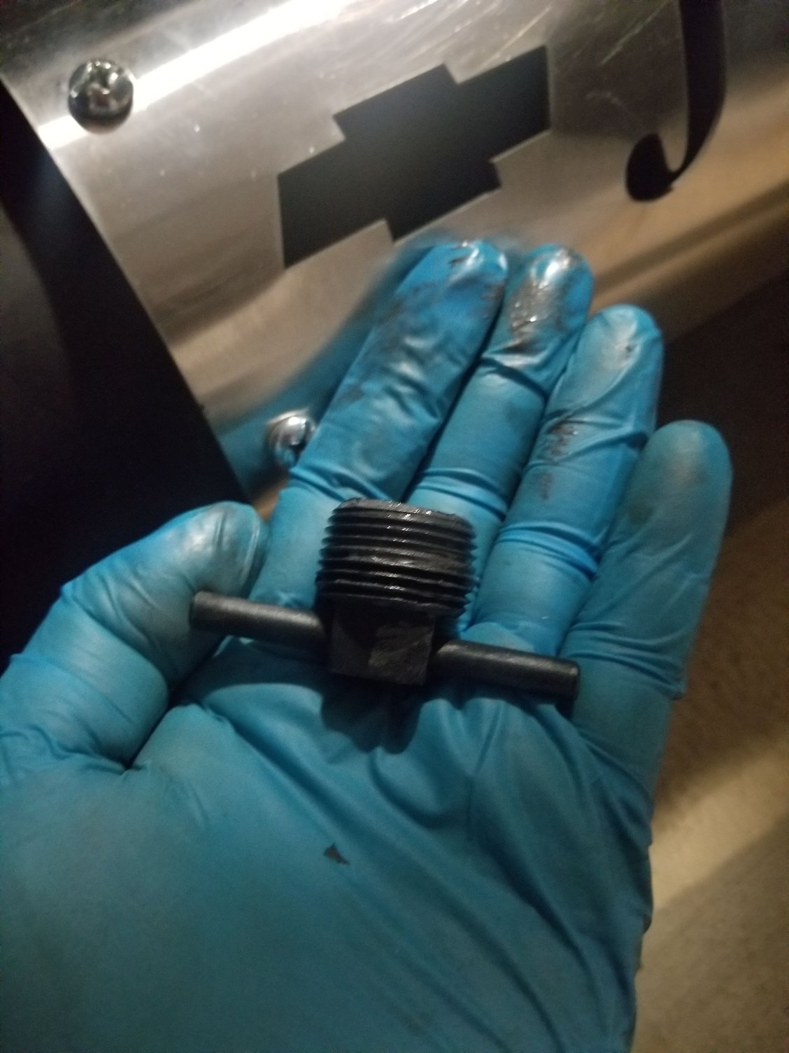

Another question when going through stuff, I noticed a rattle in the side pipes, thinking I didn't have them secure, I checked finding a baffle inside, the odd thing is this baffle has a removable handle. I googled it but could not identify the pipe or baffle. Any thoughts? Till next week my friends.
Aloha,
Karp
Modified STS baffle? I've read that some folks installed a removal plug or similar on the capped portion of a STS baffle (auger style) to allow free flow down the center tube. It increases flow, but also noise. So you could reinstall the "plug" to quiet it down, but remove it at the track. I'm not sure this is that, but it seems like a similar concept.

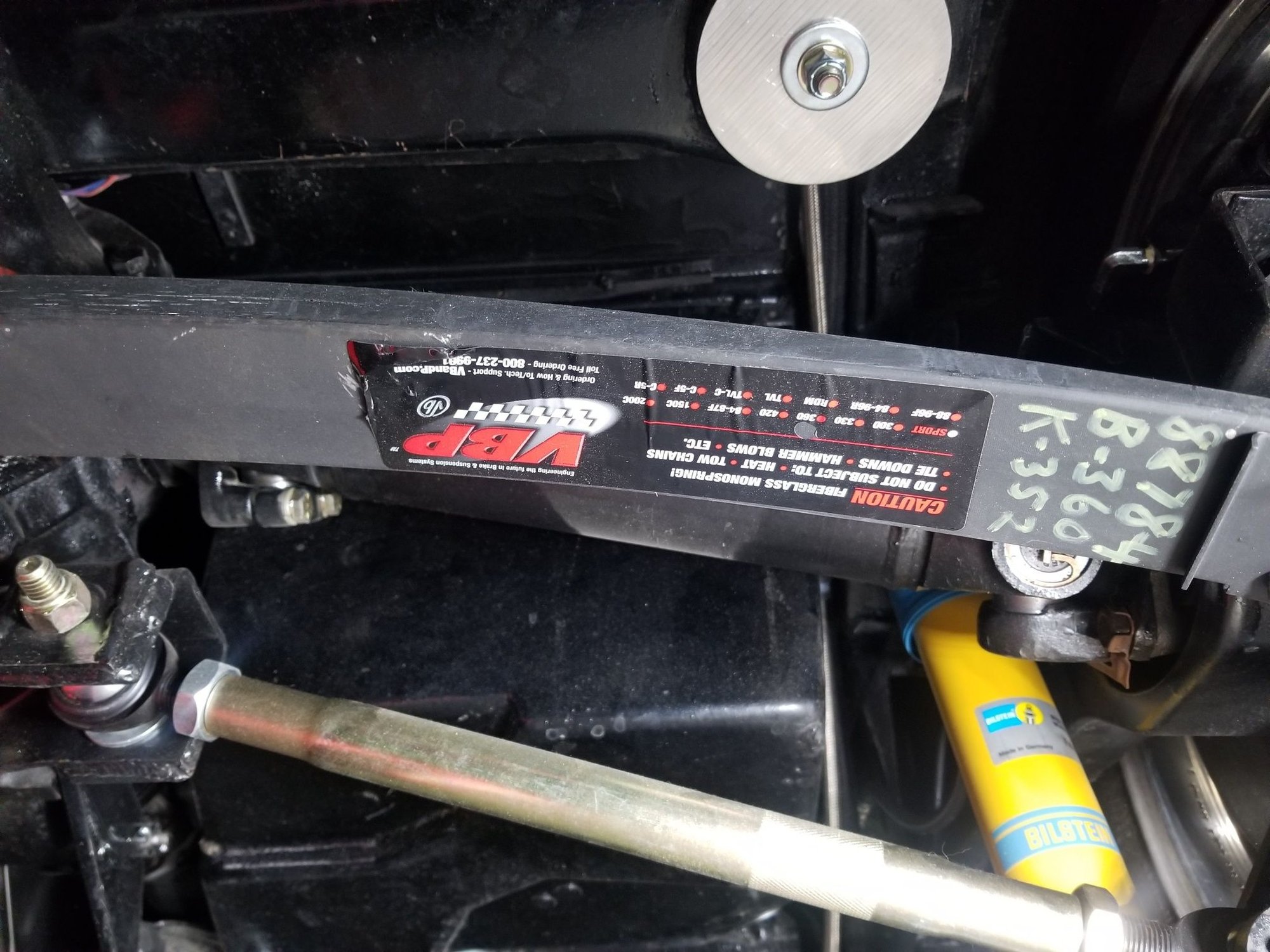

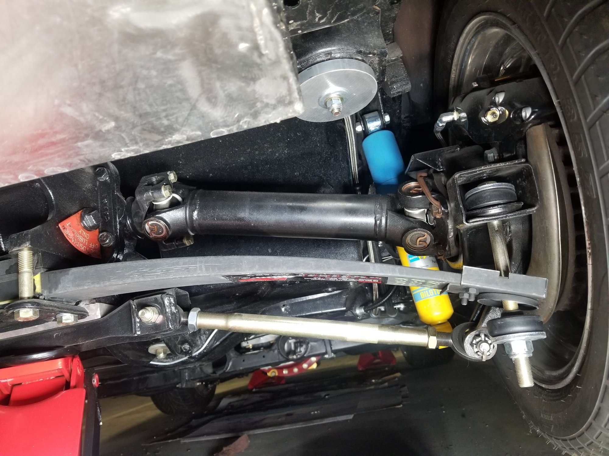

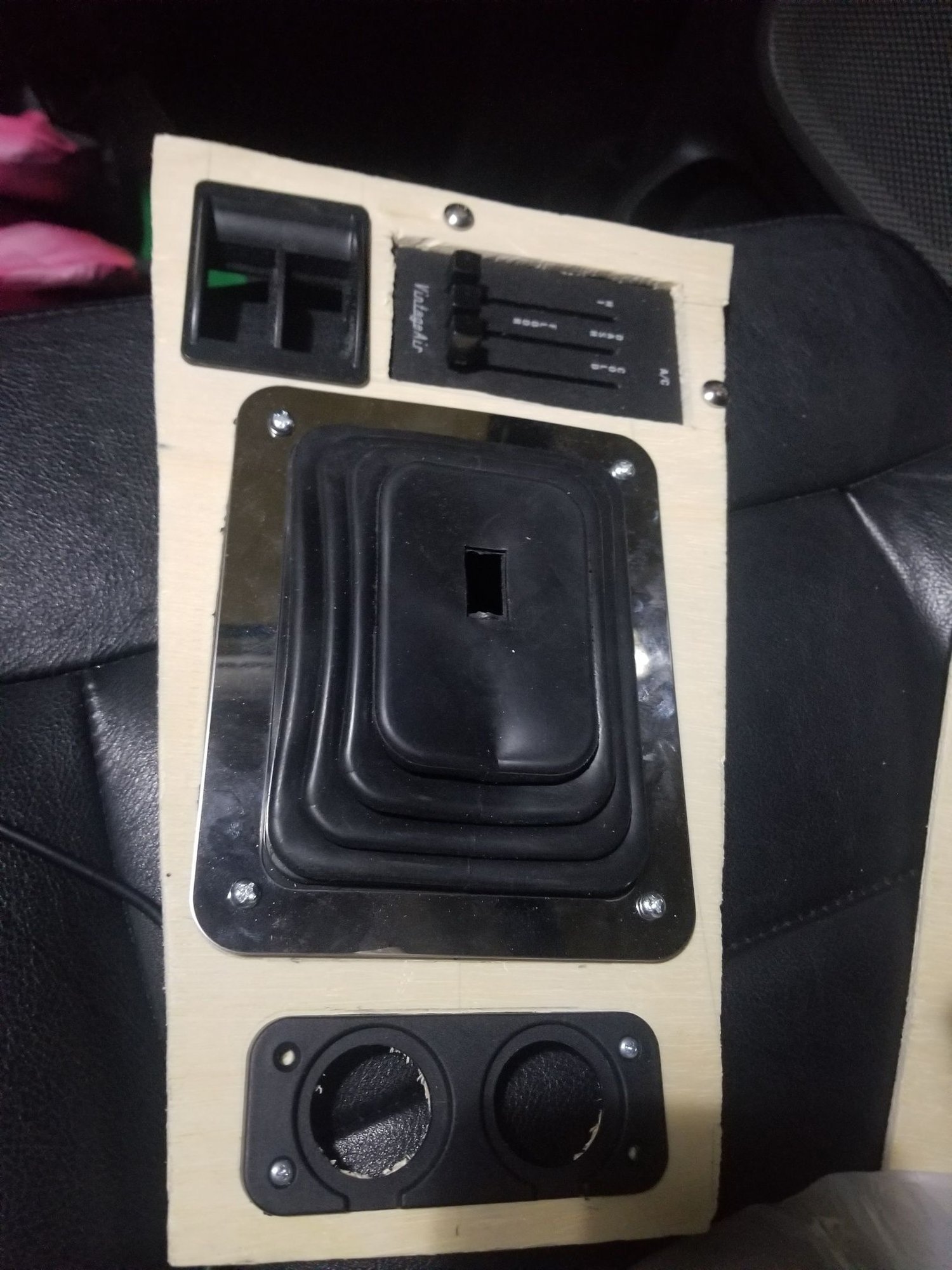

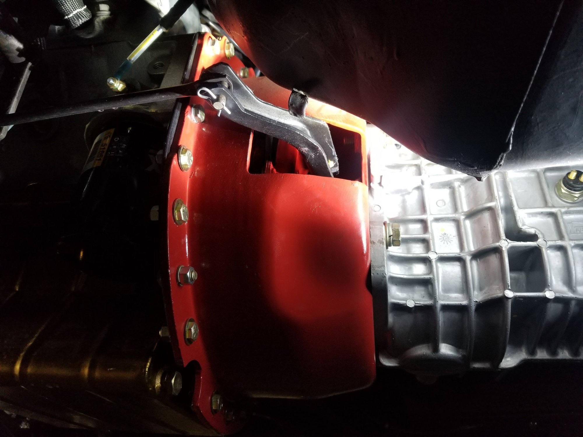

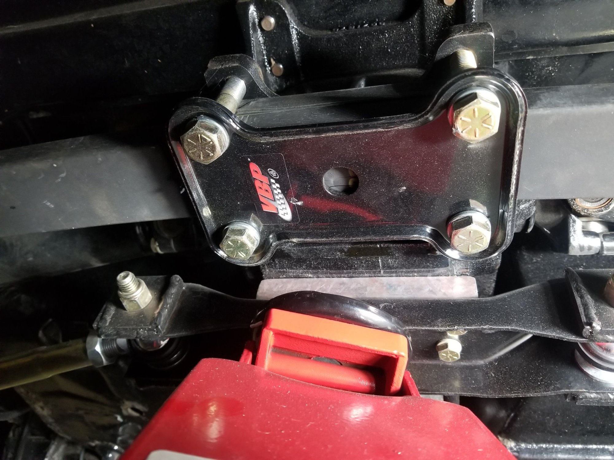

Its been cold lately so working on the Vette is flowing like cold molasses. I put her in the air, replaced the handbrake assemble (plastic handle on original broke), bleed the brakes (I hope all air is out), tightened up the suspension, and put together a simple shift plate. You can see the suspension parts are VBP, too bad they went out of business. Time to buy a gas can and add fuel. I do have a circuit draining power, so that is one downside that I will have to chase soon, but will keep disconnecting te battery until I find it.
Shift Plate Draft
Shift Plate 1
Shift Plate installed
Rear pass
Rear VBP
Rear VBP 2

I like what I am seeing here. All of the hard mechanical & bodywork is done!
I do have one safety item and one parts choice concern:
  • The rear 360# VBP poly spring is a good choice. However it is installed with the spacer on the top of it, and that requires longer spring bolts to adjust the ride height. Your ride height is partly based on trying to fit the tires in the rear fender openings, and partly trying to keep the driveshafts level. Ideal h/s angle is 1/2" high on the inside, so it flattens level under power. I would look closely at the stance and half shaft level. I see long bolts hanging down BELOW the rear tire rim. That is a HUGE safety hazard in case of a flat. At the very least cut off the end of the bolt. Better would be to put the spring spacer underneath the spring, thereby lowering the car. It just needs sorting out.
  • I have two concerns on the TKO600 choice. First is it is a standard and non-vette model which has the stick shift in the center and not 2 inches offset. Fixing that might work with a 2" curved offset handle, or a center mounted shift plate as you have done. The correct C3 shifter does not just bolt on, it requires machining the trans housing and a whole new shifter pivot box hangs out to the left 2", allowing the shift lever to go straight down into the new pivot point / box assy. Look at the SST site. Second is that is the old version, a TKO, which does not shift cleanly past 6000 rpm, according to what I have read. Based on your motor specs that may not be a good match. The newer TKX box has a vastly improved double-cone carbon synchros which shift cleanly to 7500 rpm. It certainly won't prevent you from getting the car running, but if it shifts balky, at high rpm, it is the trans, and not something else. There were also some shift-fixes available for that trans. Probably no way to tell if that trans already has them or not.
You may want to get more input from GKULL on that. I believe he uses that TKO, and road-races the car with it, and has for many years. I know he sees 7500 rpm often.

i like that shifter

Silver Sport Transmissions offers some nice shifter options as well.
