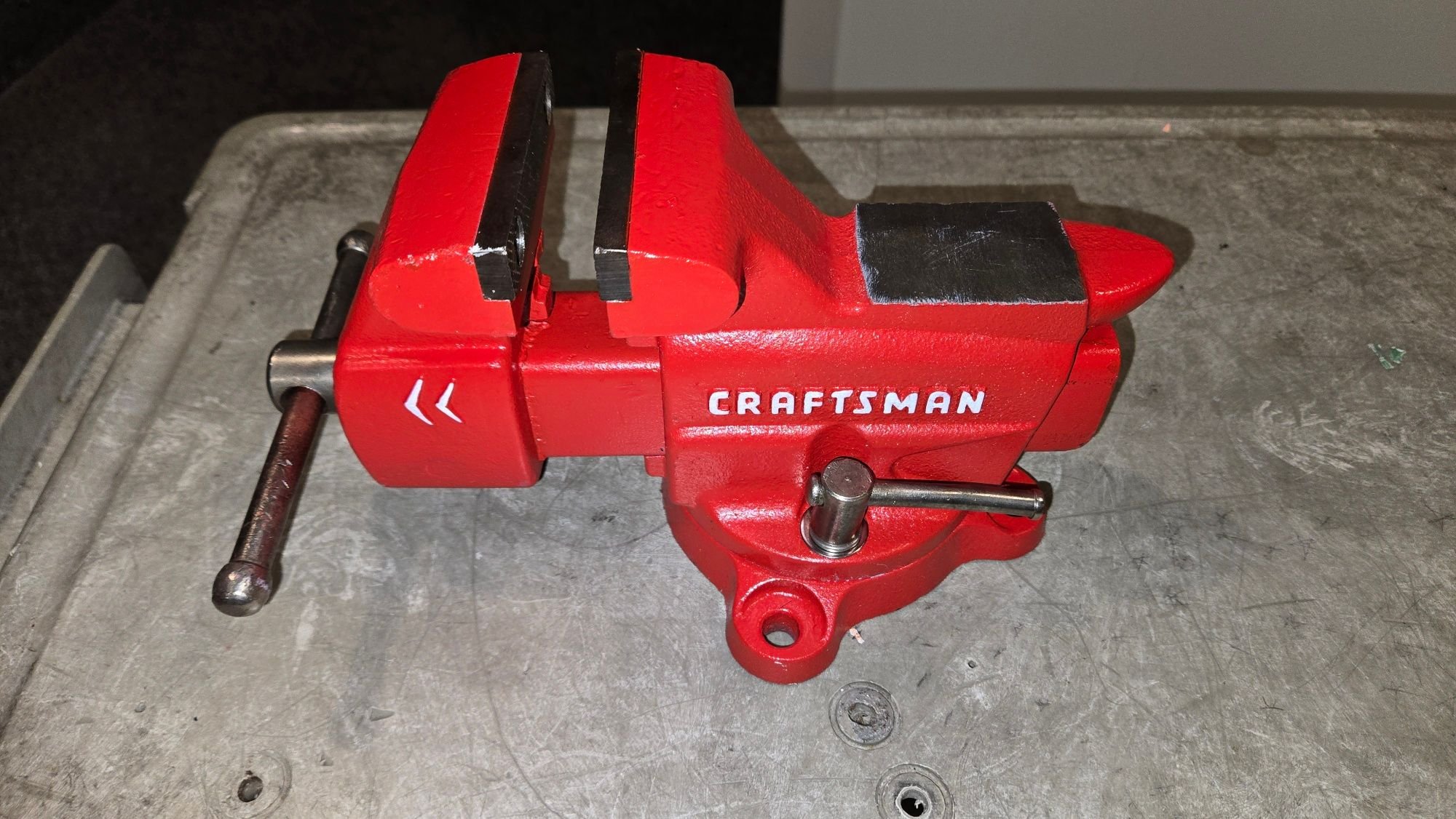

I didn’t get a chance to work on the Vette this week. Yet I picked up a Vise, brought it into my weekend job and refurbished it. Other than that, I have been planning out a wire map layout to clean up the install of the wiring.
I plan to finish cleaning up the garage in the next two weeks where I can get the Vette in the air. Have a great week, I’ll update soon.

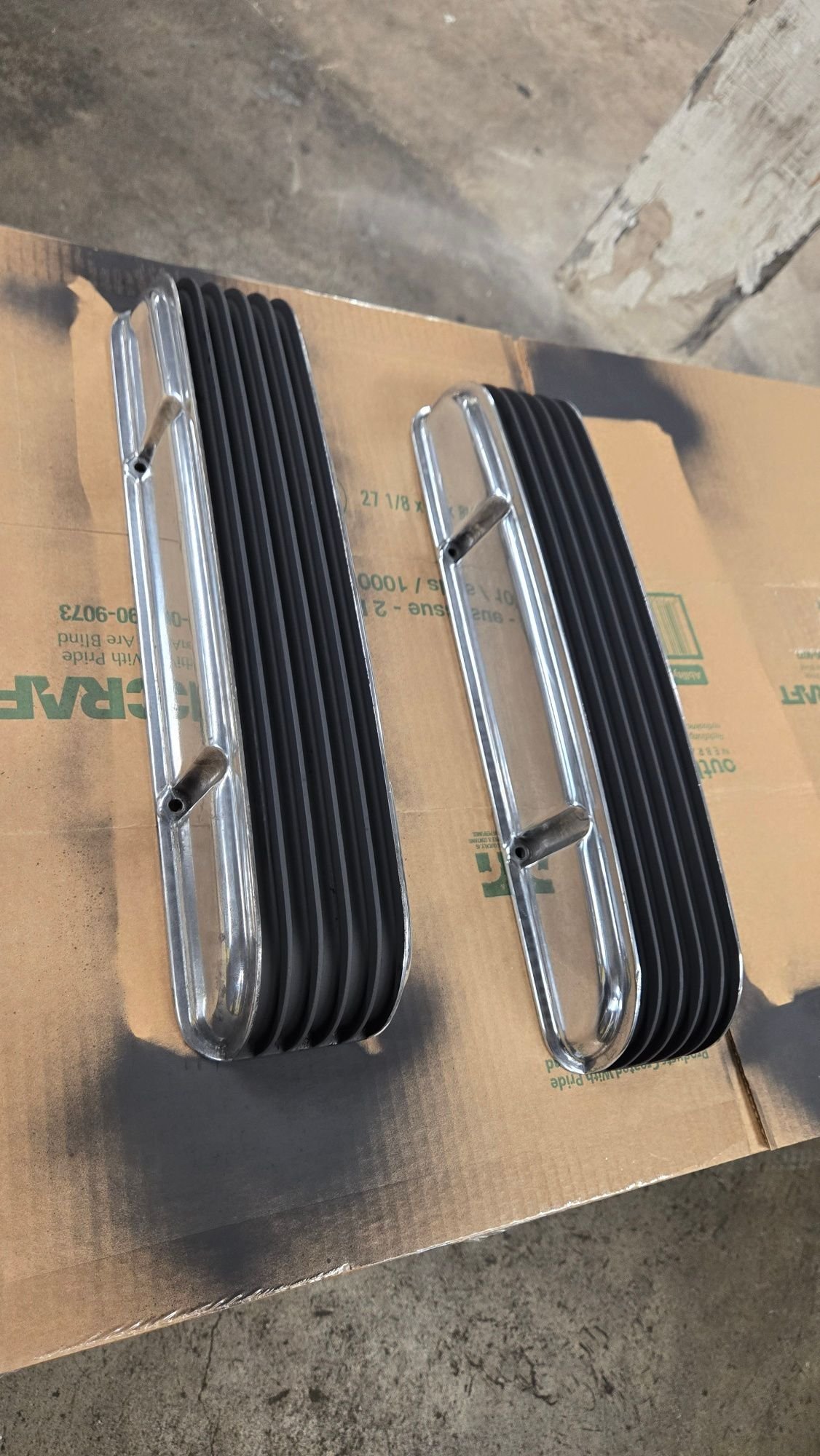

Hope everyone is well. The Vette is in the air in my garage, and I started removing the seats and carpet to clean up the wires with the wire map I made. When it lived in the Apt Parking garage, I always had to have it look like it was operational and covered. Now that I have a garage, I can take it apart to make sure the wires are ran correctly and nice. With summer upon us I hope to get to work on it more often. Here are a few pics of some stuff I cleaned up the other day. Anyone know the Admins to get the Air Force & Army Badges added? Thanks.
V/r,
Barry
Looks like I forgot to take before pictures, yet decided to start refurbing what I can and hang it on my garage wall until it's ready to go in the vette

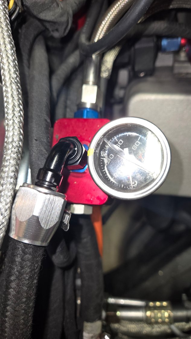

I finally got the fuel pump to work properly, it was a bad fuse. I must have popped it one day.
The fuel pressure gauge was leaking a little so i decided to put new blue monster gas tape on it and broke the glass on the guage lol. Im replacing with one from home depot until I can get a new fast one.
got the pressure up to 43 psi and still she hasn't started but have to recharge the battery now.

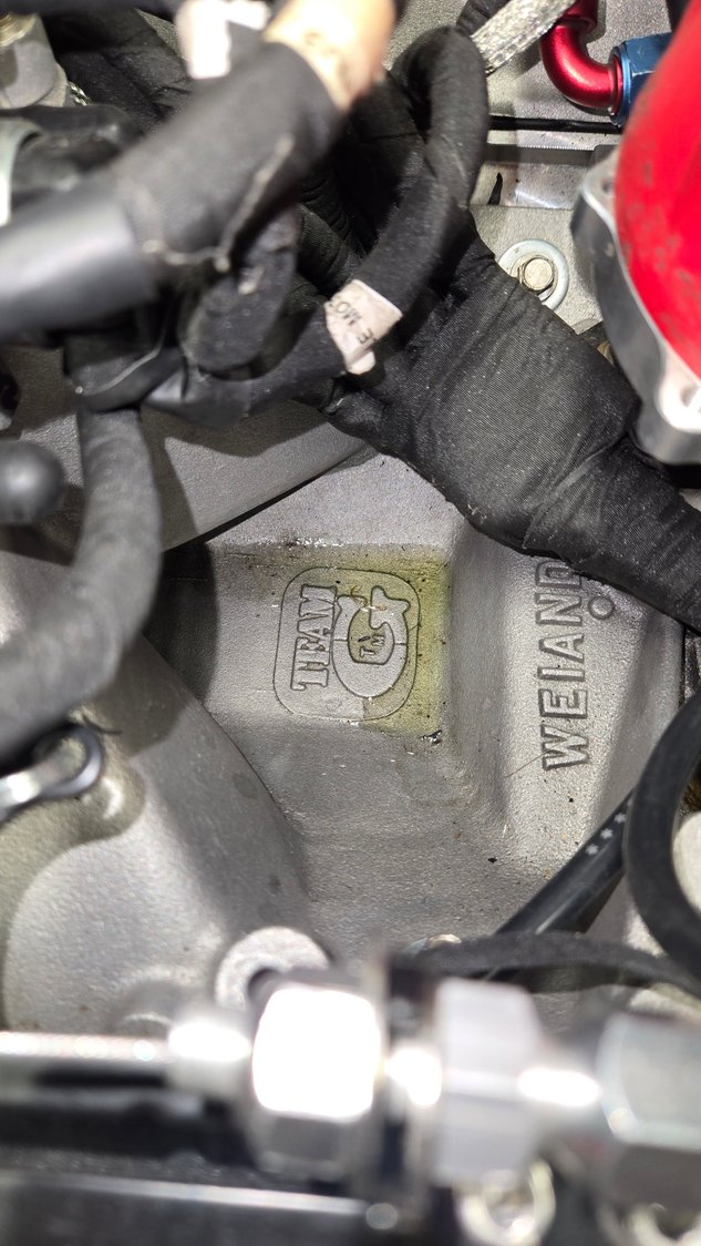

​​​​​​i did notice oil in the bottom of the intake after crankingnit, this is strange. I remember when i got the car there was oil in the same spot but chalked it up to being in transport. Anyone have ideas of why oil would pool in the bottom of the intake while cranking. The bolts are tight, not from the distributor and dont see.no obvious leaks between the intake and heads.
Lastly I placed a aluminum bar between the car frame and The AC.bracket to mount the AC and Fuel realys.
with any luck she will start this week.

Hmmmmmm,
Oil pooling in the intake just from cranking???
Seriously leaking valve cover gasket?
Vacuum port or plug missing?
Dripped when you pulled the distributor out?
Dripped when you poured in the engine oil?
Old Oct 9, 2025 | 05:17 AM
  #75
Rescue Rogers's Avatar
Rescue Rogers
Is my vette stock?? HAHA
Joined: Oct 2015
Posts: 19,977
Likes: 9,061
2016 C3 of Year Finalist
That looks like cookant. Check your hoses and thermostat housing bolts

Thank you Larry, I’ll keep that in mind. Oh, you are next to a Speedway, I didn’t realize there was one around me, this may be a neat thing to do one weekend, thank you.
Its defiantly oil and not coolant, I cleaned it up and will monitor it in the coming weeks.

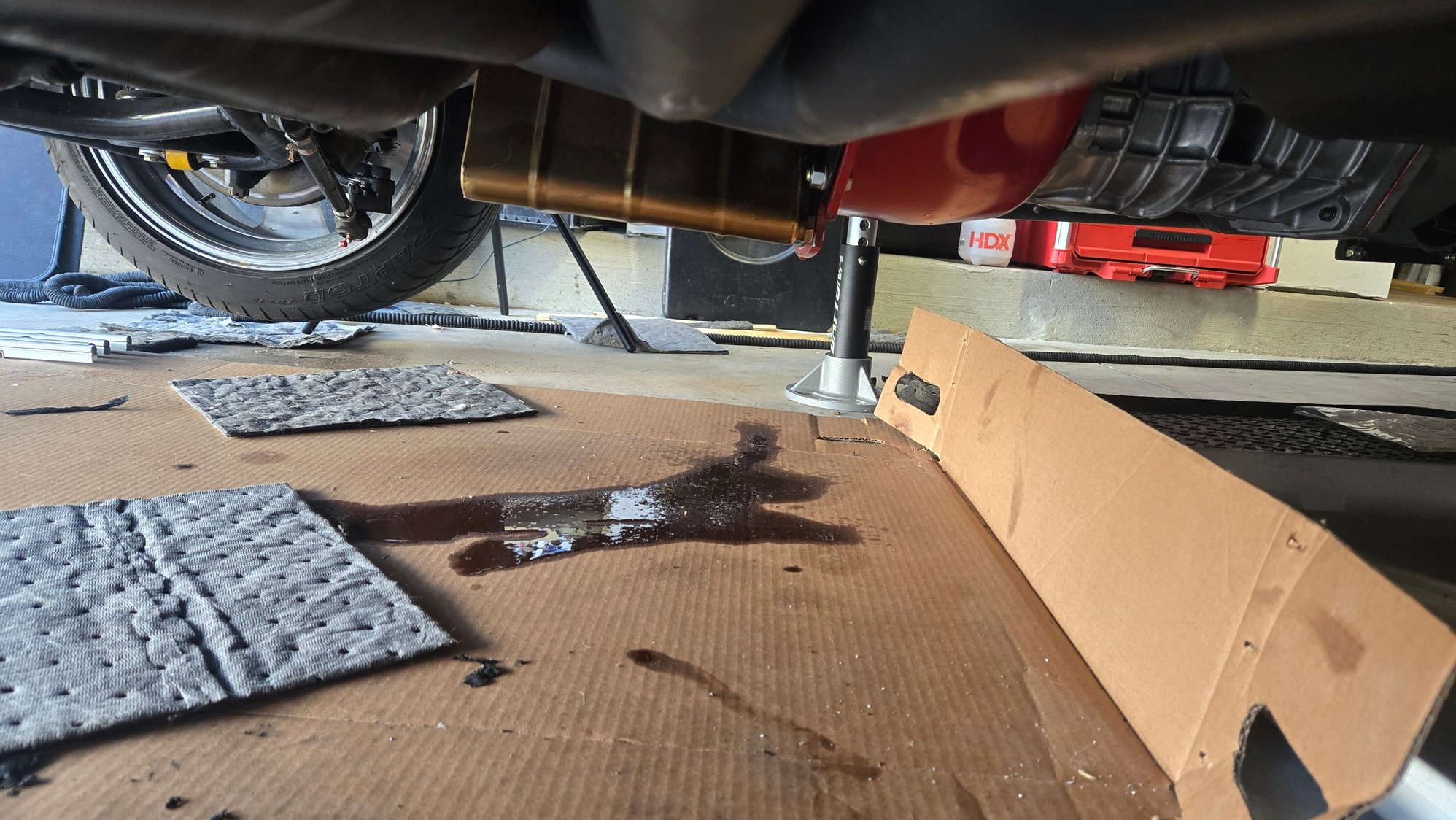

As many have said before one step forward and two back.
thanks goodness I put a pan and cardboard under the car.
Just looked under it after getting up to temp and the FAST EFI programmed and noticed this mess.
looks like I know where the oil is coming from, the rear seal must have went dry.
I'm going to finish putting the interior together and then tackle the transmission.

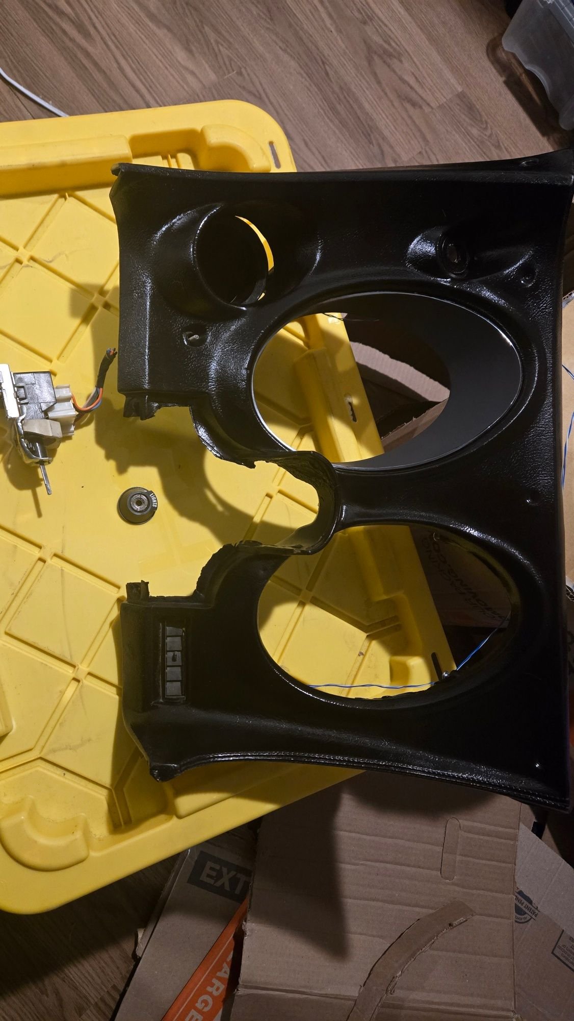

Even though I have the oil leak set back I am steaming along on getting the interior and electrical back together.
here is the latest progress.
with any luck I'll bebable to finish what interior I have and get it jacked up high enough to drop the Trans by next week. Looks like I'll have the time as the Govt doesn't show many signals of reopening.
