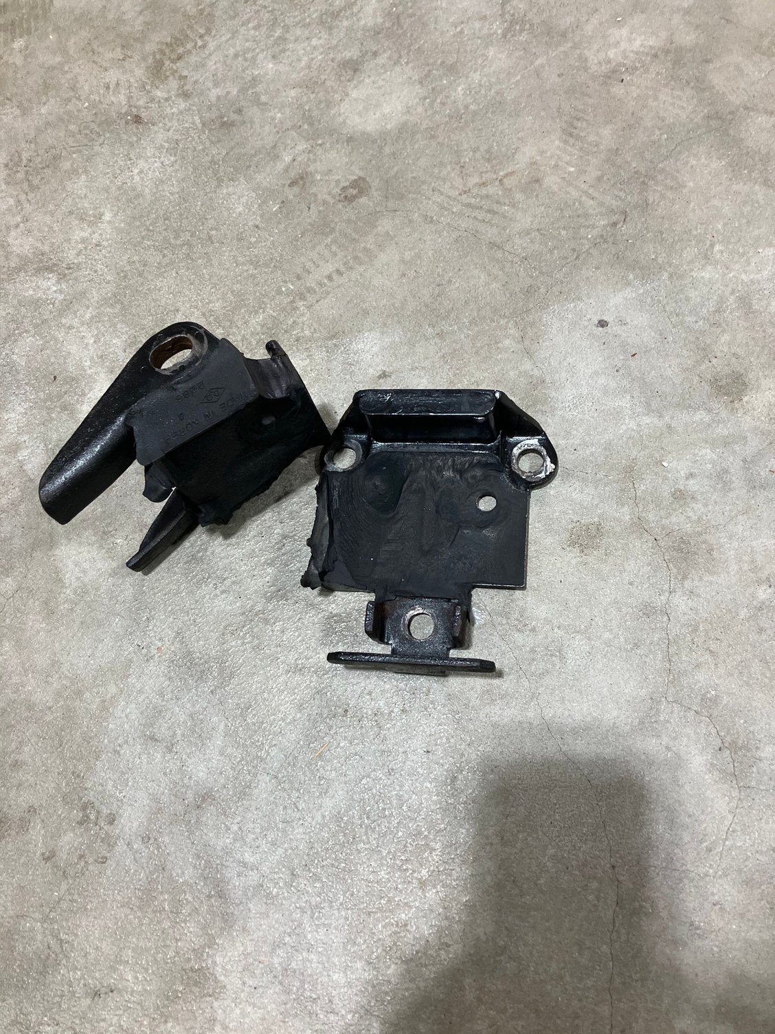

I Know this has been covered many times but I feel it is worth bringing up again. The 77 I did over the winter came back yesterday for an oil change and some tweaks on the car. The owner said he heard some noise when accelerating above 4000 rpm and hard on the throttle. Some clunking when shifting at higher rpm. My immediate thought was engine mount. Looked at the fan shroud and evidence of the fan hitting the shroud. Put it up on the lift and this is what I saw. Sure enough the mount is toast. When I out the motor in this winter I looked at the mounts and they looked pretty new so I reused them. Mistake not replacing with urethane or solid mounts. The stock rubber mounts even though when new can’t hold up very well with a stick car and an aggressive driver. New poly mounts already on the way. I have broken mounts before so I should have known better. No major damage done. New mounts should be here tomorrow. All good. Just replace mounts anytime the motor is out so you don’t have to do this twice.

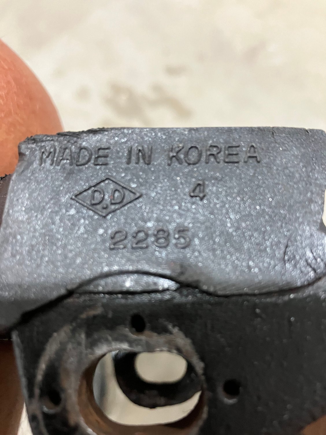

And here is the culprit. I’ll let you draw your own conclusion in this. Obviously this was not original.
To Broken engine mount
