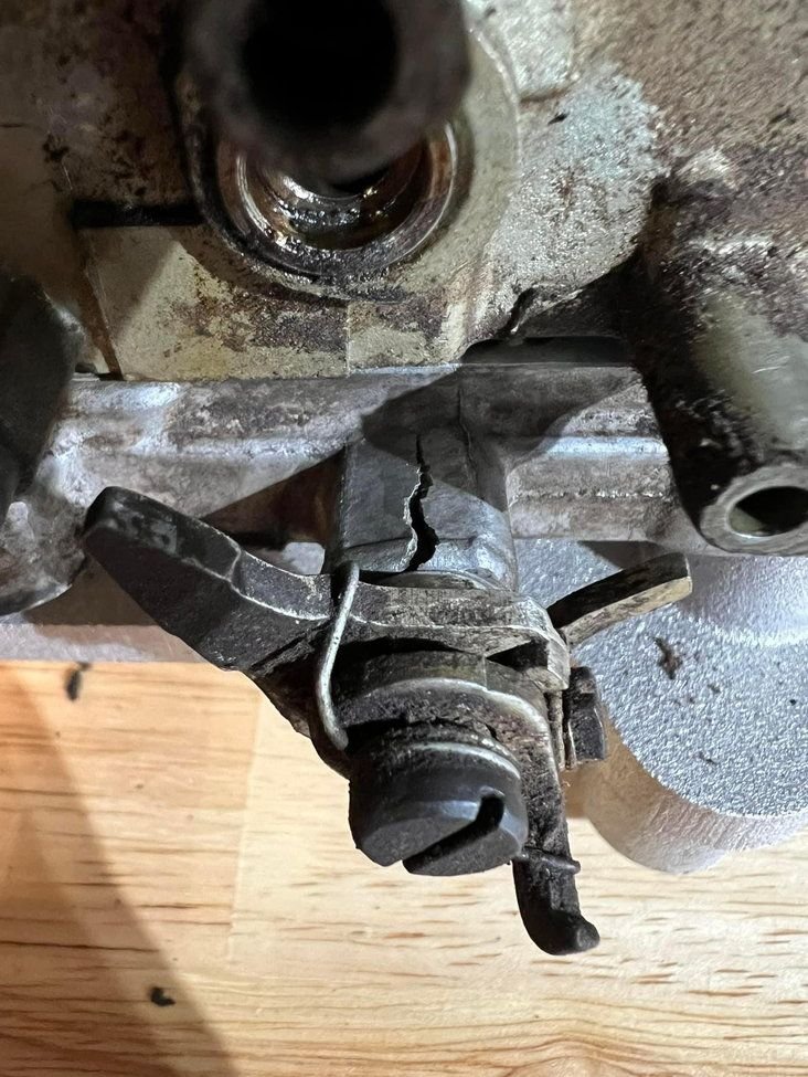

My baseplate on the original L48 card has a crack in the lower base plate on the choke shaft. So I either need a new baseplate, jb weld?, or another carb. A guy at my work has a q-jet from his 74 he is going to give me. So, hopefully between the the 2 I can get a functioning q-jet for now until I can get a real rebuild on it for performance purposes when I do the engine over. Not sure if this is salvageable or not. My current carb is an Ebrock 1406.

The '74 carb is a 4MV carb. Your '78 is an M4M. You cannot interchange any parts between the two carbs - they are completely different model-series carbs. The '74 4MV carb also cannot be used on your '78 engine/manifold and still make the choke work. You need a complete M4M carb or a replacement 1978 throttle plate off of a like-numbered carb.
That's not the choke shaft - it's the primary shaft in the throttle plate. No, you cannot fix that with JBWeld.
