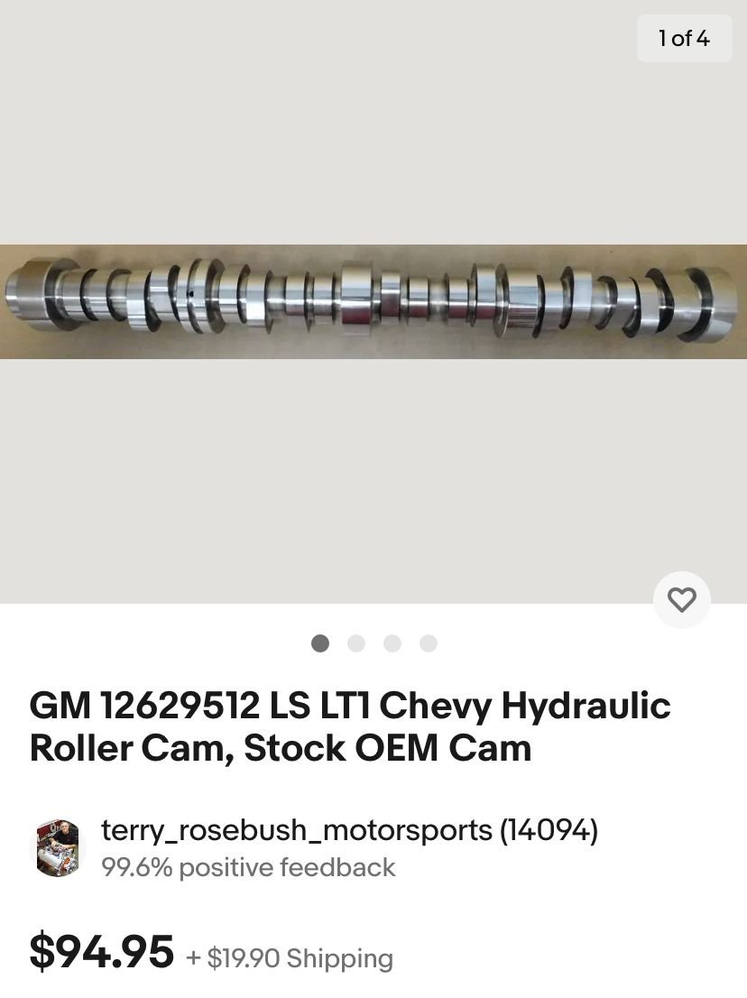

Like a cam I could get off eBay for $150? Out of a newer Camaro? Sorry if that’s a dumb question but I’m new to all this.

Rescue Rogers's Avatar
Rescue Rogers
Is my vette stock?? HAHA
Joined: Oct 2015
Posts: 20,209
Likes: 9,348
2016 C3 of Year Finalist
no...go through a reputable dealer like Summit or Jegs or Speedway and order a good cam.
I would call Comp Cams directly and tell them what you have, what you want it to do and they will help guide you....Dont buy your engine parts from Ebay

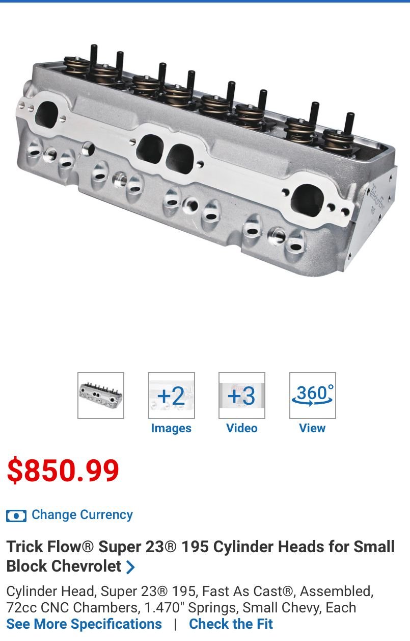

The 107 LSA would be acceptable for a 383 if the CR were high enough and the advertised duration was not so large. What you have there is about 74* of overlap on that cam. What you likely want is something around 60* to 65* of overlap.
your advertised duration is a large issue, creates lots of overlap on that cam. Look for something in the 275 to 280 advertised duration with a 230ish @.050 duration on the intake.
we don’t know your CR, or what heads your running or your exhaust system, or converter stall rpm, transmission or rear gear ratio, so hard to make a good reccomendation.
give us more info and you’ll get better info.

These are the heads. 2.5 inch stainless exhaust with x pipe. No stall yet. Factory differential. I don't have an exact number on compression but it is at least 9:1
