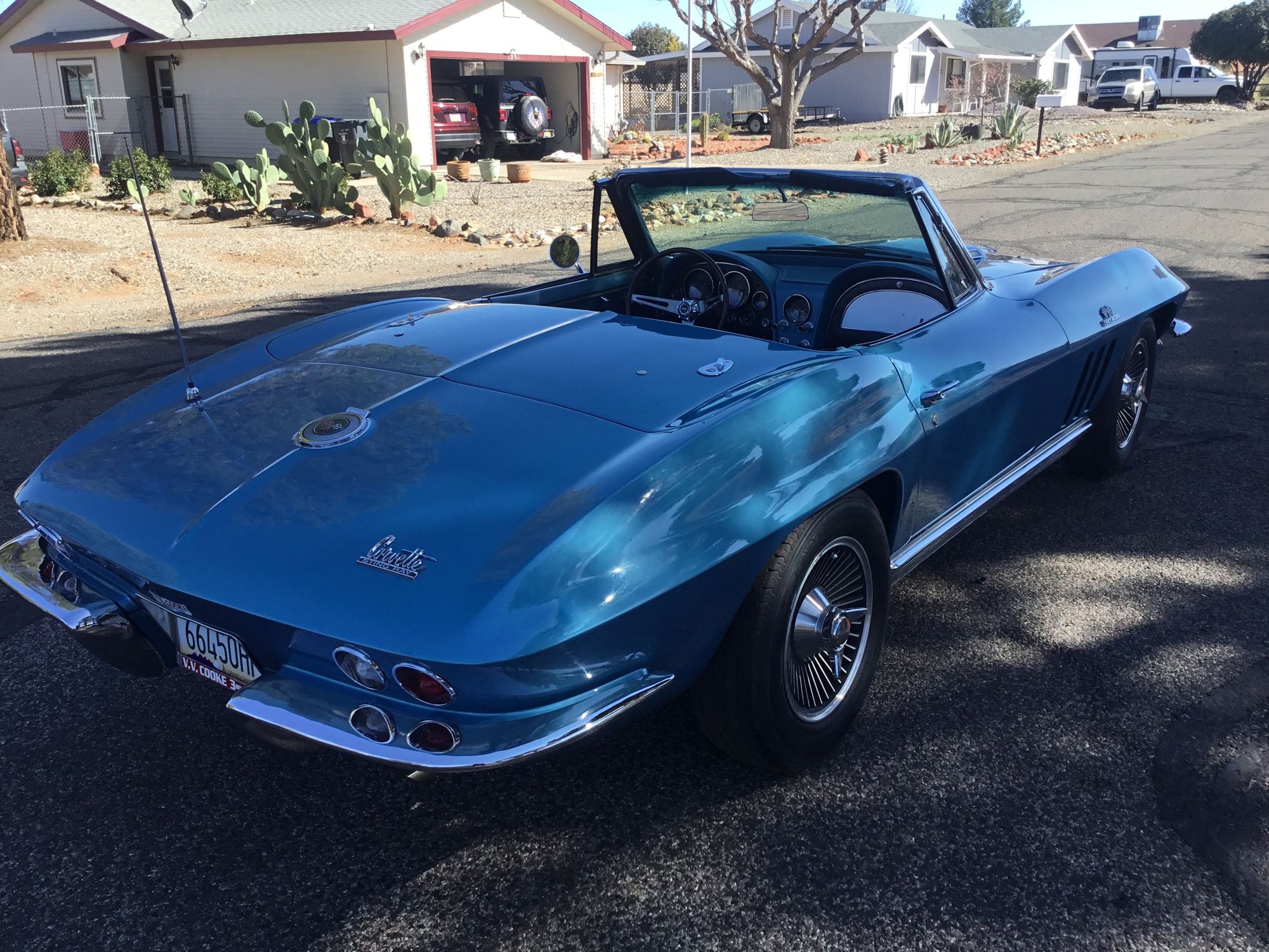

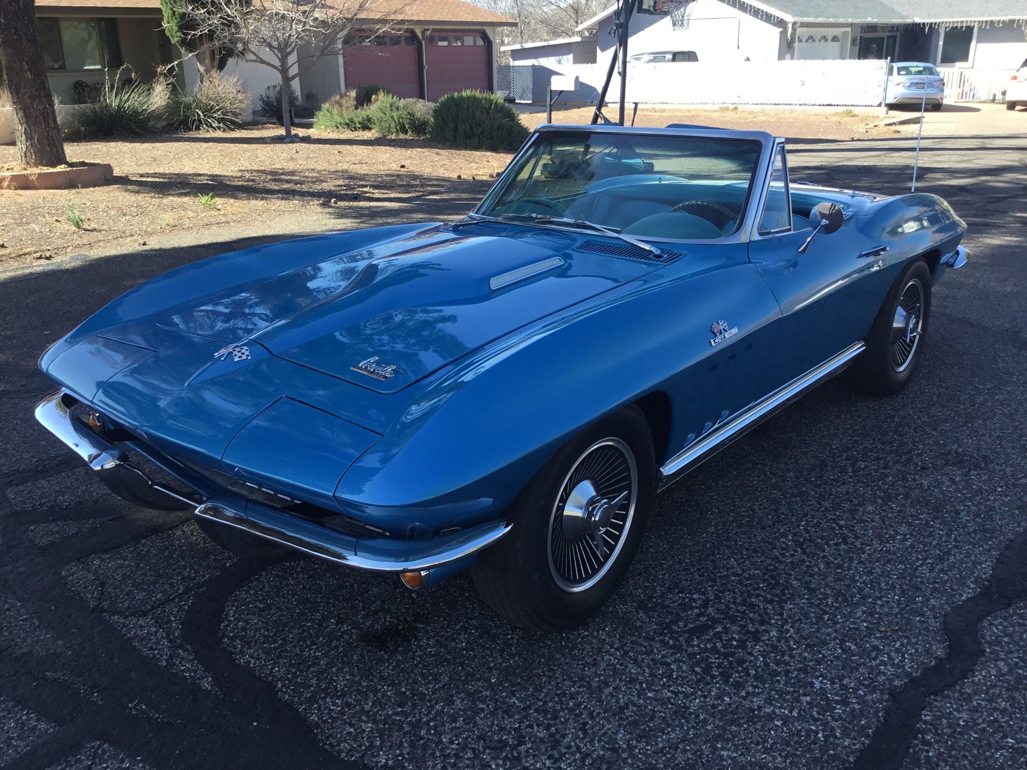

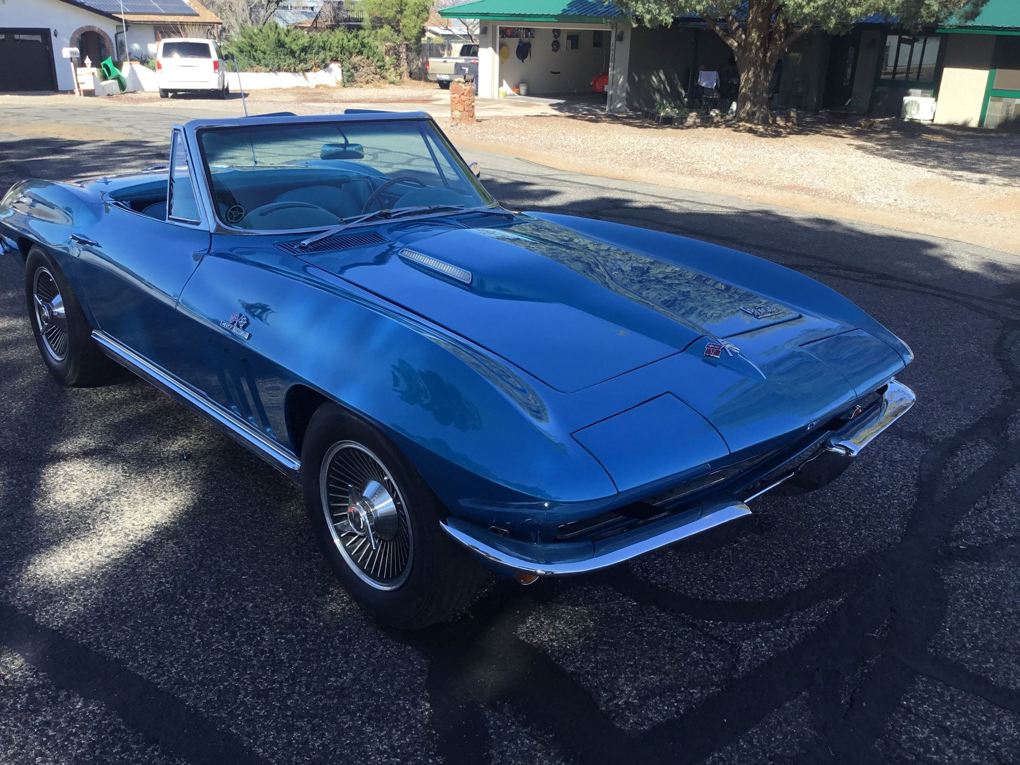

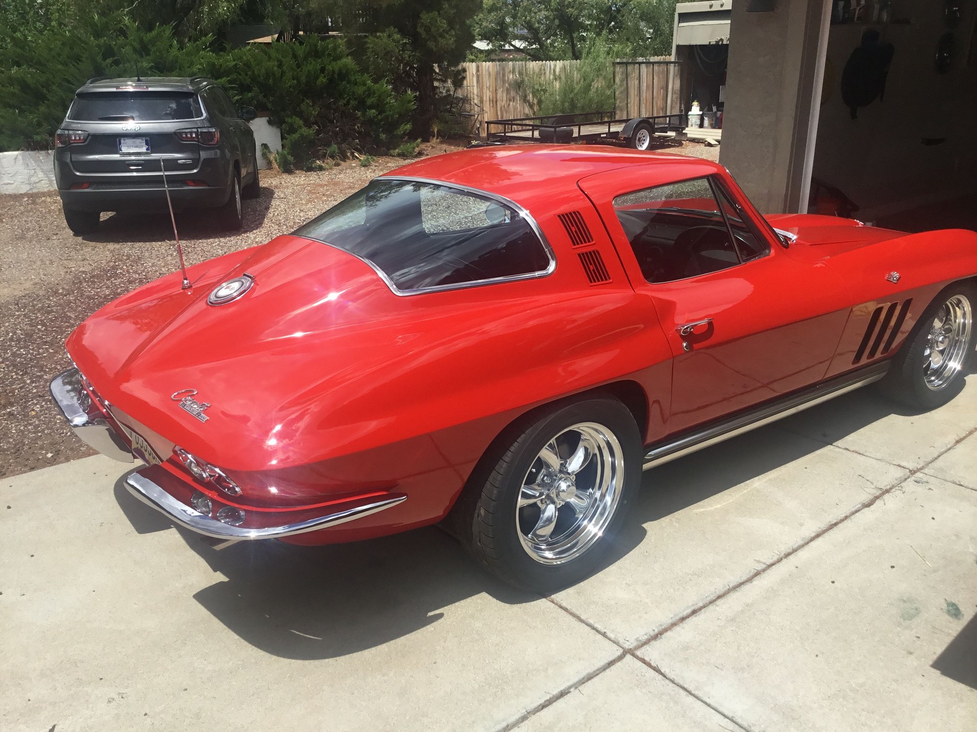

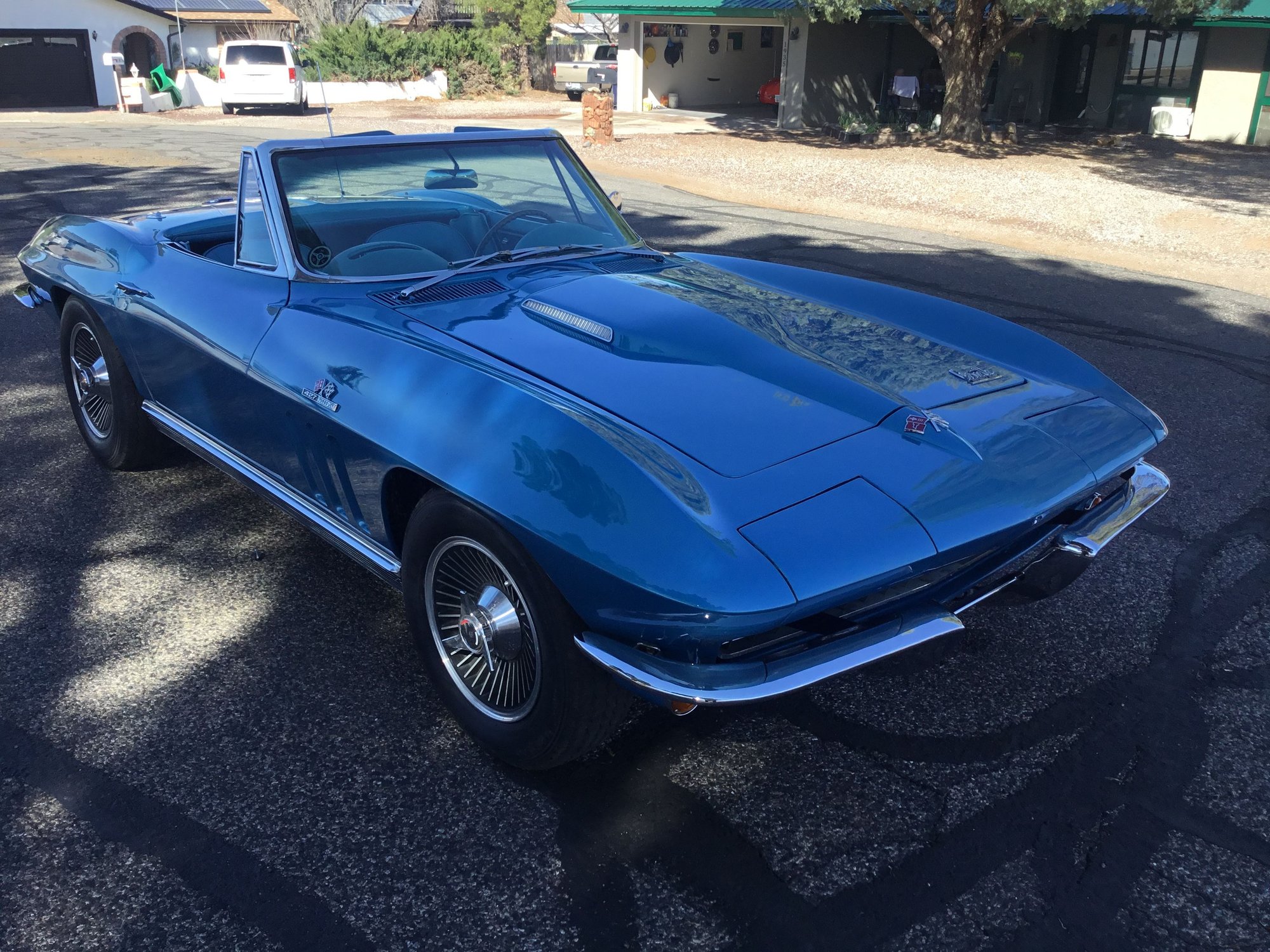

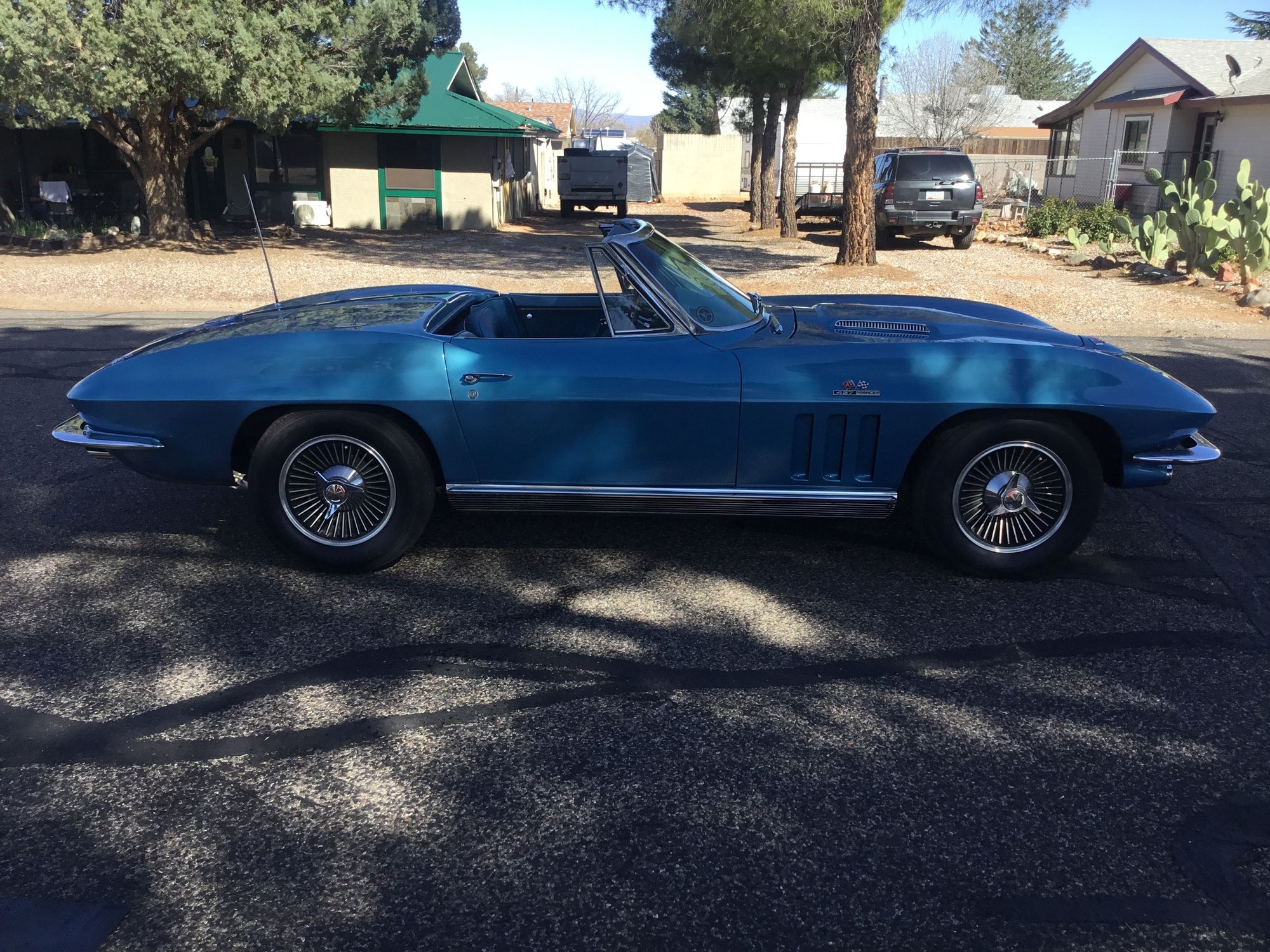

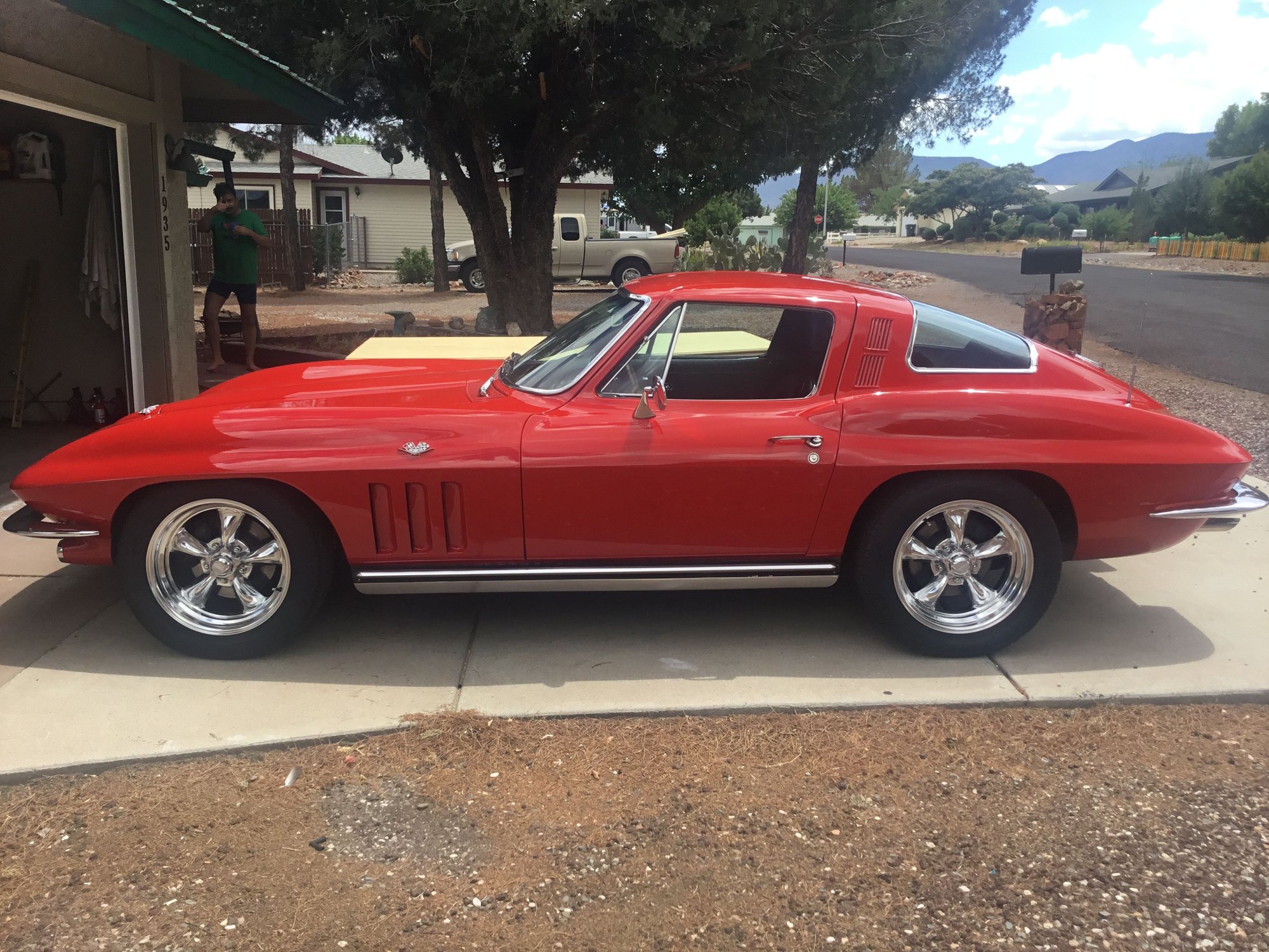

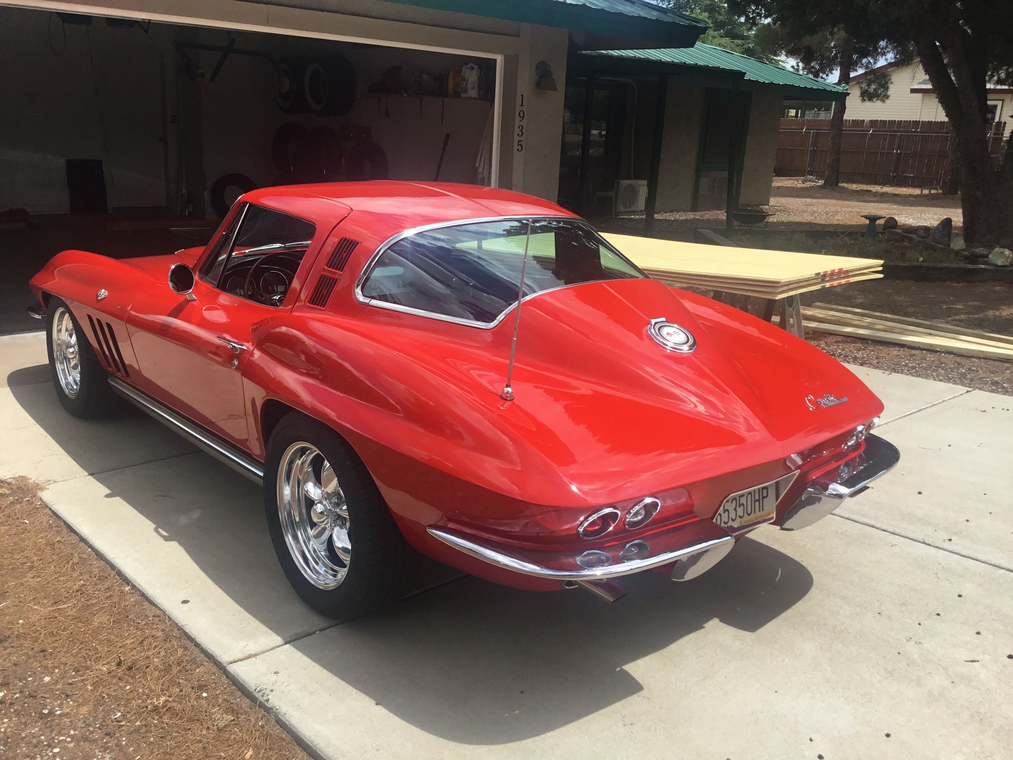

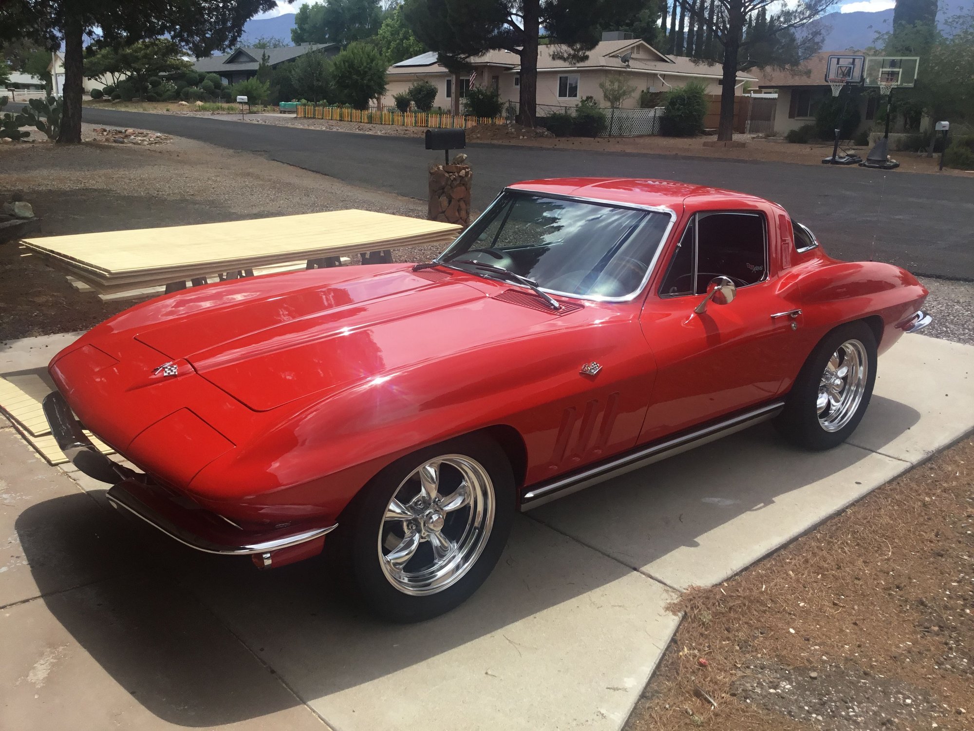

Regarding the shocks I have single adjustable QA1 shocks all around on both my 65 and 66 cars. Both have a sport alignment. The 66 has Avon 205 x 15” tires and the 65 has Toyo V speed rated 17” tires. As stated previously with this combination these cars will now pull 1 g lateral force that the average driver will not be able to drive to these limits. This was accomplished for far less money than you guys will spend with the mods you are speaking of.
Regarding looks and tire sizes here are pictures of both my cars as I speak of.
WOW! Beautiful cars! I love them!

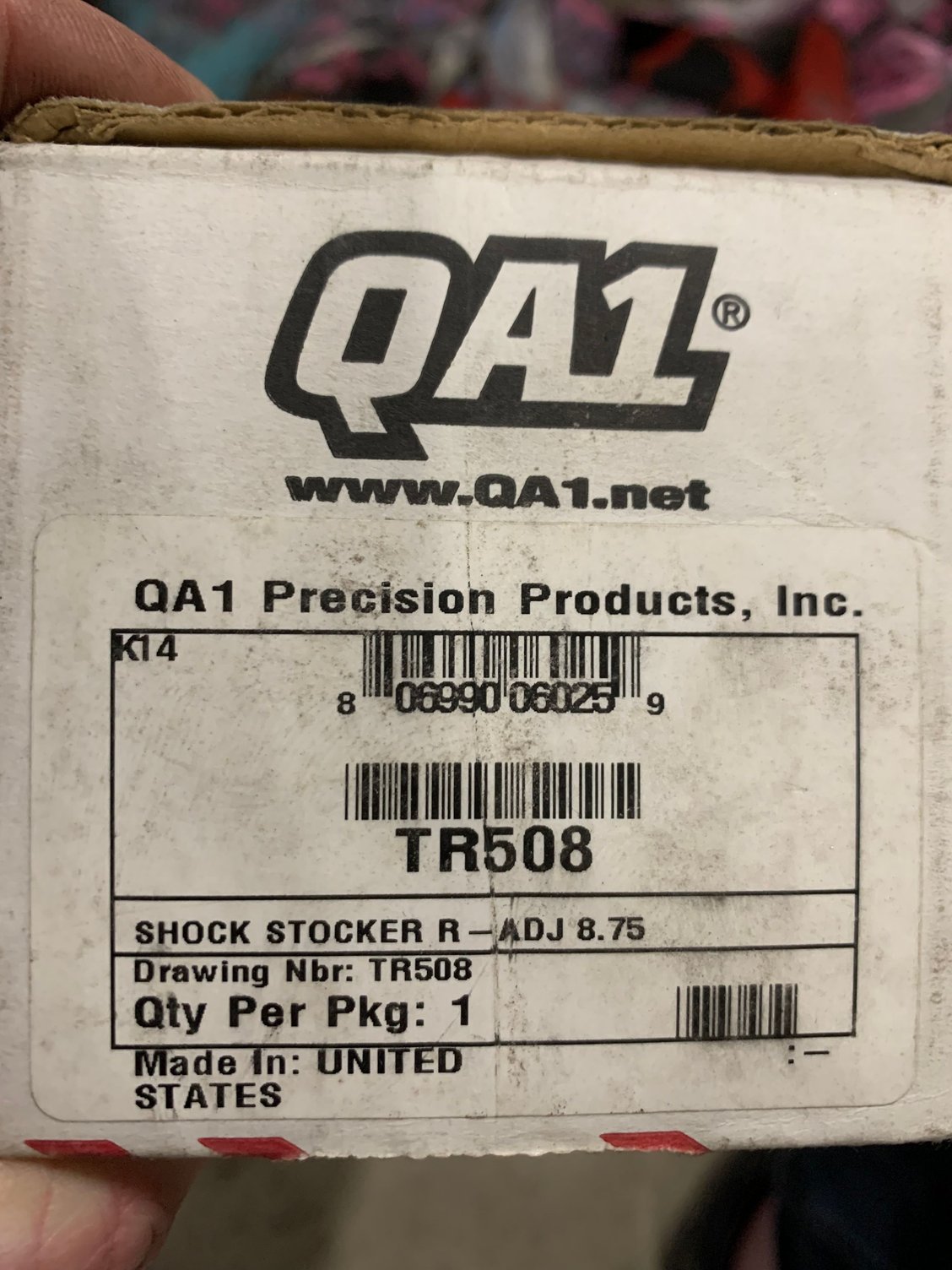

I bought QA1 single adjustable drag shocks. I siding had to trim the lower control arm with a 3/8" slot so the **** should go in. Just started reassembling one side this week.
I had to use different lower bolts than the ones it came with. Wrong threads.
