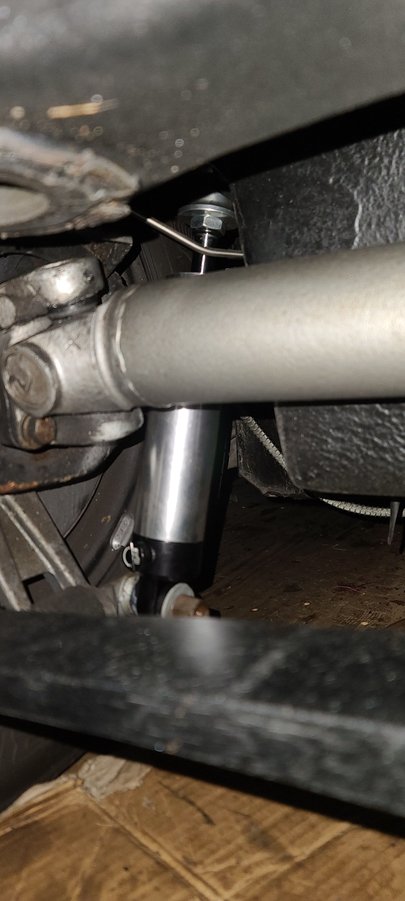

What about QA1 shock absorbers? They are adjustable. There's two small ***** at the base. Each has 6 settings. One **** allows you to vary the damping of the compression stroke and likewise, the other **** for the rebound stroke. The composite transverse spring on my 68 gives it a case of bouncy butt with the current Bilstein shock absorbers. Been thinking about getting the QA1's for the rear and stiffening up the shock on the rebound stroke. They are a little pricey. Anyone with QA1 experience?

Just installed qa1 single adjustable shocks along with Van Steel 360 lb composite spring. Previous owner had an incorrect nine leaf spring installed. The car sat an inch too high with 8-in bolts and was still incredibly soft. So I had to replace it anyway, and for a similar price the composite is 30 something pounds lighter. The new spring is definitely stiffer, but I have to say not much different driving down the road then my wife's Mazda cx-5. No clearance issues with adjuster *****. Sorry for the lousy photo.
