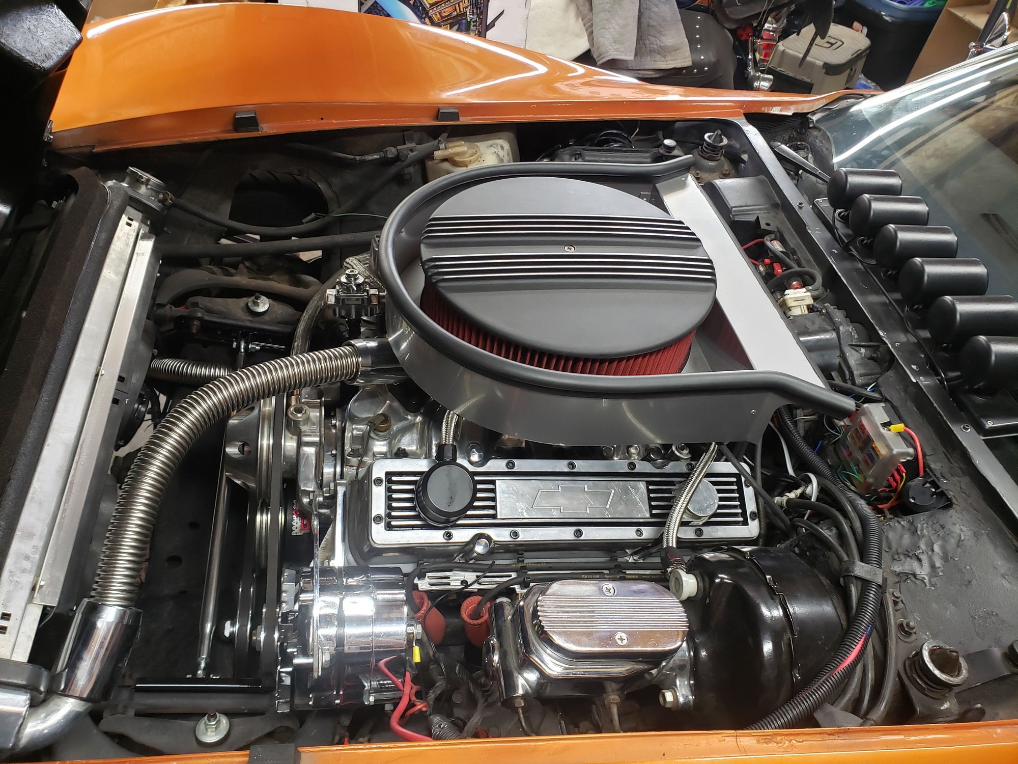

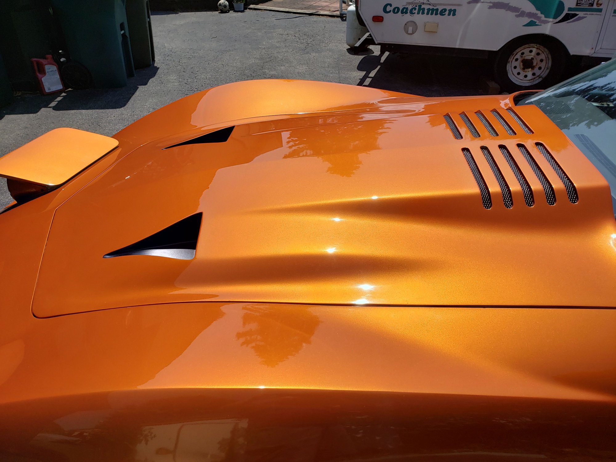

I'm not sure if this will be what you're looking for, but this is what I did to my hood a number of years ago. I designed the grills to make them look, like something from back in the day and had those cut from aluminum and then powder coated. My buddy then cut the hood to match with a half inch inner gap on all sides.

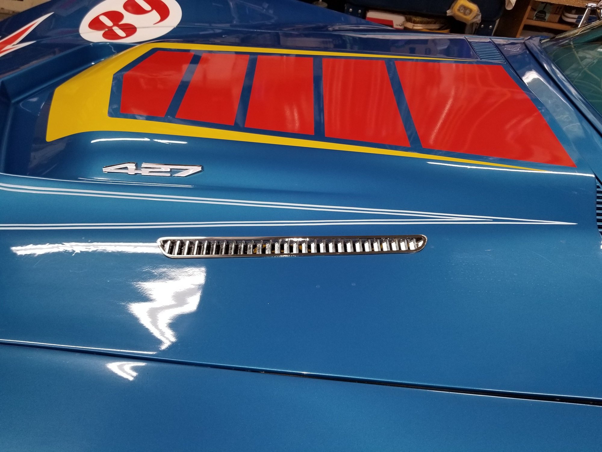

C1 of Year Finalist (performance mods) 2019
Chevy did this on the 65/66 BB hoods. They have water shields on the underside to keep water from directly hitting water sensitive items. It DOES exhaust a lot of engine compartment heat.

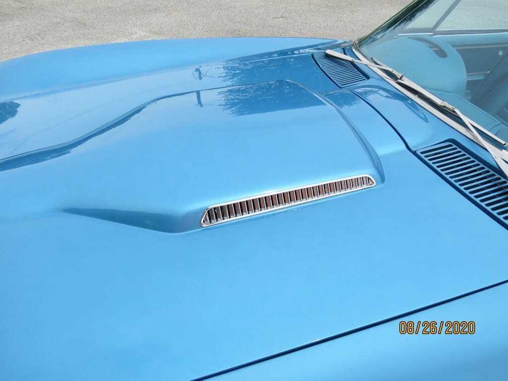

I also started a thread on this very topic last summer. Many of the same folks commented there as well (thanks again all!). Good information. I think a lot of the stuff members have done to vent their cars is creative and looks good, but after all that, I realized it didn't want the trouble of trying to cut openings into the chrome hood trim (which was the only option I would have gone with). (non-l88) 427/LT1 hoods without those chrome trim pieces just don't look quite right to me - looks unfinished.
As clean as the work is from many of the members who have done in adding vents, for me, the only option that would look the most factory-like would be to use the existing fake BB/LT1 vents, and that potentially puts a lot of water all over the front of the motor and frame (during car washes, or even if caught in a flash storm).
For now, I've decided to be content with the 'fake' vents in the (non-L88) BB/LT1 hood, and to leave it be.
