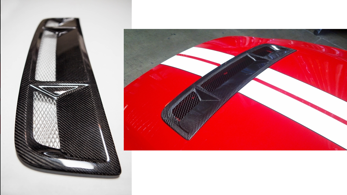

Several of the C7/ Jimmie Johnson ones around-
Denpo-
Punisher-
I am looking at doing something- but haven't made a decision yet...

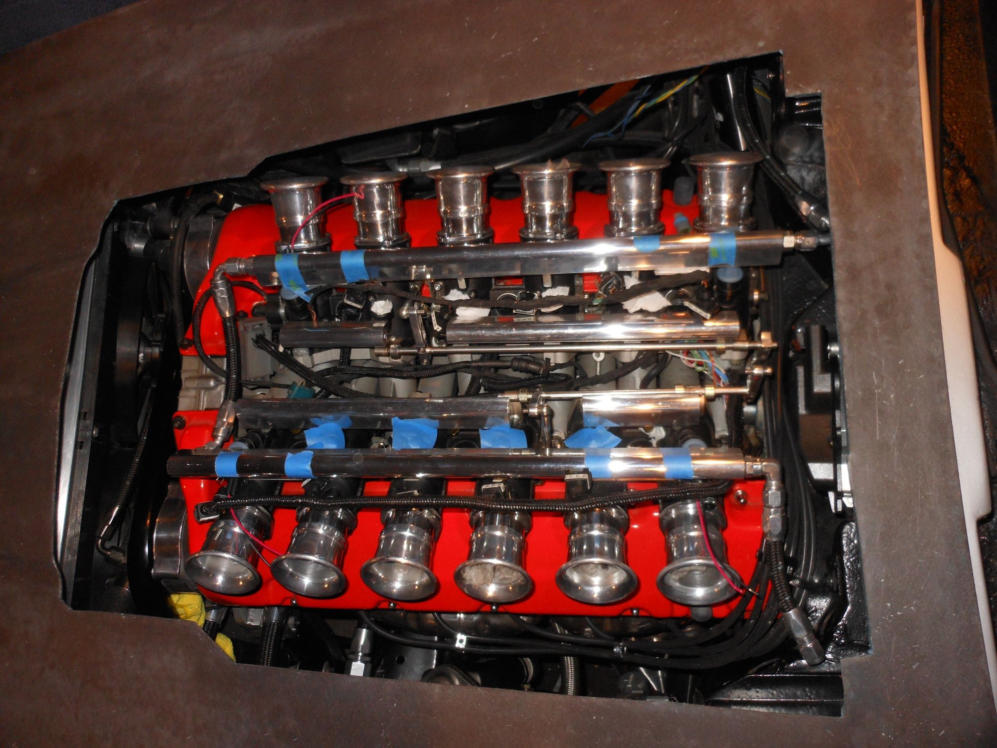

Bee Jay
Originally Posted by terrys6t8roadster
took 18 months, turned out functional, slightly heavy.Attachment 47764580
Attachment 47764581
Attachment 47764582
Attachment 47764583 next is to lower the front as it is still up 7"s. T

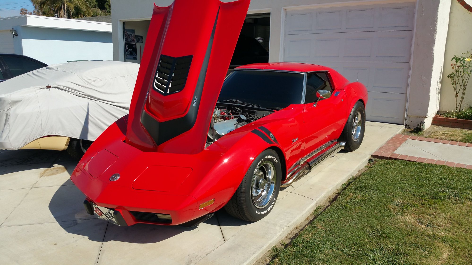

Originally Posted by f22
caveat: here are the hood vents i designed and had installed. i used 3m body adhesive tape and believe me, you can't pry it off. not everyone's cup of tea, but this is an old street racer with a lot of patina. sure lets out a lot of heat when it's standing still!
hood open and you can see how much open area there are in the vents. every little bit helps and personally, i like how they look.

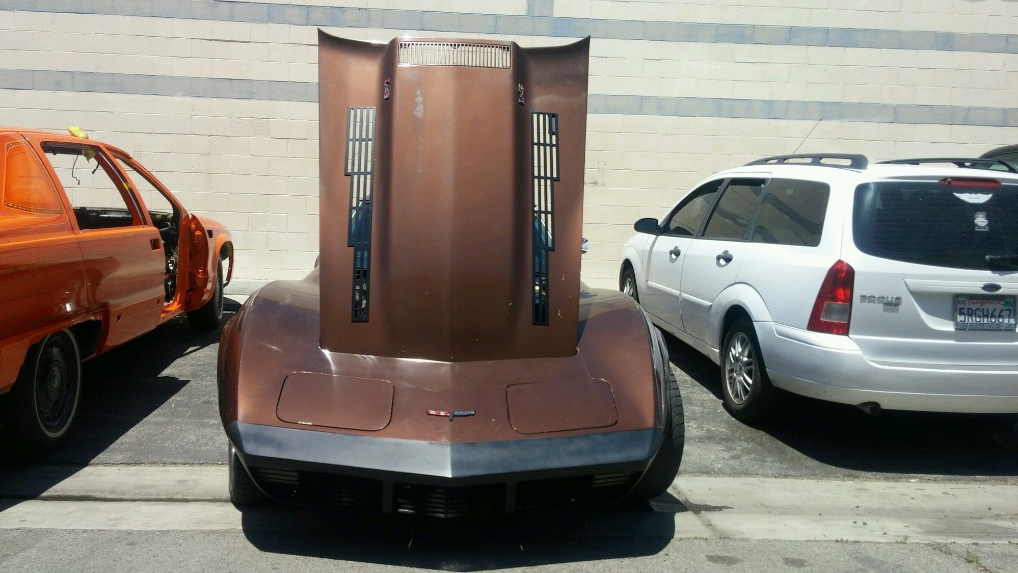

These were added by previous owner back in the 70s when he was drag racing my 68 427/400.. They still look cool today..

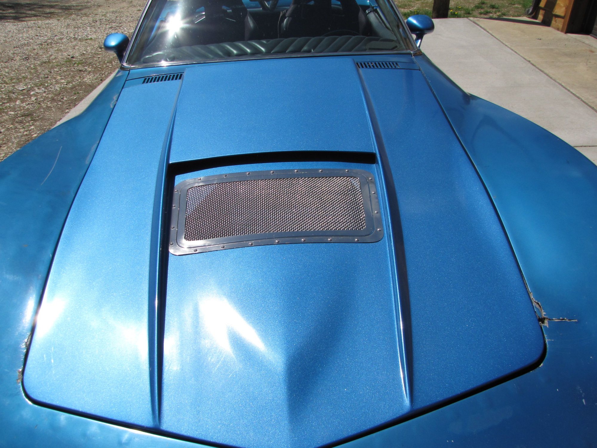

Removed this center area on my 77 hood. Not sure if it's bringing cool air in or letting hot air out but I would like to believe it's helping.
Do You Have more pics of the louvers in the hood? and where did they come from? are they falling in to the hood. Yours Erwin
Old Apr 13, 2019 | 03:15 PM
Jims427400's Avatar
Jims427400
Joined: Sep 2011
Posts: 444
Likes: 35
From: Michigan
Pretty sure they're camaro louvers except that these are open to the engine compartment. I'll get you more pics when I get her uncovered.
