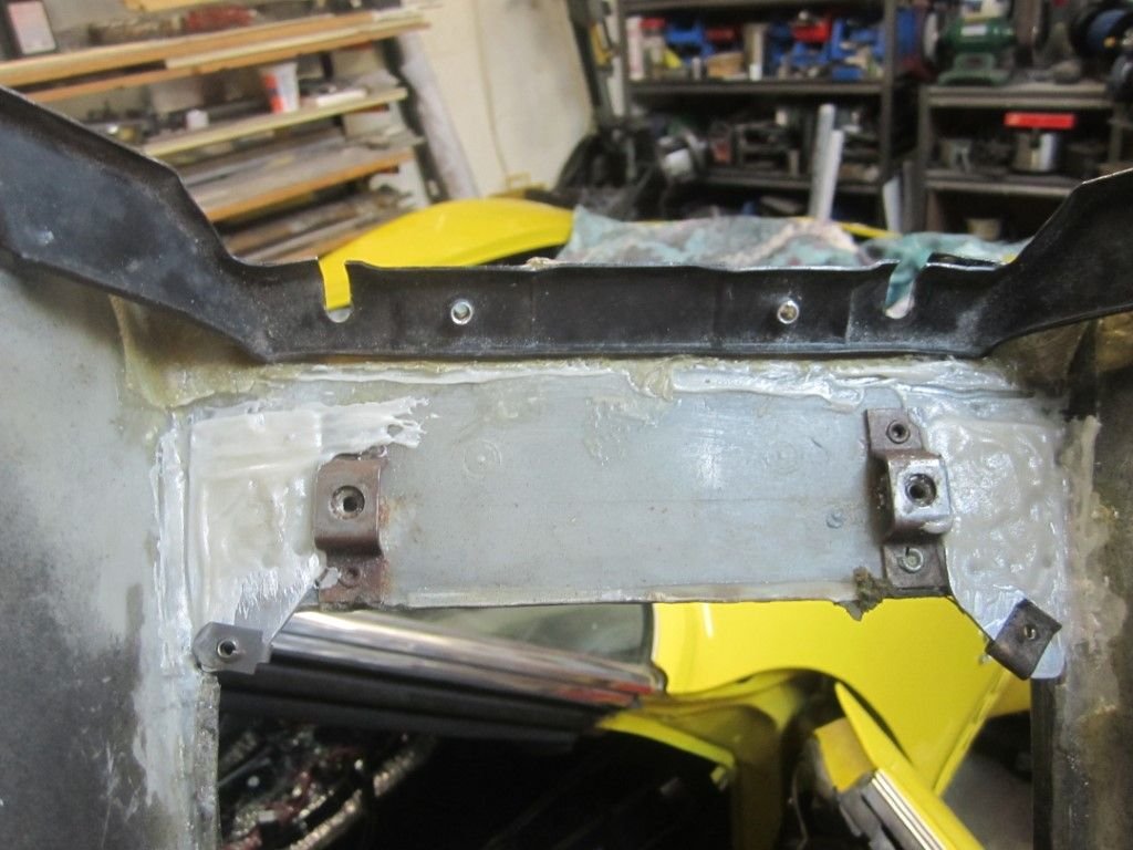

The tabs on my center console are broken off so I can't mount the shifter plate ! Anyone have any clever ideas to fix this problem without buying a new console ?

Check the vendor sites for the repair kit. Easy to do and not crazy expensive.

Repro console didn't fit right so I Bubbafied the old one that did.
A couple of pieces of aluminum, drilled holes to allow the glue to go through, scuff everything up good and JB weld under/over and around.
Let it dry and use the shifter plate as a guide where to drill the holes and install the clips that match the screws.

Some great fixes .....I can make those brackets myself ! Thanks guys !!!!
