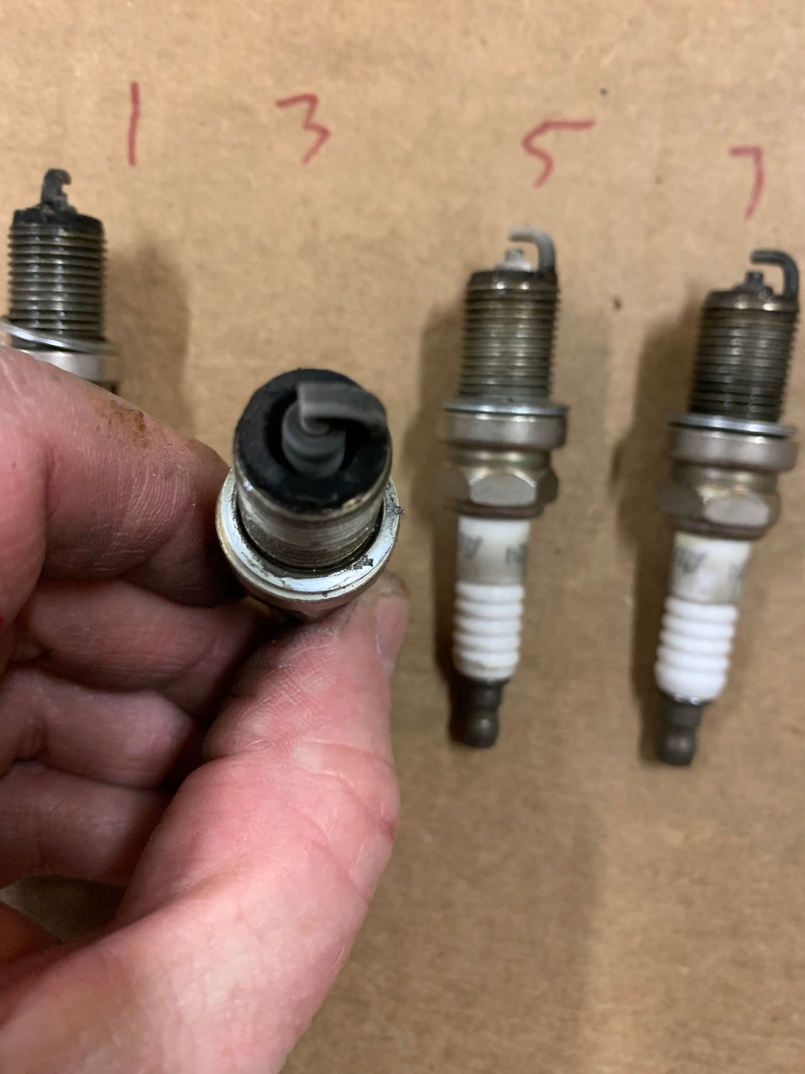

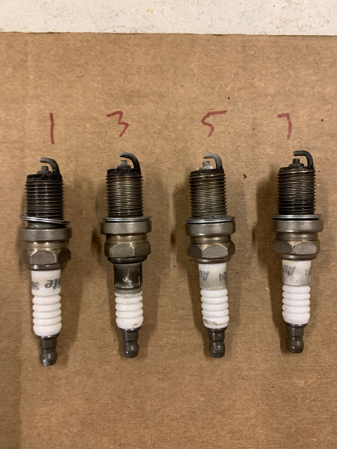

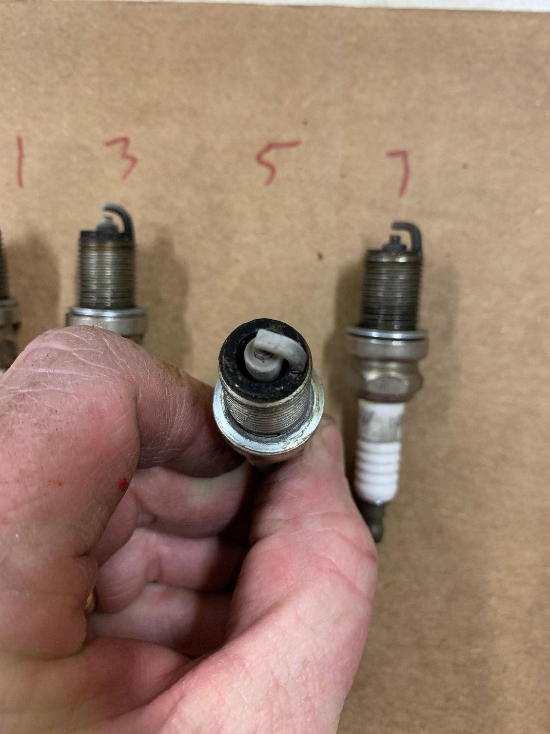

okay. Thanks for info. Here are what the plugs look like.

Originally Posted by AKjeff
Have you checked the plugs on that side?
I have pics of plugs below. Thanks
