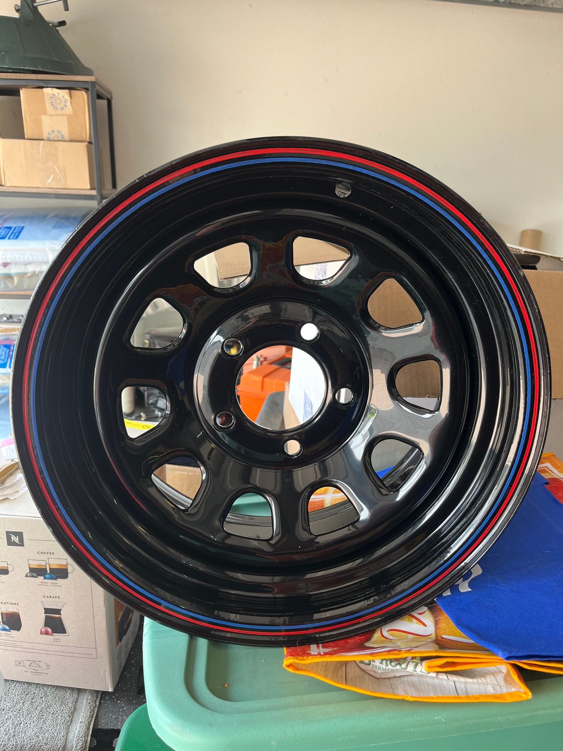

I went with the black Pacer wheels with blue and red pin stripes. Adding chrome center caps and lug nuts with a black logo. Car is Pearl white with a black Baldwin Motion wrap on it. Looks sweet.
As for the size, I just made it easy. Wheels are 15”x7” and Cooper Cobra tires are 225/70/15.

Why 7" wheels when the car came with 8" wheels?

You’re totally right. I don’t know what I was thinking. I don’t know how I messed the measurement up since I feel like I read it over 20 times, but I need wider rims and wheels. It still looks sweet and drives well, but not going to race it until I do.
Maybe the website/blog was wrong I was originally referencing…? Trying to blame anything/anyone but myself
