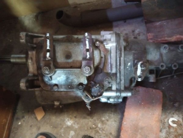

Oh man.... bummer. If I lived within a few miles of you I'd go free it up for you.... SO--- once you free it up just be careful selecting gears until you get it replaced. It can get back into this condition really easily once it gets wobbly.
I have my muncie in the garage if you even want to try I'll go take a picture of where the selector shafts are supposed to be.... if you're gonna try it just let me know.
yes take me a pic. Thanks

Here you go. I volunteered so I got off my *** and went and got the picture I manipulated the levers and turned the input shaft to ensure they are shown in "neutral". I marked them with "whiteout" to show the vertical position.

Here you go. I volunteered to I got my *** and went and got the picture I manipulated the levers and turned the input shaft to ensure they are shown in "neutral". I marked them with "whiteout" to show the vertical position.
okay. Thanks. My second one from the front appears to be towards the rear. Front one is vertical. And rear one is towards the rear. So how do you get them vertical? They won’t move.

Just use some channel-locks as someone mentioned in an earlier thread. If you have room you can even use a Crescent-wrench.... Grab ahold of it move it. Nothing terribly special. Use Jack-Stands and be careful out there.... Block the wheels so it doesn't roll when it is placed it in Neutral.
If you get the 2nd lever vertical, you should then be able to get back in the drivers seat and move the lever out of REVERSE---- try it. Less chance of it rolling onto your noggin.

He could also be hung up in 1st & reverse. The 3-4 arm(closest to bellhousing) looks straight up. OP, use a Cresent Wrench or Channel Lock pliers to get the 1-2 arm straight up. You will feel it click into place. It's the middle arm, BTW. You may then be in reverse only. Move the shifter to reverse and see if it will come out. And please don't corners on supporting the car while jacked up.
These hangups are mostly caused by being aggressive with the shifter. No need asking if you were but keep in mind. Let us know your progress.
okay so I move both levers straight up and the reverse arm in forward position. Hopped in and went through the gears (engine off) with no issues. Serial times. Someone had mention the bolts may be loose but I have tried to tighten and they won’t budge. There is a little play in those two bolts but very little. So I’m not sure why they won’t tighten. Also what’s going to keep this from happening again. May be time for a new shifter. Thanks for you help.

Good job. Told ya. Easy peasy. Be gentle until you get that replacement shifter (see offer above from other member)--- since it is wobbly you could end up in this situation again.
It's just a shitty design to bolt the shifter assembly to the frame crossmember instead of the tranny.... not to mention that comparing that Muncie shifter to a Long shifter you will note how there was an "economy" factor....
I had beefed my muncie shifter up and made it nice and snug and everything was tight...it would still occasionally lock up..... especially if I abused it.
