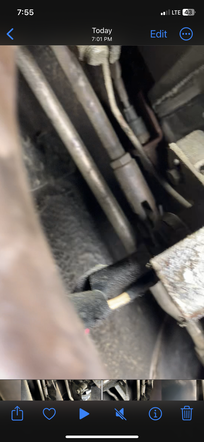

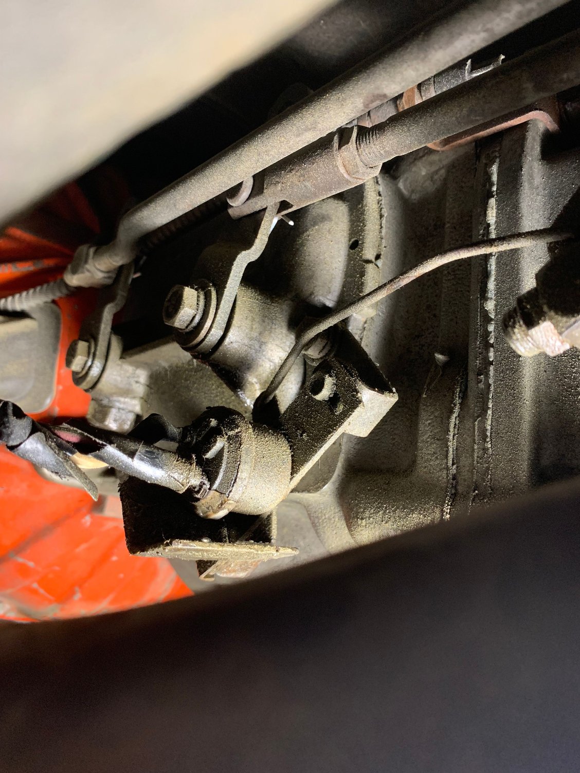

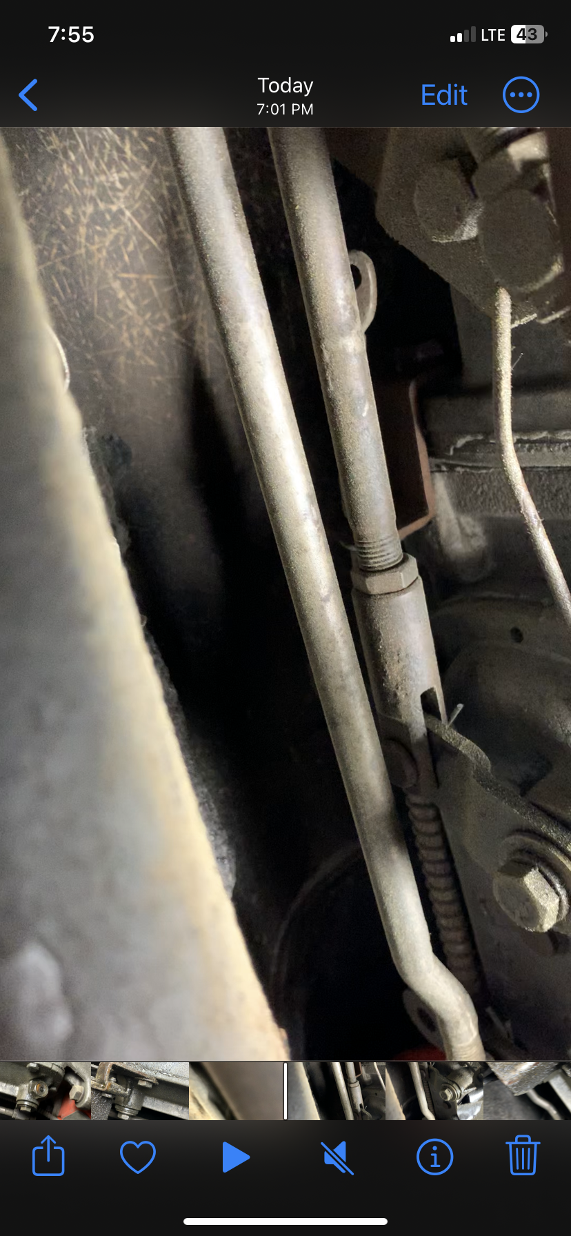

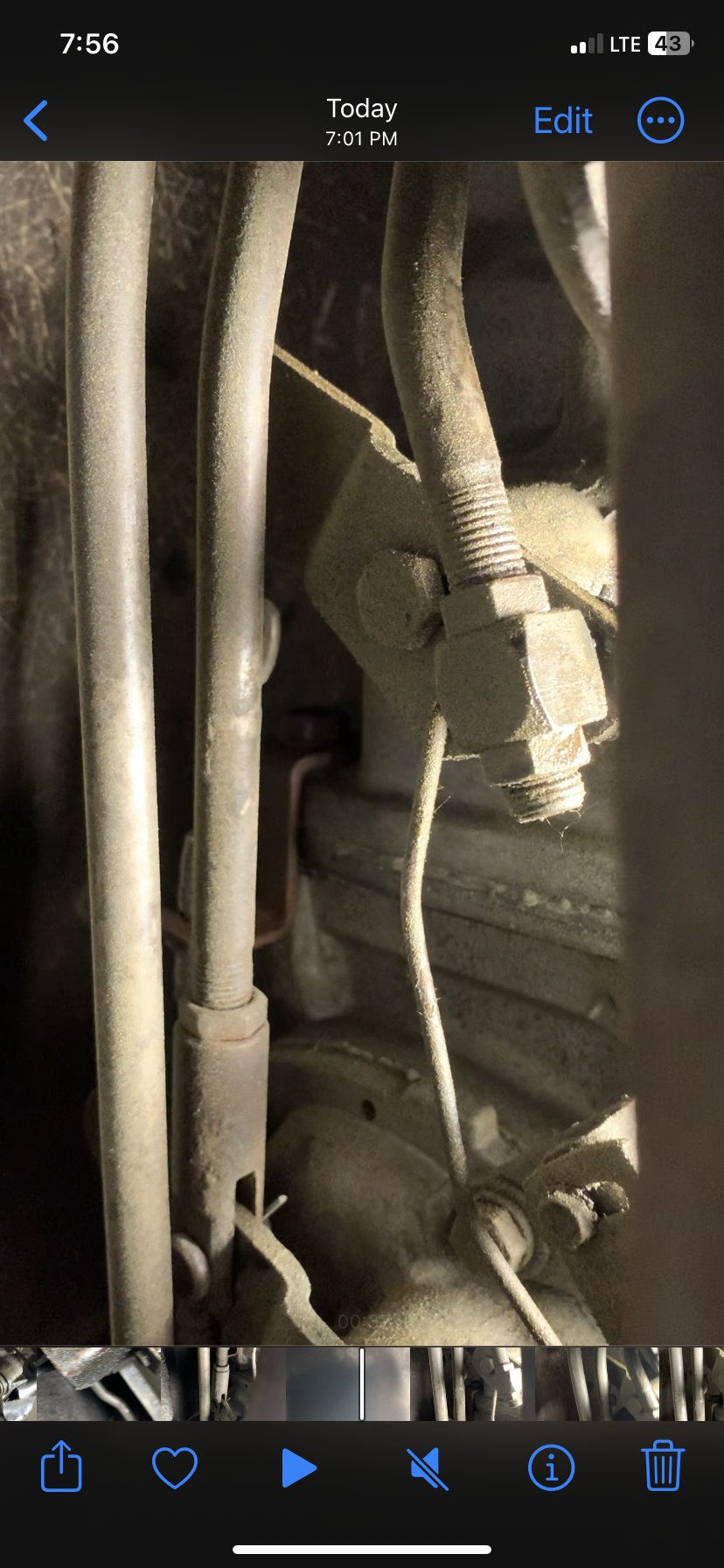

I did Jack it up and took pictures. I really don’t know what I’m looking at. Nothing appears broke. Here are the pics.

Originally Posted by 1971corvette
most likely not the clutch if you were driving it just before this happened
slide under it and check the shifter arms on trans, if I remember correctly they should all be in a vertical position = neutral
inspect the arms that come from the shifter to the trans, make sure all are connected
while trans is in neutral all the arms on the shifter should line up and a I believe 3/16 rod/drill/hex key inserts thru an alignment
passage to make sure everything is correct.
It's been a long time since I have messed with one, running a Doug Nash right now but believe the same applies.
google is your source of information, = Muncie shifter arm alignment = should give you an idea
It appears I can’t even get it into neutral. Thanks for your help.

Hard for me to tell from pic but is the arm on top of reverse switch straight up(at 12 o'clock) or leaning towards back of car? As poster above said, in neutral those 2 shift arms coming out of the side cover are both at 12 o'clock when shifter is in neutral.
You have to get under the car , put your little rubber gloves on & reach up and with your hand manually move the shifter arms attached to the transmission
into the vertical position.
on a good note the area around your transmission looks fairly clean (no oil leaks)
the pictures were taken to close to really see anything
looks like 2 arms, the middle & the rear are NOT VERTICAL
Yea. The pictures arent great. I really cant lift the car very high. I will try to move the arms tonight after work. Thanks for your reply.
