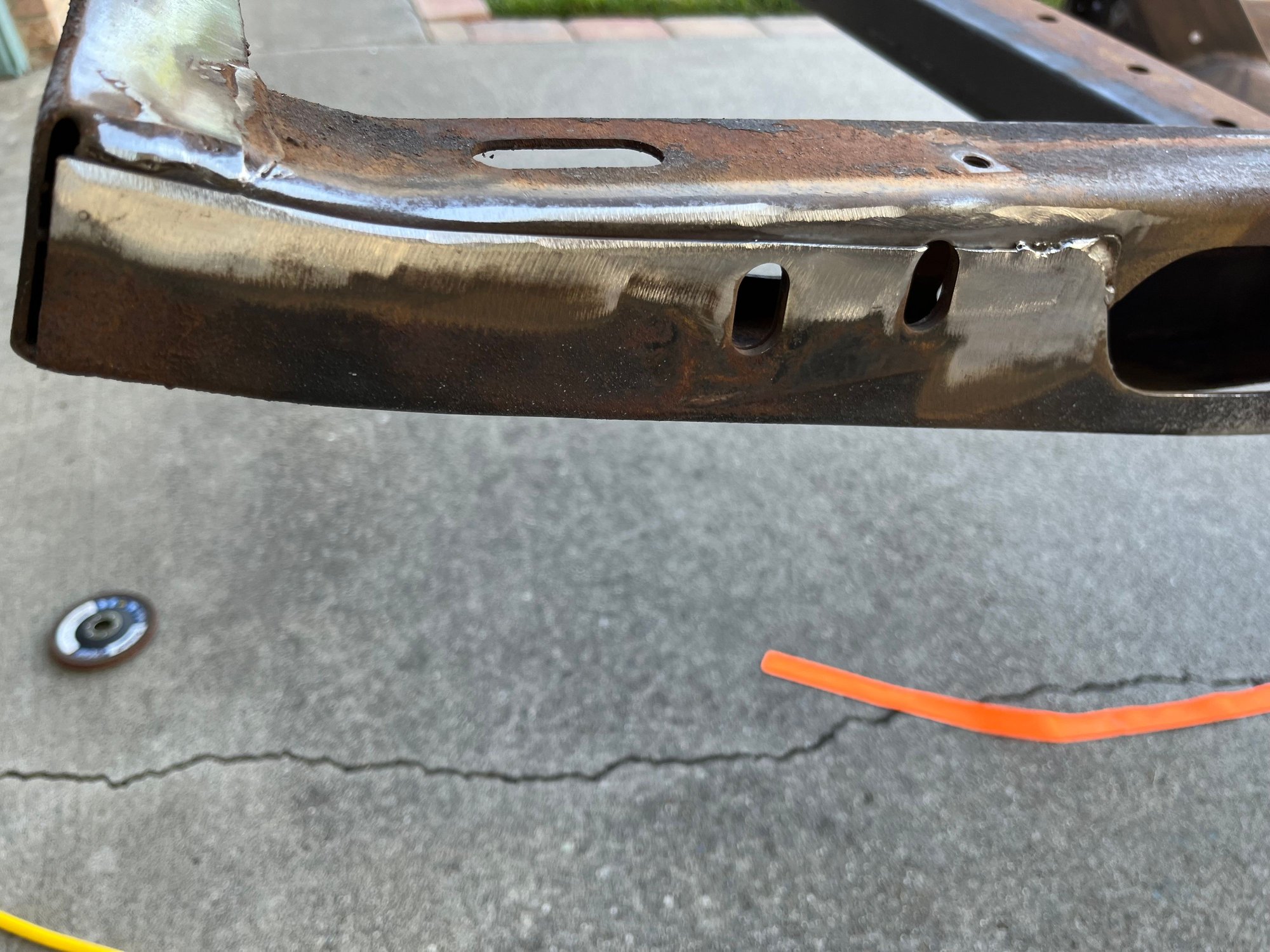

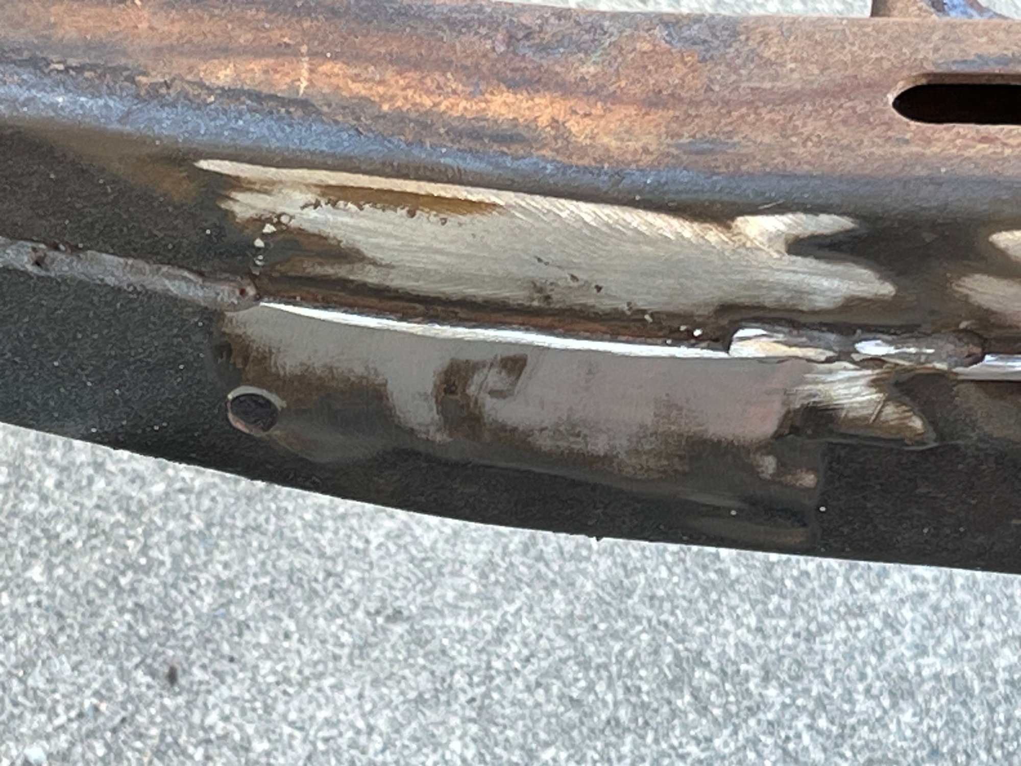

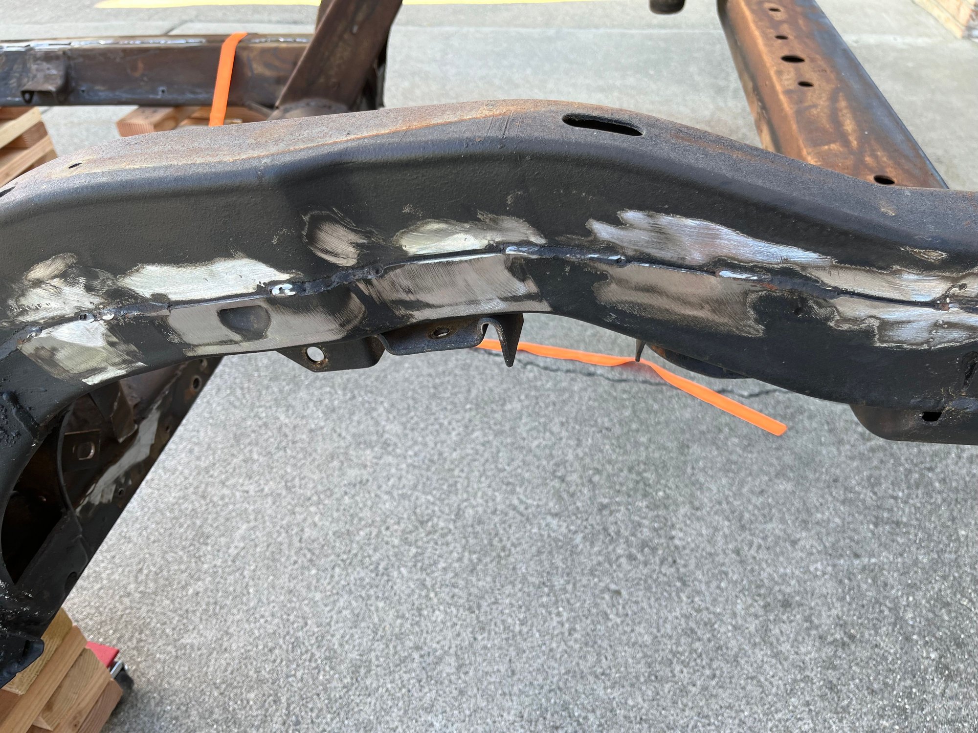

Today I moved the frame out onto the driveway and started cleaning the metal where I need to complete the factory stitch welds.
I found it is nearly impossible to get down into the seams of the frame to clean the metal.
Am I overthinking this?
Does it need to be shiny bare metal down into the seams, or will the heat and weld take care of this slight bit of old paint and contamination?
Is this good enough?

Those are tough areas to get clean. If it were mine here is what I would do. I would hit it with a wire wheel on a die grinder etc as best I could, clean it really well with brake clean, let it dry, and send it. Don't put any heat to it until the brake clean has fully evaporated, you'll literally possibly poison yourself if you ignite some brake cleaner and breathe it in.
Now how it should be done. Technically it should be 100% bare metal which a wire wheel and brake cleaner won't get it to. The only way I can see you getting those seams 100% clean is using a media blaster of some type (glass or sand). We'll debate whether all that is necessary but if you want to be 100% by the book that's the way it should be. I'm sure others will have varying opinions, but that's mine.

My powdercoater sandblasted the entire frame BEFORE I welded .. which completely cleaned it for welding....and then after it was welded, the powdercoater sandblasted it again. He did not charge me twice, because the second blasting was quick. Total cost....$600 for all blasting and powdercoating. Its worth every penny. Nothing preps the frame better, and nothing better than powdercoating. You have seen the pictures of my frame......its perfect.

Yes, the cleaner the better, no argument; but it is good enough? If your intention is to weld the seams to provide something better than as provided by the O.E.M. originally? It'll take a little more heat to burn off the residual contaminate material, and more filler material to float that that remains out of the juncture of the bond, and that contaminant is not going to allow for as pretty a weld in the end, but you will be able to bond the two surfaces together just fine.
Now, if show quality welding result is expected, something you can show all your friends and dare anyone to do better, then no, it's not clean enough! Get it sand-blasted, at least the seam area you plan to weld, and then scrub that clean (stainless steel wire wheel brush) as the residual silica is still a problem.

Is it clean enough? Well we didn't even get all of the powder coat off
So I would say yep

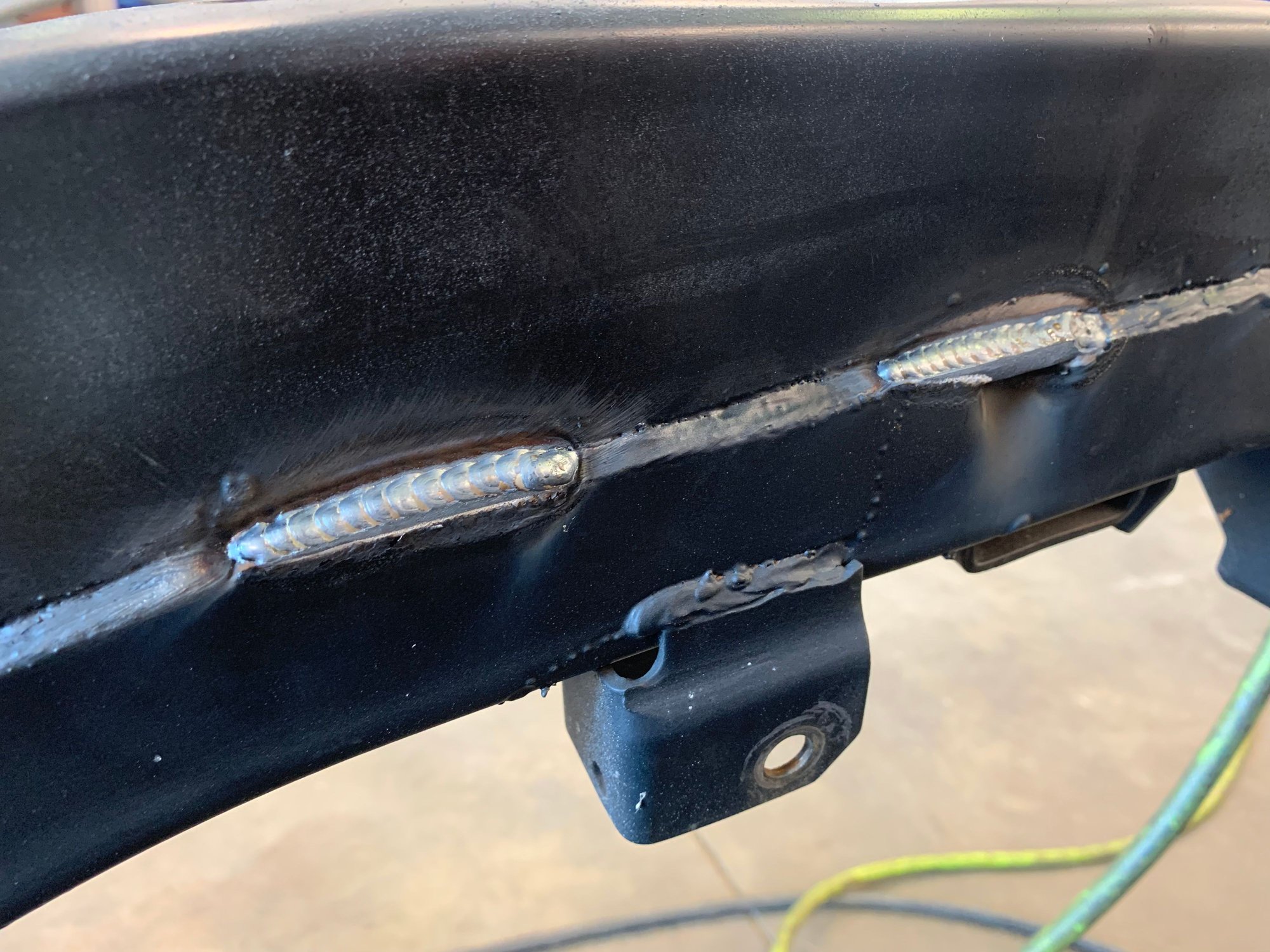

If you can weld in the garage/shop with no wind solid wire all the way. Flux core if have to weld outside with wind issues.
Good auto darkening welding helmet. Also if needed a pair a cheeter glasses.
And again if needed a really good light on the weld area helps a lot.
The pic above of the welds weren't done buy a rookie. Very nice.
I can see that.
I’m sure mine won’t be all that pretty.

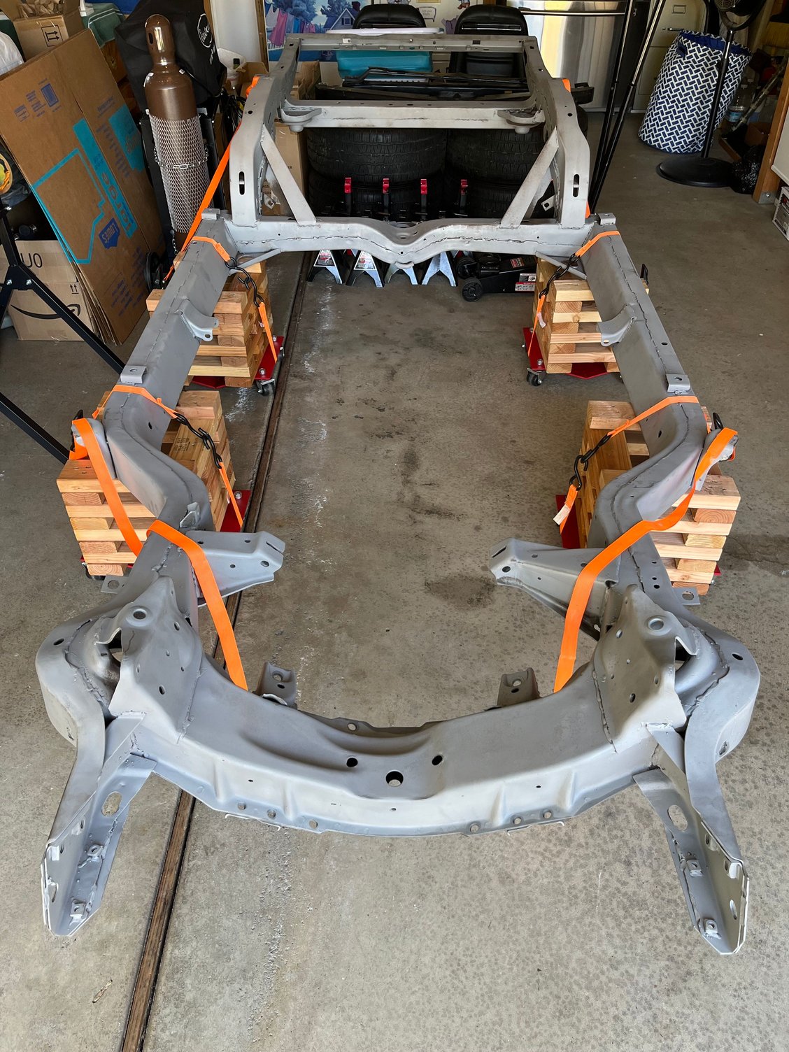

Today I brought the frame home from getting sand blasted.
Now I can start welding.
