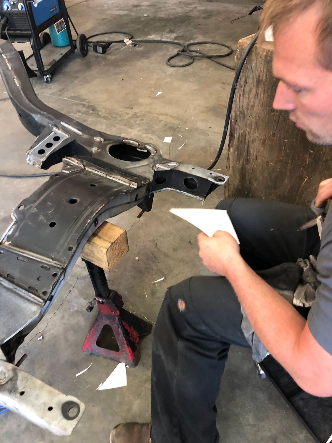

I will ask the master when he gets back from the race
Old Aug 13, 2023 | 10:16 PM
Bandit54's Avatar
Bandit54
Joined: Jan 2013
Posts: 753
Likes: 111
From: Barnhart, Missouri
That is some beautiful welding
Old Aug 13, 2023 | 10:23 PM
reno stallion's Avatar
reno stallion
Joined: Apr 2013
Posts: 3,483
Likes: 1,823
From: McCloud CA
C2 of Year Finalist (appearance mods) 2019
You should see the tig
