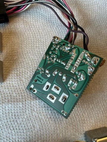

Got this thing apart, don't see any obvious burns or broken solder joints. What usually fails on these ? Is there a way to get 2 speeds and the washer pump operational ?
