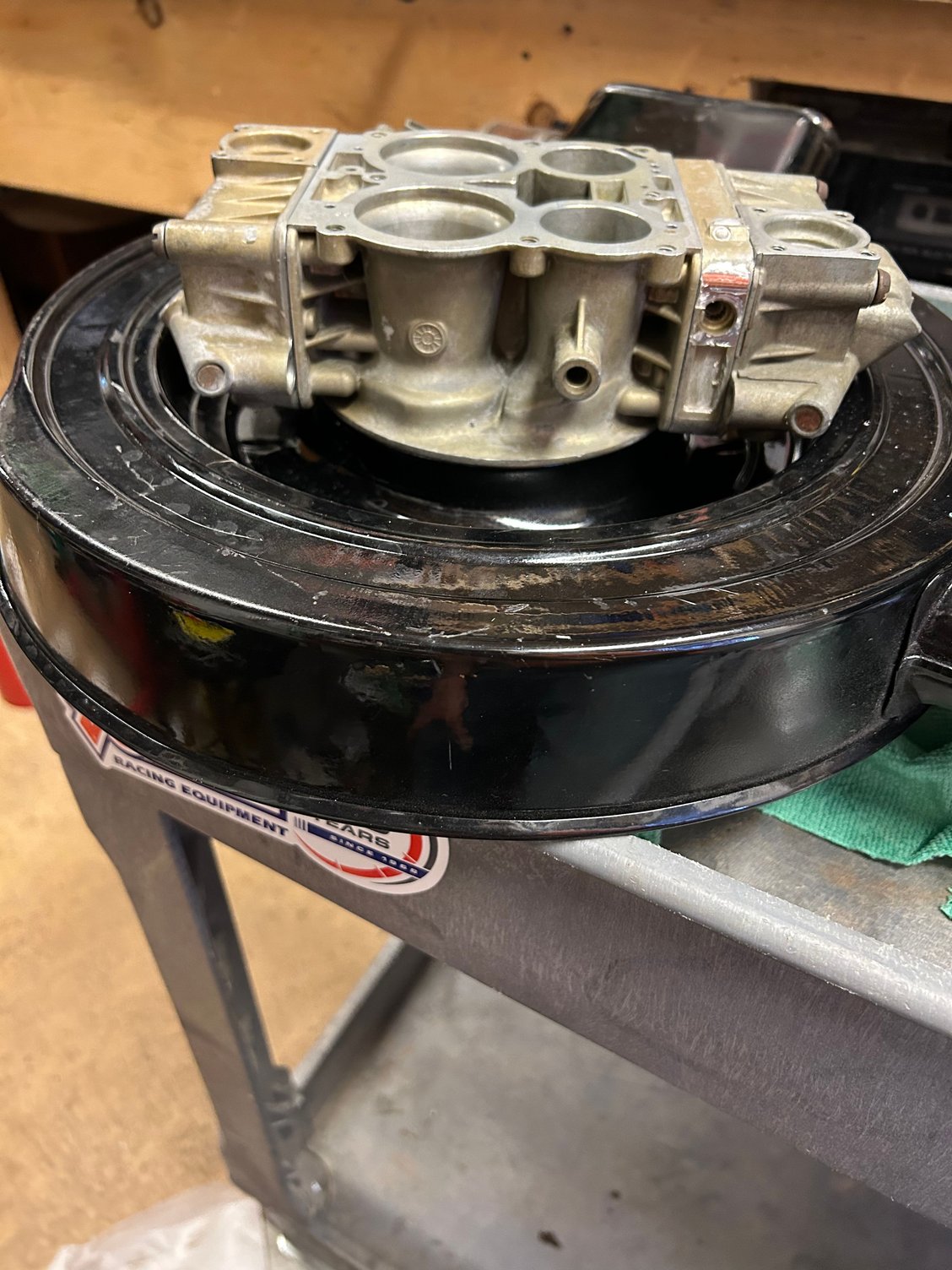

Will this holley work with the a stock dropbase air cleaner?
You will most likely need an LT-1 style base.....it has ears on it to clear the float bowls.......a lot of cheap aftermarket ones do too.....I believe the old stock twin snorkel air cleaners have a Q-Jet cutout at the airhorn that isn't full round.....it has a small ear on it to hug the Q-Jet airhorn to locate it.....

Old Oct 27, 2023 | 01:15 PM

Early C3 Stock twin snorkel Q-jet air cleaner assemblies are crazy expensive for some reason, and out of stock.
I wanted to get one to replace the aftermarket assembly on mine, but I might just have to go with the open style.

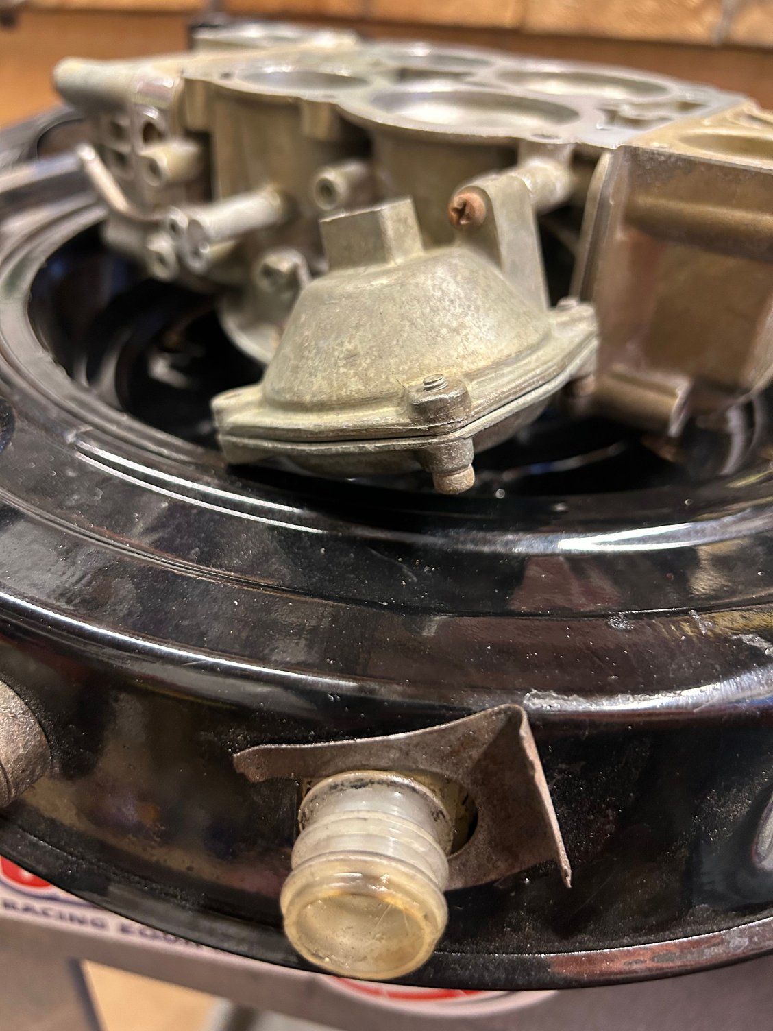

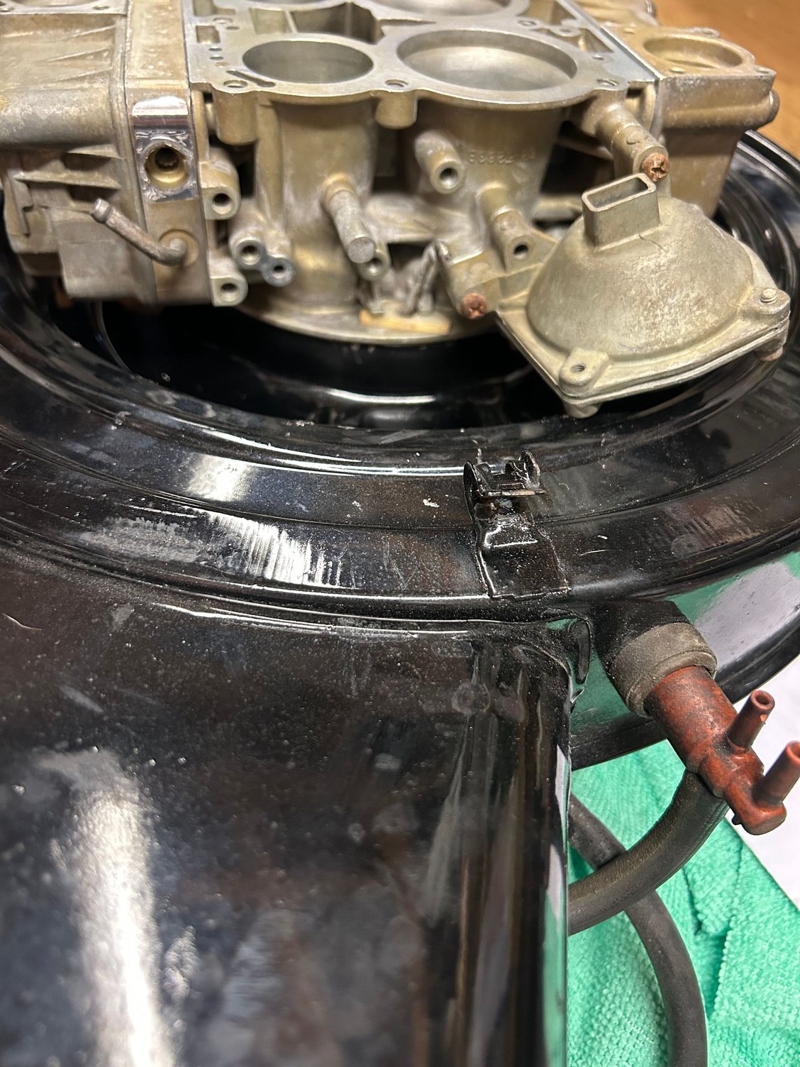

Likes: 475
it’ll work. only thing is i need to is make room for secondary screws.
Old Oct 27, 2023 | 08:32 PM
speedreed8's Avatar

I did the same thing I added a extra top round gasket to the top of the carb and gave me the extra clearance for the secondary spring holder.
Mr. Gasket (I think?) makes a air cleaner spacer kit with 3 or 4 different height spacers that you can also stack if you need it to get the right height.
