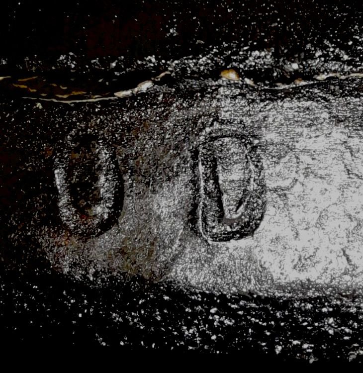

I'm just a bit confused by these numbers on my diff.
perhaps you numbers guys could decipher this.
Looks like OD 21 8 W. 71
I'm a bit confused by the 71 on the end. My car was built late 76.

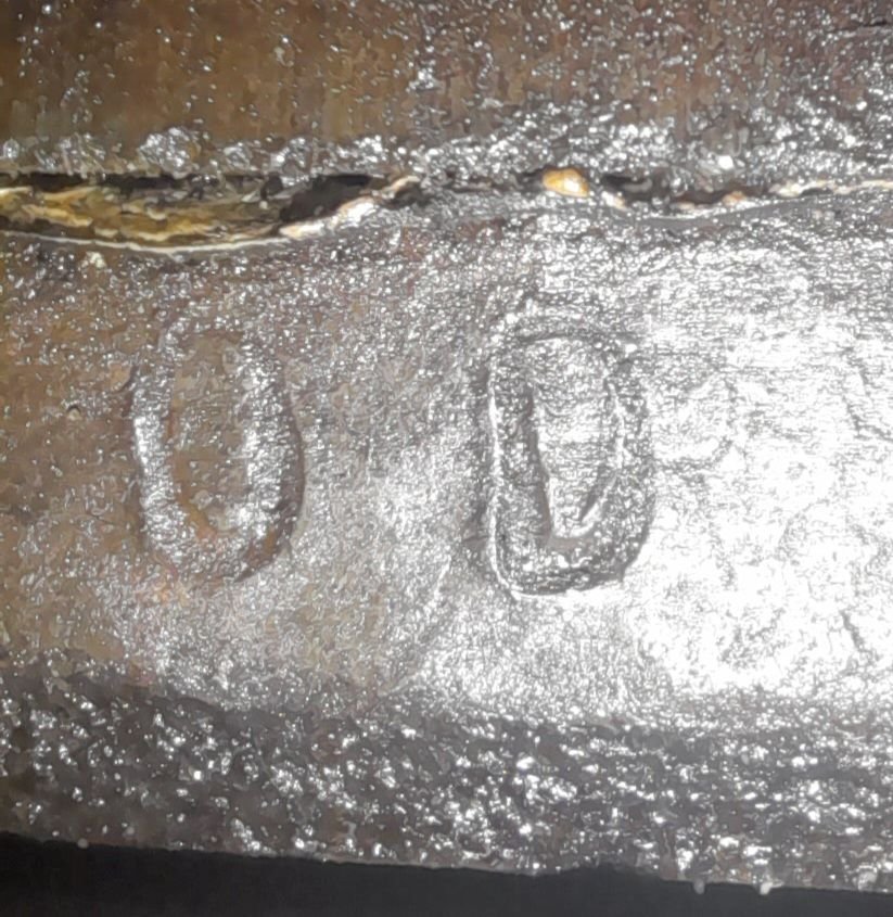

Closer shot of the 71.
And a close up of the OD

OD = 1976-1977 code for 3.36 ratio, 218th day of the year, Warren plant, 1977, 1st shift
The 71 isn't 1971 its 7 for 1977 (just final digit of year) and the separate 1 is for the plant shift.
This is my interpretation based on others I have decoded but I'm not familiar with any idiosyncrasy of the 1977 model year. The OD code was used for both years but it's interesting that they also used an "LR" code for 3.36 ratio for those years. Yours has an underlying "R" so maybe a restamp OD over a previous LR code? Maybe LR was more common during the 1976 production and OD for 1977? Someone else should know better than I.

is that an R under the D?
https://corvettec3.ca/axle.htm

OK, I understand what your saying about the numbers. But if my car was built late 76. Came off the assembly line on the first of Dec. The 218th day of the year makes perfect sense. But wouldn't the code be a 6 instead of a 7? Or did they stamp them for model year?
Sure looks like it. Perhaps an error at the factory?
