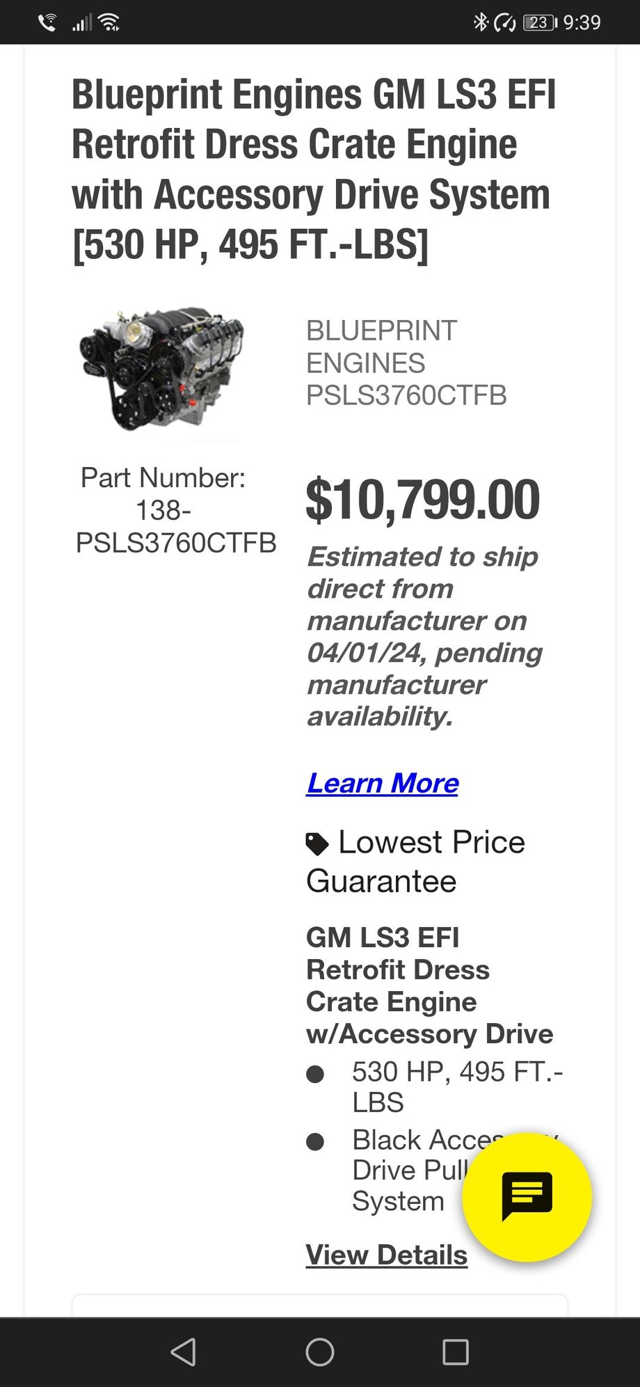

Wondering if one of these will fit under the hood of a 73 L82. Thinking if getting a new 5spd too. Something modern but I don't want to modify the tunnel. Any suggestions. This add is from jegs, American dollars but seems reasonable for that kinda power. Has everything except a cpu. Can use a Holley for that or the sell them for around 1500.

Should fit OK. A carbureted setup won't. Plenty of people have done thsi

Ya I get alot of people do it . It's the number of options available. Jegs had over 50 engines to choose from. All ls3. Also part combinations. I want a complete set up. Make it fit and go. This is the only complete unit I could find with an a/c pump which I need. Really want something I don't have to modify the car. Motor mounts and metal fab is easy. I don't want to get into body and paint. So want a bolt in engine and 5spd that doesn't require body mods.
