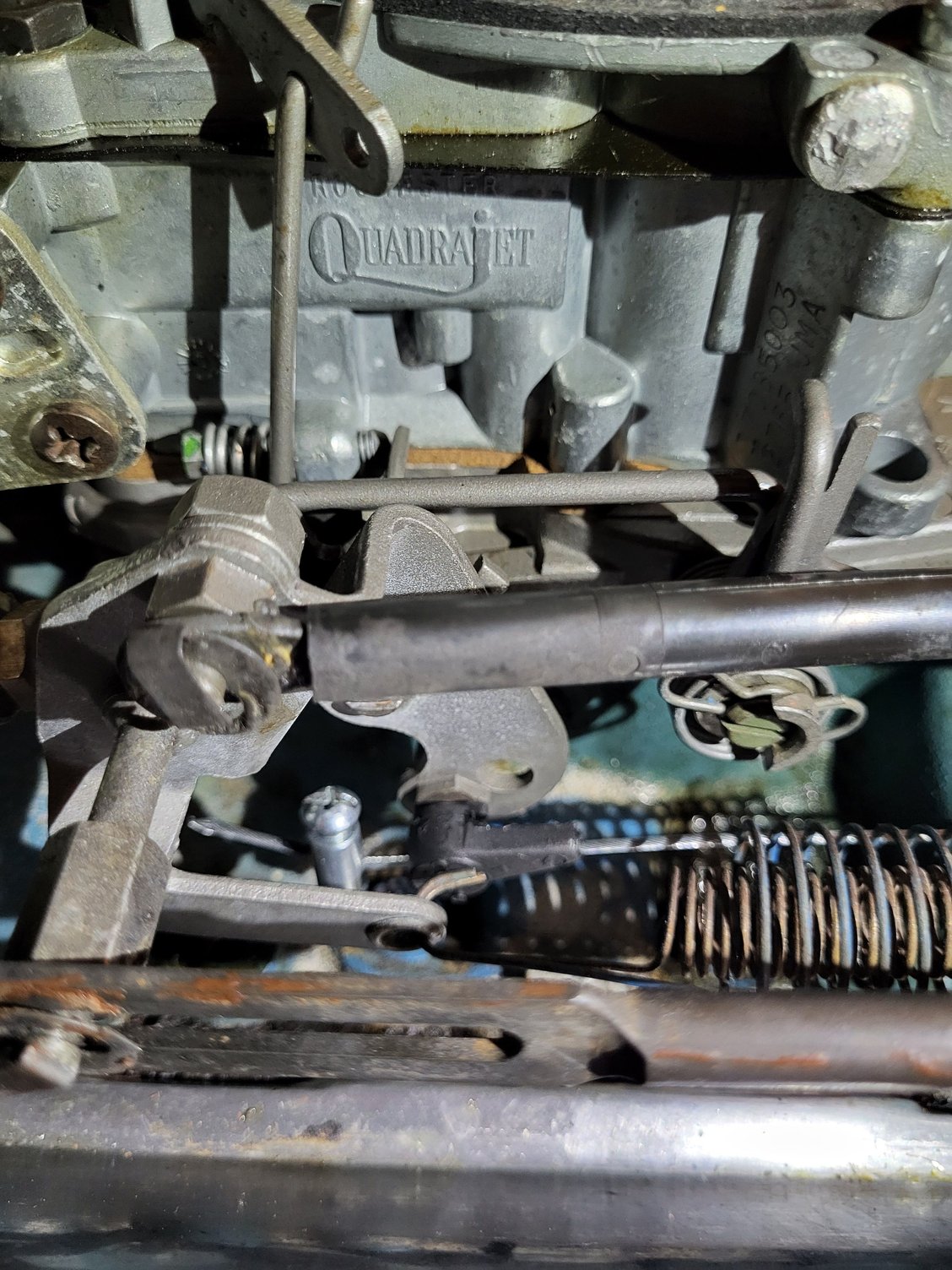

Do you have the correct location for the TV cable?Here are pics of the correct hook up point geometry w/adaptor for QJ. Phillips head is original location.Stock location will burn up trans

no I have a different configuration and should be correct, supposed to be the same distance behind the pivot point as the throttle connection is in front of it

Looks like its in the right location.

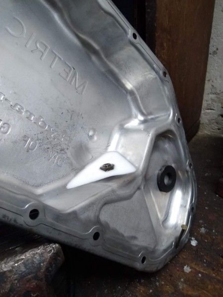

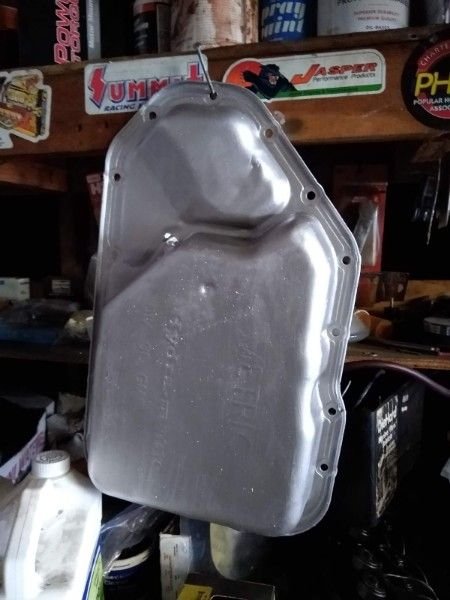

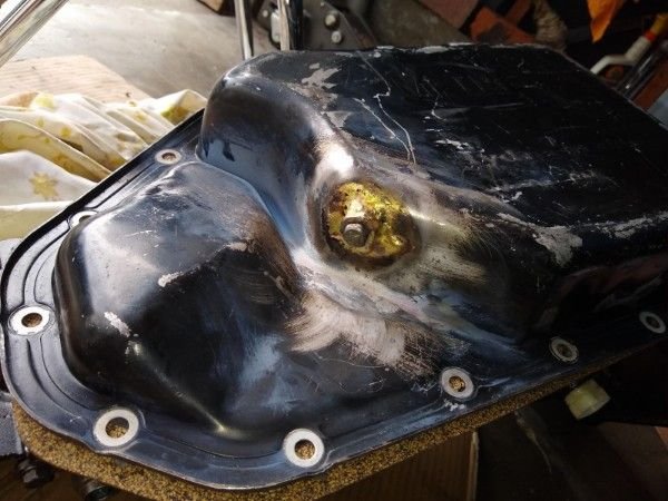

Below are pics of where I installed mine. I did not want it hanging any lower than the already low pan. Out of the way and works well. I only brazed the outside because I had my oxy-acetylene rig already out..... no need to do it really.

I tried several different 700-R4 filters from different models. I couldn't get any of them to fit without having to modify the tubing on the 200-4R so I'm just using a regular 200-4R filter. Cost me money too because I ruined 1 or 2.
