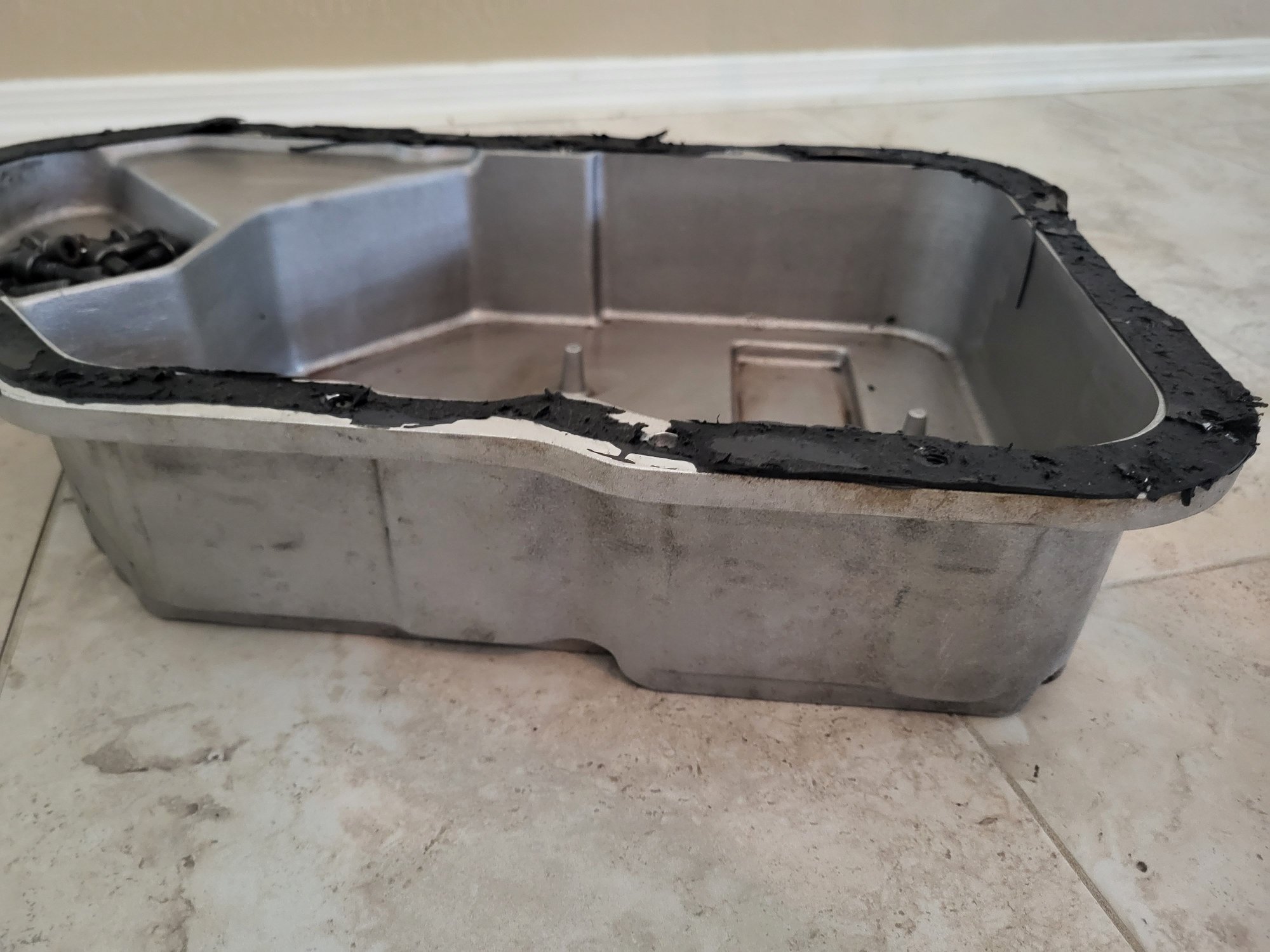

Originally Posted by Kevman72GT6
I just drilled a hole in mine large enough for the two springs to fit, simple enough.
thanks Kevman, I did the same as the pic above, worked well, got it all set up but haven't adjusted yet, pulled the pan to see how it functions, will have someone move throttle back to grab just a little tension on the pump to get started.

Additional question, I have a Hughes deep finned pan, anyone with experience with clearance issues, while it's off should I be looking for a standard capacity trans pan

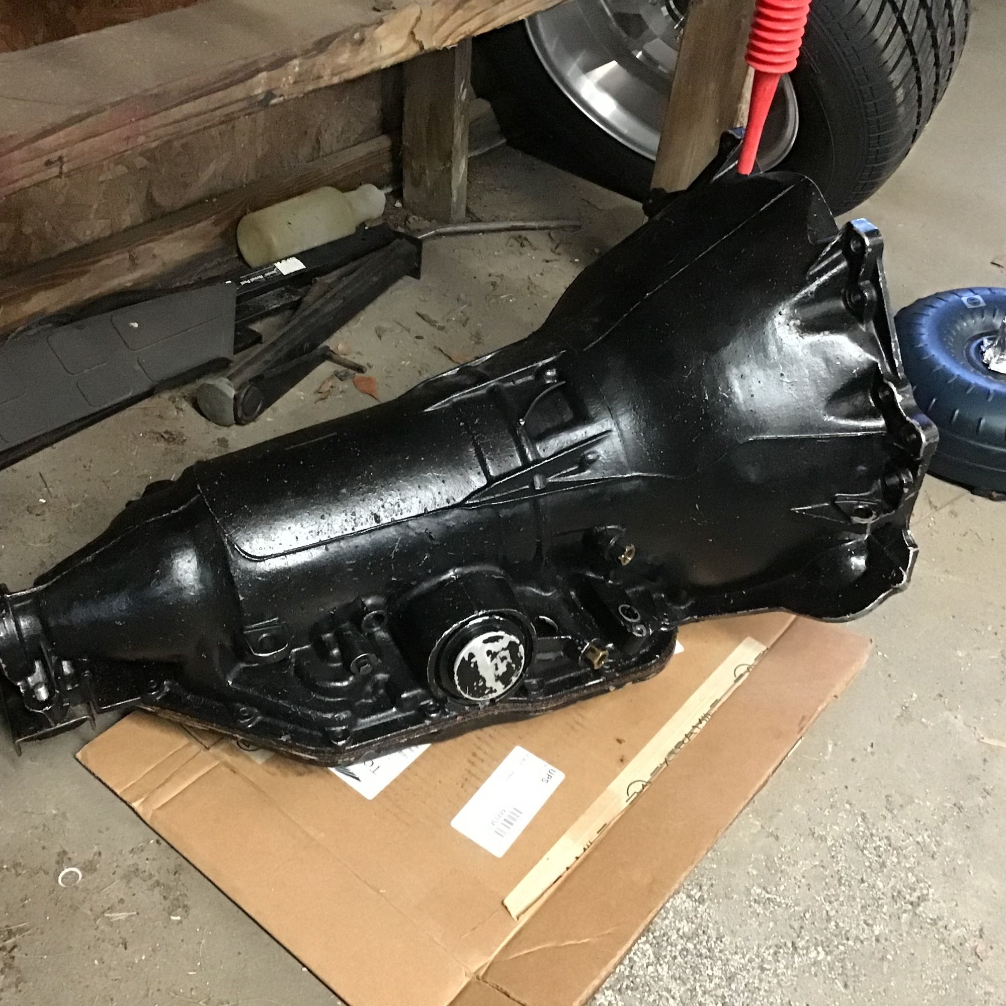

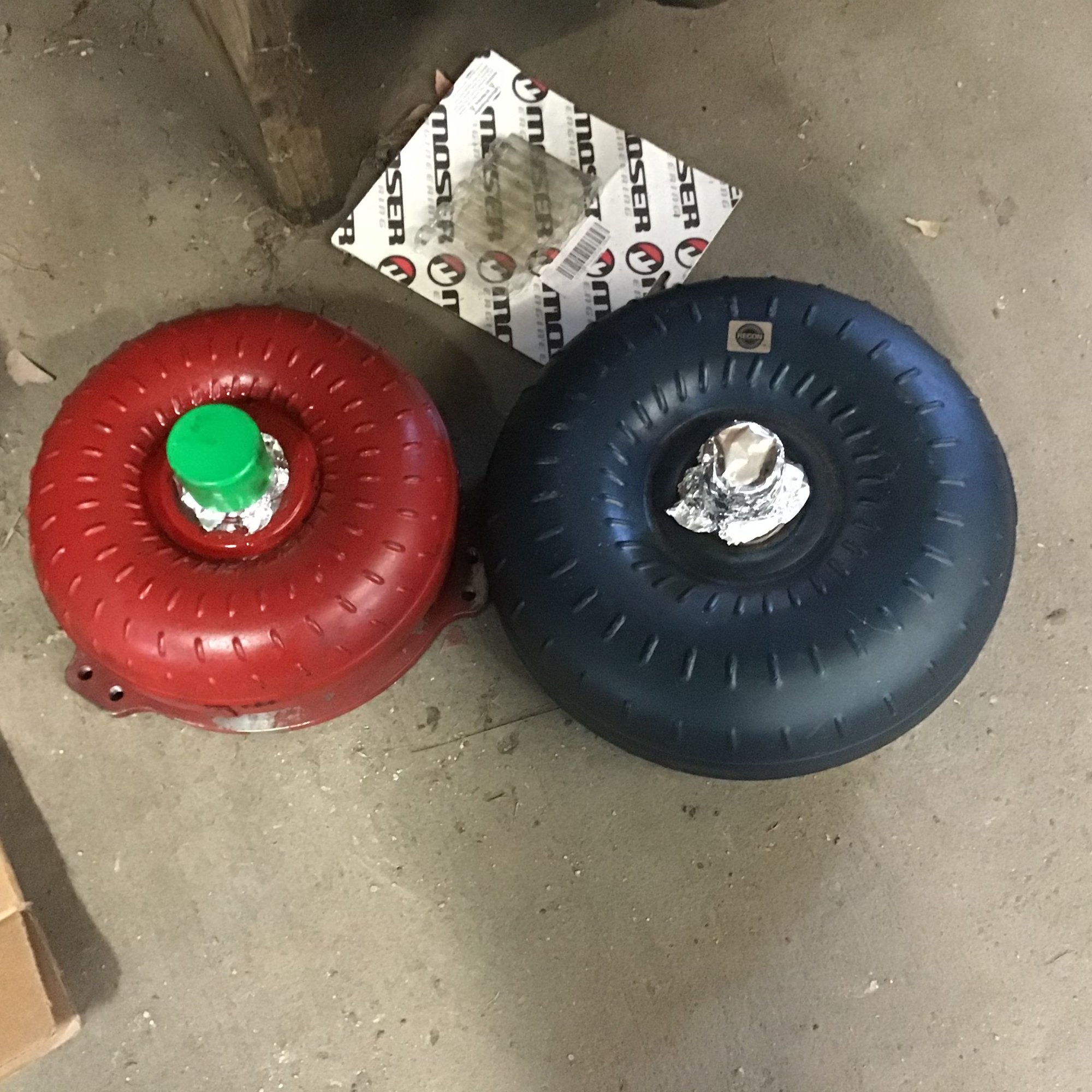

Golfobsessed,I went and picked that 2004R yesterday,for 600,it still looks new,he said it has less than 100 miles on it,he also gave me 2 TQ and cable he said nothing is wrong with it,seals look new,pan gasket new,lol....not sure what to think,just glad I went and got it.
Blue one is 2200,red one is 2800.
that does look clean... are you gonna install that one?
could be a home run if all good, a quick drop of that pan to see if there allot of black soot at the bottom of the fluid might tell something, maybe ready to install as is

Yeah. I would drop the pan anyway and take a look. Install a drain plug while at it. And since I'd have the pan off do the borescope tv adjustment.
Even if there is black soot this would give you an opportunity clean it up, install a new filter, get a picture of the valve body, do the drain plug, and the borescope adjustment..... lotsa bennies to dropping the pan now.

Golferdad's Avatar
Golferdad
Joined: Feb 2022
Posts: 988
Likes: 183
From: South Carolina
Yea,this is the one I will use,and yes,definitely drop pan and check it out,yea definitely looks good.but will know more later,hows yours coming.
