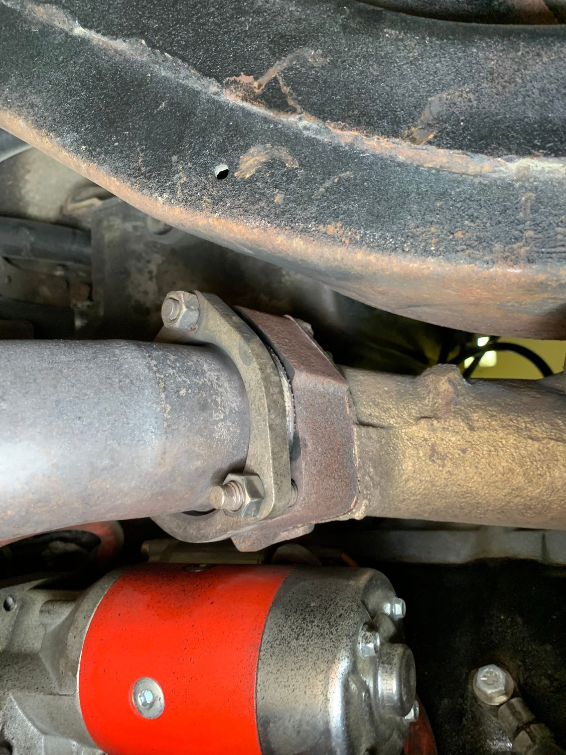

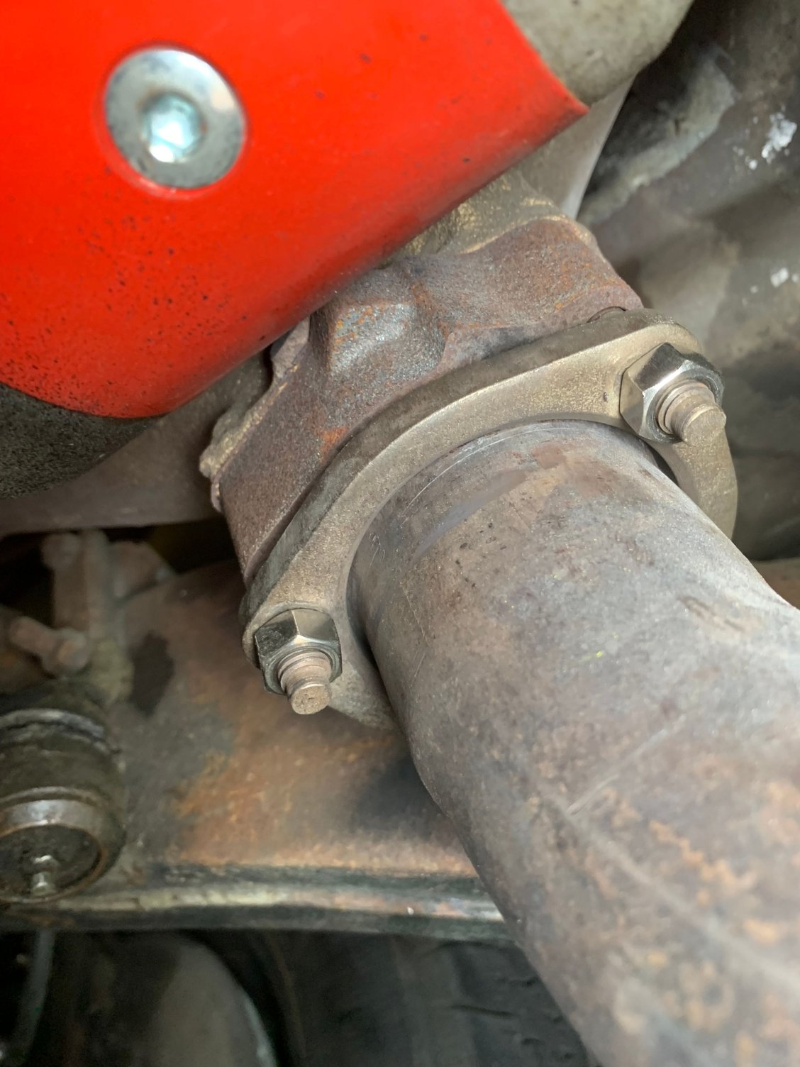

You definitely have an exhaust leak at the heat riser. You need to find a local exhaust shop to make you a new piece of tubing going to the manifold. Throw the heat riser in the trash.

Thanks for posting photos!
So, no TVSs are present.
Do you happen to know the part number for that intake? Your carb has an electric choke, and it looks like the vacuum advance hose feeds under the intake (like an LS intake).
Is it this?
https://www.edelbrock.com/rpm-air-ga...fold-7561.html
Originally Posted by Edelbrock RPM Air Gap
... No provision for exhaust heated chokes and no exhaust crossover.
With no crossover, the passenger side exhaust has nowhere to go if the heat riser valve is closed. Two pictures, and we found your problem.

yes that’s my intake. So if the heat riser isn’t hooked up do I need to remove it?
It never should have been installed at all with that intake. It blocks the exhaust from that side of the head, which then has nowhere to go but make a ticking noise as it blasts through your gaskets.
Can you get a picture of the other side? There's a bi-metallic spring that heats up and opens the valve (and closes the valve when cool). Perhaps it is already pinned open.

Thanks for the additional photos!
That's a spacer, not a heat riser.
Good to confirm with photos. The exhaust leak may still be present, but the heat riser valve is not the issue, since you don't have one.
