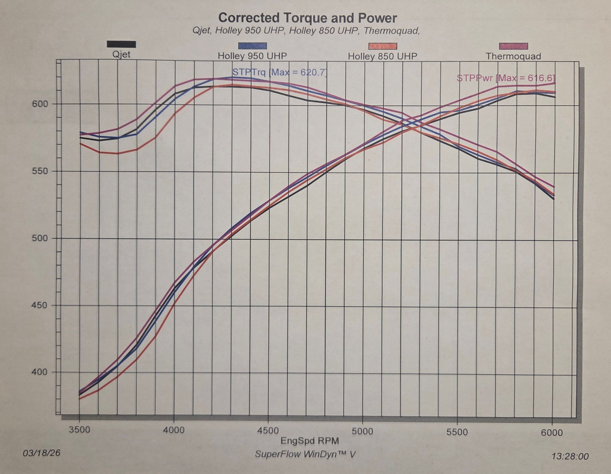

Here's a much better comparison. My Qjet made within 2 hp of a Holley 950 Ultra HP (80805 with 1.60" venturi and 1.75" throttle blades). The AFR for the Qjet was around 12.4 and the 950 was about 12.7. The 850 Holley was swinging for the fences at 13.7 AFR so it's not really a valid comparison.
Here is the Qjet pull, or maybe the one after:

Outstanding post! The dyno graph just shows that for my seat of the pants, I probably wouldn't be able to tell any differences among them and that the regular ol' QJet is a fantastic carb running with the best of them — especially in the street RPMs up to 4500.

Thank you. Yes, set up properly, one would never be able to tell the Qjet from the others. Except it would get better gas mileage!

What size Thermoquad was in your test ?

It started out as a production 6322S so was 850 CFM. I removed the venturis from the primary plastic bowls. Also added a rear air door stop adjustment screw. Still has both primary boosters so I would guess cfm is probably somewhere between the 850 comp series and 1000 CS.
