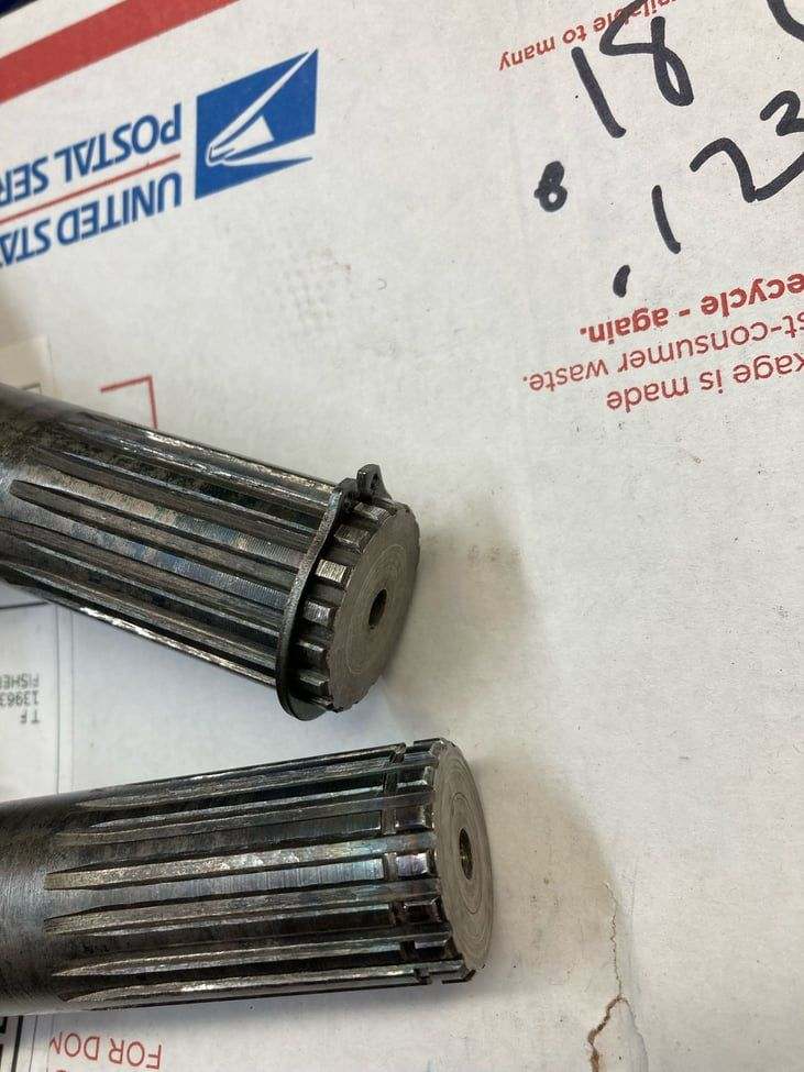

Hi, novice question here, I am having my diff rebuilt by a recommended "expert" who is asking why there's no circlips on the end of the yokes he removed, apparently there was a burr on the end, am I right in thinking the ends of the yokes have worn away? And need replacing.
I should have also mentioned I am in the UK. But didn't think this was relevant as to whether the yokes were worn or not???

Yes those are worn away and the new ones are hit and miss as far as quality and hardness.

No 'expert' would be asking why the clips are missing.
Get the unit back and send it to Gary.

Your expert appears to have never worked on a C2 or C3 differential. Did he remove the differential or you did. If he did, you at the very least need to get him a shop manual. If you did, get the differential back and find someone else in the UK or the continent.

If that is the question he’s asking, find another person to do the work.

Yeah you're going down the wrong road.
Here is a question you can ask your expert. Now that you know you need axles, what will you buy- New or Rebuilt- tipped or cored? If you just go to a website an order blindly you may be going down a second wrong road. I have explained about axles for years on various sites, I am getting tired of doing it and the quality is not, repeat, is not too good today.
All I will say is when I finish a diff, there is 005-007" endplay in axles I inspect and address. Rarely are they the type I questioned above and if so they are checked for various things. I went a different route after averaging a 50% rejection rate with the axles I purchased.
Good luck, bad work is bad work, it doesn't matter if it's in Europe, Australia, New Zealand, or the good ole USA.

Yikes! I wonder what the gear fluid looked like with all of the ground material floating around. Must have done a job on everything it touched. Jerry

This distance above the snap ring groove should be at least 0.185", even after 100k miles, as on these axles.
