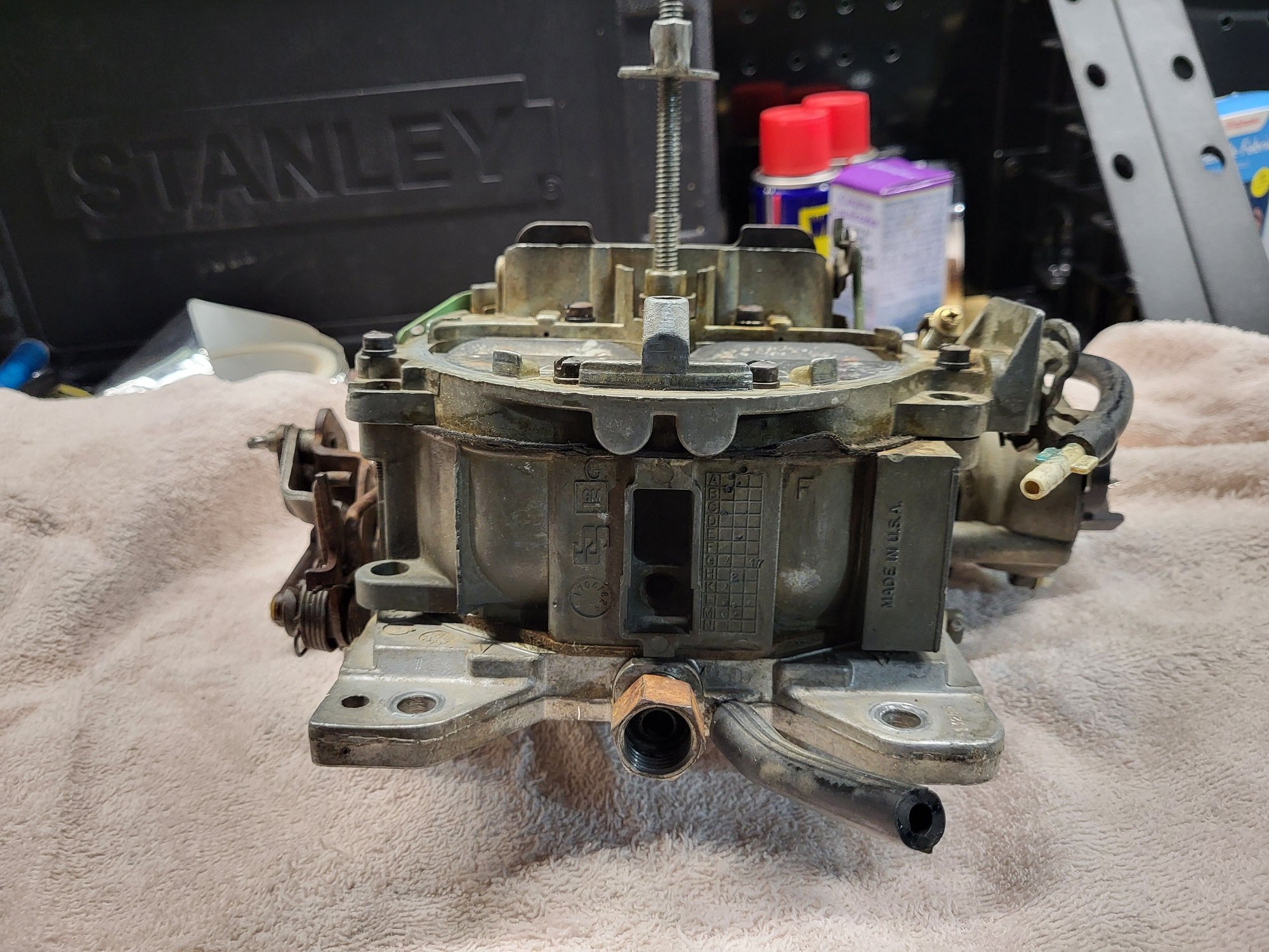

Originally Posted by 2snakes
Does anyone rebuild a quadrajet to flow more CFM i have L88 valve ported heads i dont want to change to a holley the hood wont clear. Its a 68 427. Thanks for any help
I believe that these photos are of a 1979 Buick Q-Jet, 17059247, dated 0969) that is 800 cfm. According to Cliff Ruggles, "it makes a nice HP carb and converts easily to electric choke." If you're interested in having it rebuilt, I'd be willing to get it to you for the price of shipping. You'd need to check with Lars or another knowledgeable carb person to make sure it would work in your application. Just a thought.
