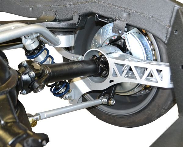

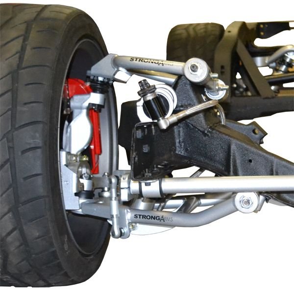

Originally Posted by JC 1975
My question is, the front in doesn’t seem to want to bite in the corner. It almost feels lazy. How do I tune out the understeer? Is it a camber issue? Do I need to drop the valving for more weight transfer? Tire pressure??
I need it to bite and rotate the rear to get it around the sharp corners as quickly as possible.
Why no rear sway bar? Also, what steering box? I love my 80's manual steering conversion for the roads I like to drive in the Virginia "mountains". But for auto-X, I'd absolutely want the faster ratio and lighter steering of a Borgeson conversion (like in my 79).
For the street in my 80, I rebuilt the entire suspension, using poly everywhere except the trailing arm (rubber) and strut rods (heim joints). I added an OEM 9/16 sway bar from a big block car (with Energy Suspension poly bushings, of course). 550 springs front (uncut) and a NOS VB&P spring rear (shortened at the factory, and marked 385 lb). The most notable improvements came from the SPC adjustable upper control arms, the strut rods, the Bilstein shocks, and the manual steering conversion. It is still a bit soft in the rear. I need to get VanSteel to make me a stiffer low-arch spring.
It does fine driving in the mountains. I can keep up with newer Corvettes, and the limiting factor is the passenger pucker factor.
