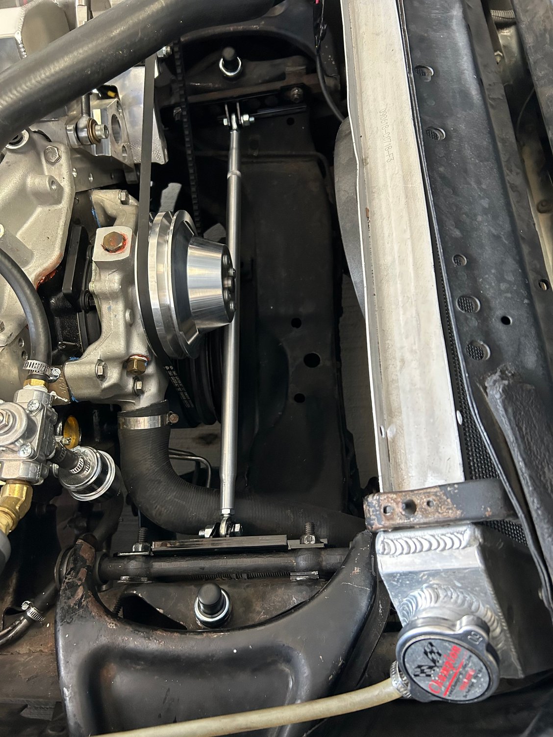

You guys have motivated to buy a spreader bar and see how it affects the cars handling. It’s supposed to arrive on Monday. I’ll check back in next week to report if there is any change in the handling.
All bushings (rubber) and ball joints (tall) are new up front. So any improvement will be attributed to the spreader bar.

There have been discussions in past posts about how to install the spreader bar. Some finger tight... I and I don't say that I'm 100% right I had my front tires off the ground and installed the spreader bar tight. Then I went to the optical alignment shop to make sure that my camber was set to the correct FOR ME .56 degrees neg. That is where I got even front tire ware.

spreader bars keep the cradle from sagging and needing a lot of shims to
align.
I put mine on tight.
late model C3s are a pain to install the bar.

Get front end on jackstands, wheels hanging. Install spreader bar tight holding shock towers tightly out. Then go for a drive!
I can actually make minor camber adjustments with the spreader bar. But it pushes both sides at once.

What's the reasoning here for installing the spreader bar with the suspension hanging? I set my car on the ground and installed it tight that way.
Probably to get the max preload? Installing it with the front end in the air, lifted by the front crossmember, would likely give the most preload.
The spreader bar manufacturer will almost certainly tell you not to do this, and that the bar should not be used to correct a sagging suspension, but how will they know?

Years ago I read on this very forum that installing it with the suspension hanging is the way to go.
Considering my results, and those of others.
(Yes, this has been discussed on here many times over the years).
I believe I did it right. I have never heard of installing on the ground hand tight until this very thread.
If your not trying to hold those shock towers tight. Why bother at all?

Does anyone make a spreader bar for a big block with stock pullies and stock fan? I haven't found one yet.

Just got back from a drive. It turns much sharper now. You turn the wheel and that’s the direction it goes. The frame had slightly sagged by about a half inch. I had to adjust it down to its narrowest setting.
Give Van Steel a call.
Their old design will fit a big block, but I’m not sure if their new design does.
No, not with stock fan. Electric fans only per their catalog.

I offered to prototype one for Dan at Van Steel.
But then I got distracted by other projects.
He is interested in figuring it out.
I'll get back to it. Unless someone else beats me to it.
A guy in Germany got it done. So it can fit, somehow.

Whether you use the spreader bar as an excuse to get electric fans, or the other way around, your car will benefit from having both.

I took my Corvette out on a longer drive that consisted of a very short tight twisty road. I can’t believe a spreader bar changed the cars handling from understeer to neutral with maybe just a hair of oversteer. I did take a shim on one side and moved it over to the other, but I wouldn’t think a shim would make that much of a difference being only a 1/16th in thickness.

Well anything that makes the front bite harder, takes out some understeer.
Glad you could feel the difference.

I bought my spreader bar from Van Steel. It made a big difference in my 73. The bar seamed to stiffened up the front end.
