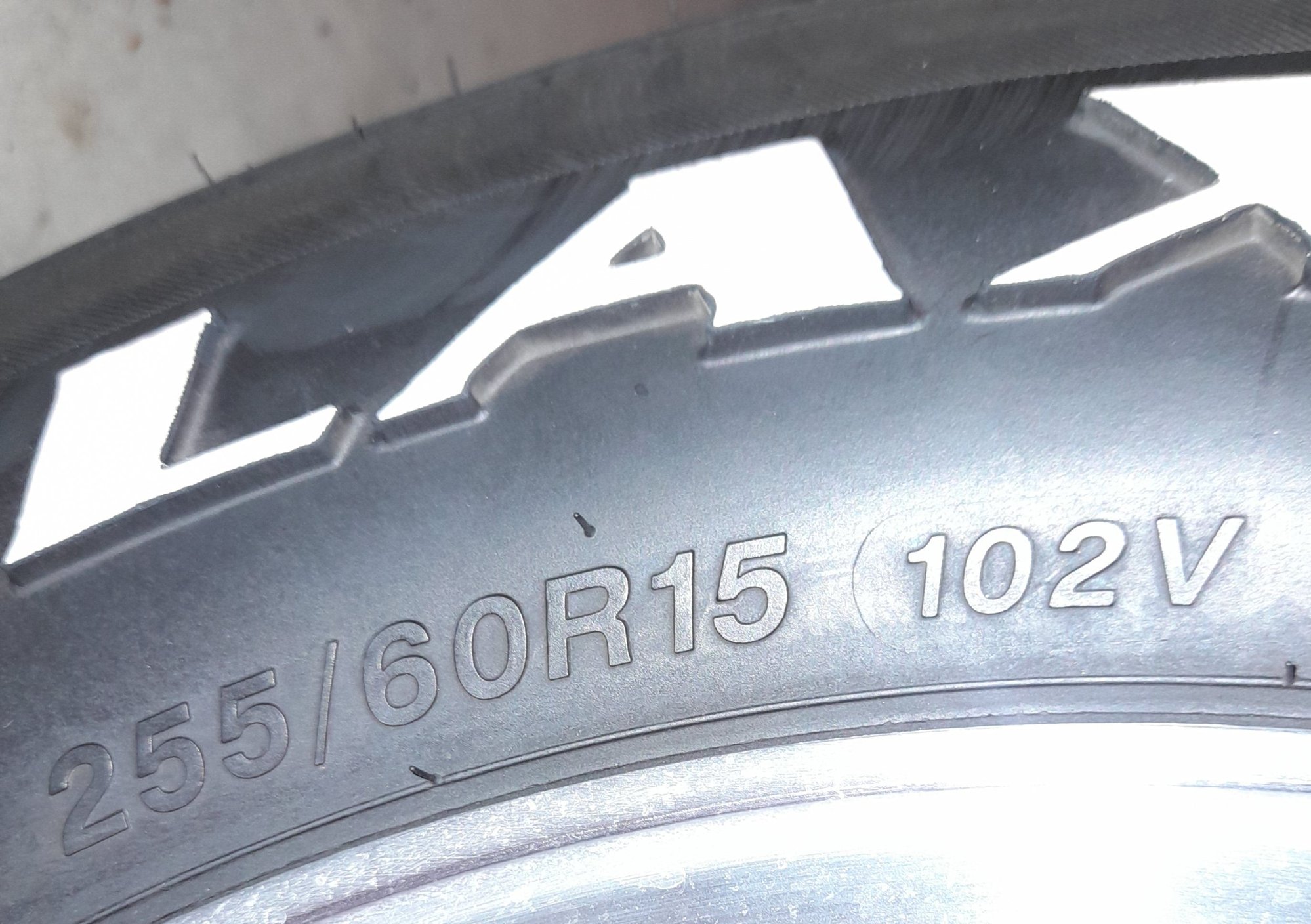

OK, so I thought over what Leigh had to say about tires, or tyres as they say here. So, I walked into the garage and took a photo of one of my tyres.
So as not to argue about what tires are available to fit factory wheels.
I have found these to "Stick" way better than Cooper's or Mickey Thompson's and everything sticks better than BF Goodrich.
I run a mostly stock setup that came factory as the gymkhana suspension set up. The original sway bar in the rear I thought did very little. The original rear spring just didn't last. The original Bilstien's finally gave up when they were around 30 years old. Which I felt was actually pretty darn good.
So being on a budget, I've done those basic back yard kinda things that I would think many would also be interested in. Getting the best handling on somewhat of a budget.
And I prefer the look of the original wheels. I understand that modern wheels and tires would transform my car. Not really wanting that however. In some ways I want it to feel like that car from my youth when I drive her. Warts and all.

Well done Doc!
Are those V rated tires?
If so, I am glad you found some!
And let us know what brand they are!
I honestly did not know any still existed in 15" sizes.
I ran V & Z rated DOT "0" treadwear autocross specials on my car back when, in that size and a couple others.
And they did stick so much better than BFGs or Coopers, the standard T rated tires, Goodyears, etc.
The stiffer belt packages gave much better handling response also.
I first cracked the 1.0G barrier on such a tire.
Because I raced & tracked that car, a dozen or two times a year, I bought a lot of tires in 27 years.
My goal was a set lasted a whole year, so I got to do a lot of experimenting.
And I am always looking for the best bang for the buck.
Dropping sidewall height, wider wheels, etc. also made a difference.
But the largest difference of them all was simply going from stock tires, to V Rated ones! Even in the same & original sizes.
If you are determined to stick with original wheels, tire size, etc, they are definately worth searching out for such a tire.

Those are Vitour Galaxy tires. You can buy them at Walmart, like many other things made in PRC. There have been several threads on them.
If they work for you, great! I'm not aware of any other V-rated alternatives for our 15" wheels with white letters.
Here are sticker tires in 255/60R15, but with black sidewalls. And at that price, you should just upgrade to 18" wheels and run Pilot Sport 4s, or whatever.
https://www.summitracing.com/parts/MTT-3452?seid=srese2
