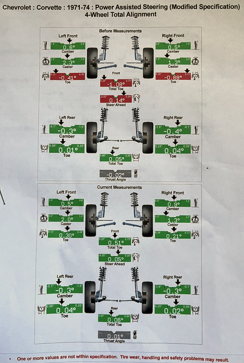

I had my '72 aligned last week and asked for as much caster as possible. What I gave them was a request for 0" toe, -1/2° camber, and a minimum of +2.75° caster.
I knew toe would be starting way out because I had restored all of the under-car linkage. Here's how it was returned to me:
Can anyone provide an opinion on how the car should feel at 55mph with the after-alignment settings? (brand new BFG 225/70r15) I'm not giving my opinion on how I think it drives because I may have other issues going on.
I'm not thrilled with the caster (2° & 1.3°) just from the reading here on the forum. If I were to use this as a starting point, what effect on toe and camber would a move of A-arm shims from front to rear be? Is there a rough guideline for the amount of caster change for a specific shim thickness?
I'm open to all suggestions except for changing components away from stock. That said, I've got poly a-arm bushings I put in a loooong time ago that appear to be fine.
Thanks!

That'll be twitchy, and probably pretty scary at 55 mph. Does it feel like you are riding down the road while balancing on a rail under your car?
What's wrong with non-stock components that bolt on? Just keep the old trash for the next guy to throw away*. Other than heim-jointed strut rods, the SPC adjustable UCAs are the best suspension mod I've done. They eliminate the need for shims.
*I just recycled a second set of front control arms that had been haunting my storage space for 5 years. The aftermarket replacements are much better, adjustable, and semi coil-over ready.

On that alignment I would say that they didn't try very hard. I recently bought 4 new tires and had my Q5 Audi aligned. I was in a hurry when I picked it up later for $1800. At home I looked at a similar alignment print out and was pissed when some of the numbers which were out of bounds on the before were unchanged on the after for a 4 wheel alignment. I took it back the next day and talked to the manager. I left with a perfect side to side numbers and all good looking.
You need to do the same thing. Side to side equal is very important. I've heard the old BS that they did that for allow for the crown on the road. We know that you turn both left and right and want the car to do each direction equally . Well you ask for easy to do specific numbers and didn't get them.
Stock c-3 upper a-arm cross bars were made to have a max adjustment of @ 4.75 dregrees. I've done it. Time, ware, and sagging can limit the adjustments. But any competent alignment person grabs each tire to feel or see slop like in the wheel bearings and arm bushings. A friend came over after an alignment and they said they couldn't do it because of too much in and out movement on the rear yokes. So we pulled his differential out at my house and he took it to a shop

You should show these to your your alignment shop.
Tell them to meet the street specs.
You need at least 3* pos caster, 4* if they can get it.
And even side to side.
They have 1/4" toe-in in front, and much less than that at the rear.
The front one means too much tire wear, the rear one means twitchy handling on a C3 chassis.
You need 1/8" toe-in in back, period, no other number. A fraction over if necessary, but not under that at all.
It is that important.
Yours is only .03" just way too low.
Yes it is a pain to adjust, but that is the main thing that needs to be done.
Take them a pack of rear alignment shims from a vette vendor.
The front one can be near zero.
Camber is way less important on a street car. It can be zero. That's actually better for tire wear if you drive gently. Up to 0.5* neg camber is ok on the street, OK if you like to push the corners. You do not need any more on the street.
The 55 year old factory specs are useless, they were meant for Bias ply tires, not radials.
Most machines read out in degrees toe-in these days, and the above specs are in inches.
Converted:
1/32" total front toe-in = 0.067 degrees
1/8" total rear toe-in = 0.27 degrees

.3* total toe would be good.
But his has another zero there.
His is .06* total toe - that is way too low.
And they didn't even try to change it before & after.

Thanks everyone. I guess I'll have to revisit the shop to discuss it - that's what I suspected my next step was but wanted feedback from folks way more experienced than I.
I should have said they didn't touch the rear alignment as it more than likely needs a change out of the T/A and control rod bushings. I just wanted to see where it sat until I tackle that job.
The specs I gave them were a slight mix from past threads from the Vette Brakes settings:

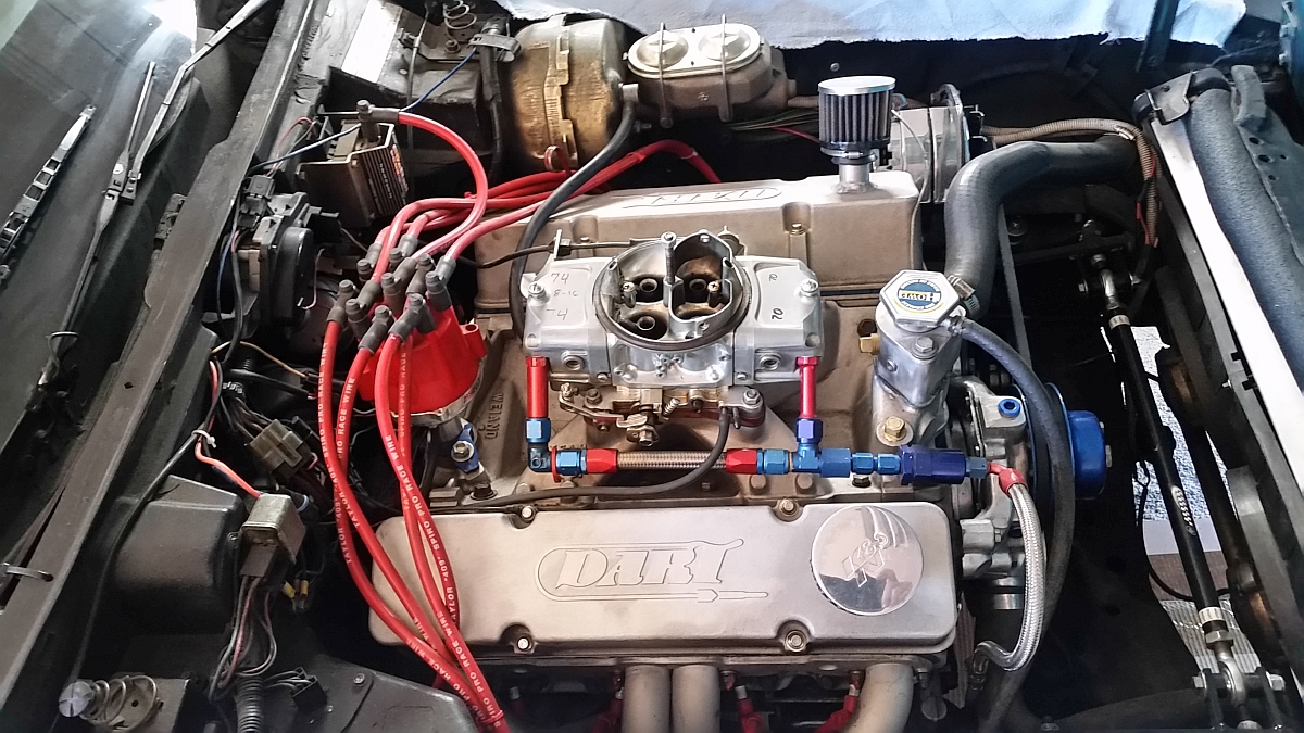

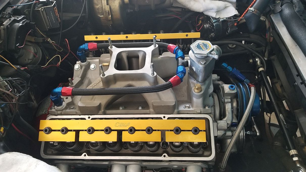

Really old picture of my 396 stroker SBC with spreader bar.
Installing my 3-4 fourth rebuild 434 in 2023. I added my dreamed up water cooling system and changed cam timing.
