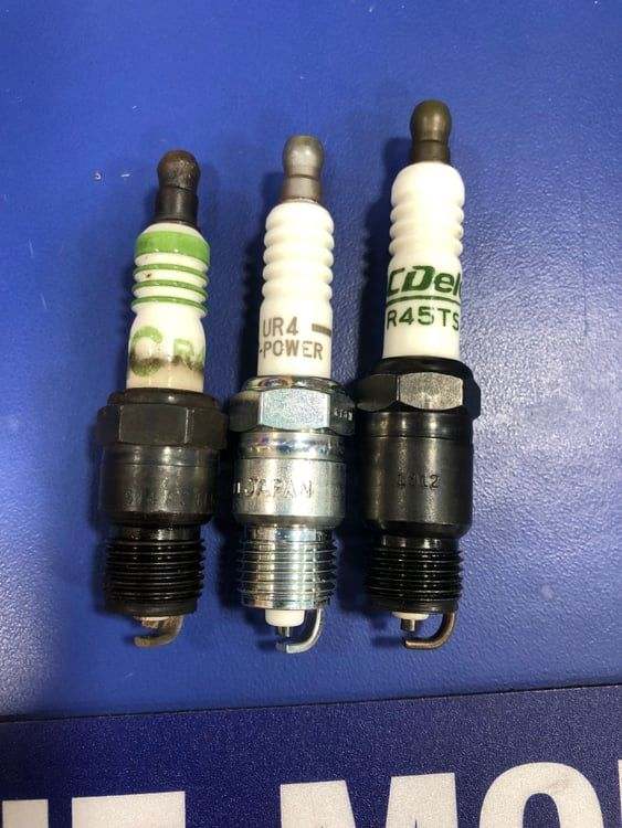

Watch length too..
ac delcos are way longer than original.
ngk non chinesium, buy from reputable dealers..
my experience here, 5 years later ver 20000 miles no issues

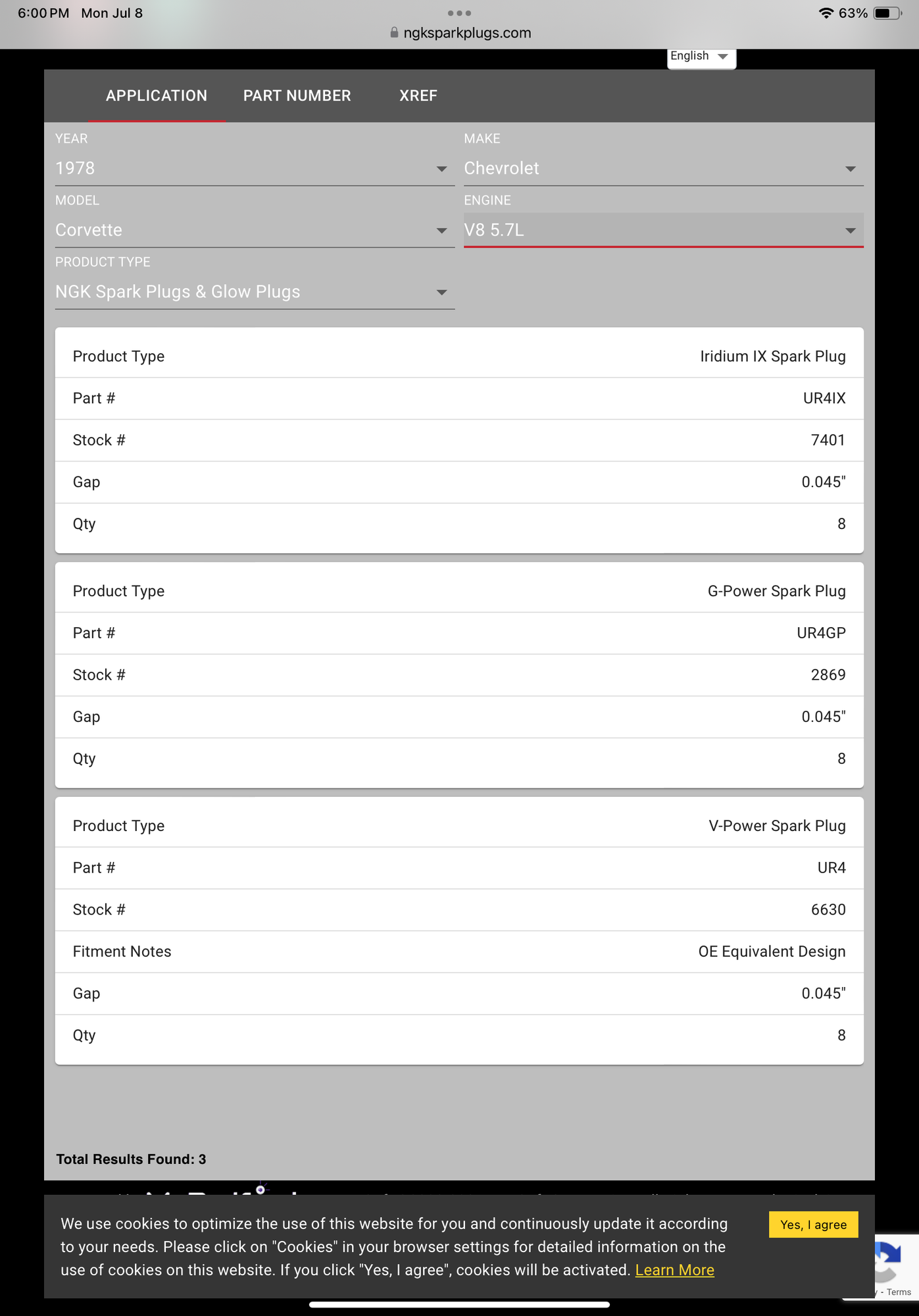

Anyone know which NGK plugs should I use on my 78 stock 350!!
Same as the one in my picture above
JJ78
ur4 v
note ngksparkplugs.com is authorized seller
https://ngksparkplugs.com/en/part-finder

Javejolt 78 if you go to Napa or O'Reilly's they say you could use these plugs - Ngk 7401, ngk 2869 or ngk 6630.....if it's not AWD that is.

And of those choices, just go with the standard, old-school "V-Power" line (UR4 6630). No reason to spend $$ on iridium and platinum. Our ignition systems and driving characteristics just don't justify the exotic metals.
