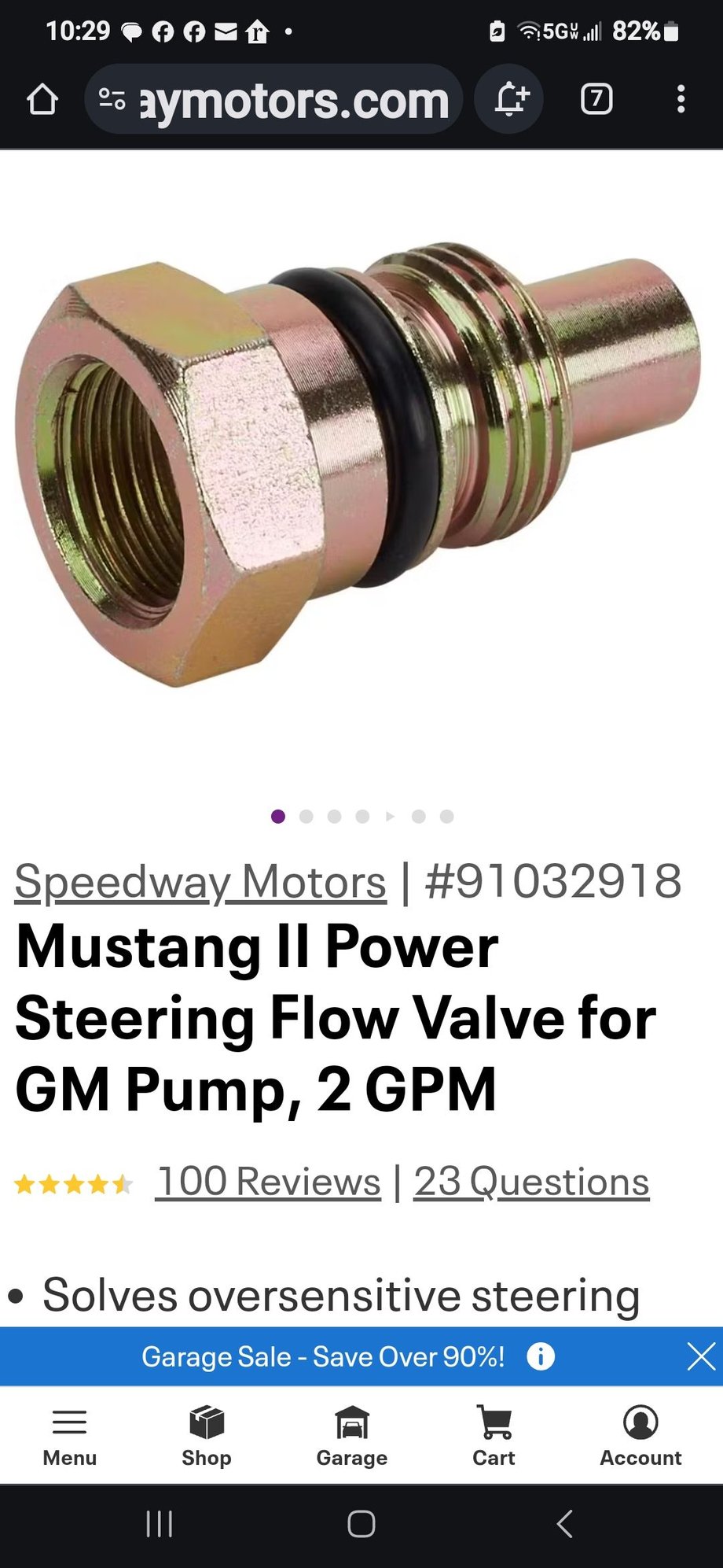

To Borgeson install complete. Not happy!
Old Aug 5, 2024 | 01:31 PM
arh's Avatar
arh
Joined: May 2005
Posts: 59
From: Escondido, CA
This is the one i am going to try. Will be delivered tomorrow
Old Aug 5, 2024 | 02:29 PM

Old Aug 5, 2024 | 03:14 PM
leigh1322's Avatar
leigh1322
Old Pro Solo Guy
Posts: 8,079
Likes: 4,431
From: Marlton NJ
I knew there was one out there for $25. Good find!
That could very easily solve your issue.
Once you get it in, obviously purge the air out.
Then stress test it.
It should be fine at normal steering.
Stress test by driving like a madman, like an autocross, very quick & large steering inputs, right then left.
If it stutters there you "may" need more flow.
If you drive it like that.
But if you never drive it like that, it may not matter at all!
The lower flow will also help keep the coolant cooler.
I will also be adding a simple solid line "loop" on my car, out in the airflow somewhere.
To help with the cooling. The stock PS system has almost zero cooling ability. So keeping heat out of it is paramount.
I have seen PS pumps boil over, and pumps burn up in a few weeks, on other guys cars. But they were convinced more flow was "better" somehow.
Also because I did it before, on a very competitive racer, and it worked well there. Mine never even got that hot.
It is probably not even needed here, but hey why not?
