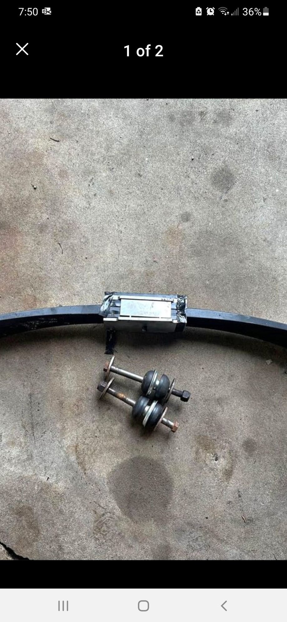

I have a 78 the rear spring is a 9 leaf that is 2 1/2" wide. I found some who has a fiberglass spring that said it was used in a 74. Every thing I read says 77 and older used a 2 1/4 wide spring. Was wondering is their any way for this to work in my 78? Spacers ware it mounts? The price this guy is asking is 1/4 of what they are new and he says it was only used a few years.

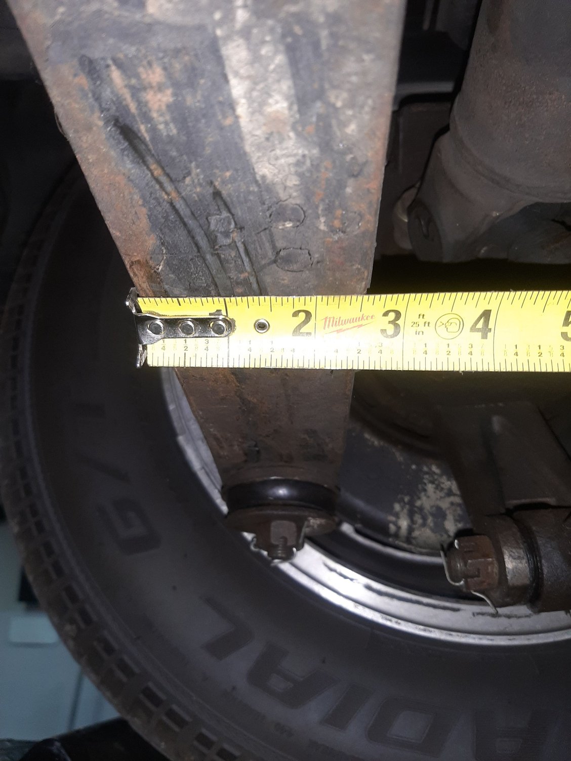

I was researching some old posts on the forum and it seems this one is a TRW sold trough Muskegon brake possibly. The one photo I posted is the only label on it from the guys photos he took.
The bolts on the car holding mine on are 1/2 diameter with a 5/8 head. I had been reading about othe years using different bolts. Hers a photo of mine. I guess I can ask the guy how wide it is.

Setting the ride height is really easy. Don't worry about that. Longer outer hanger bolts will lower the car. The weight of the spring is the most important thing you should be looking at. Most seem to think spring weight in the area of 300 -350 LB's is what most look for as a compromise between ride quality and handling. You really need to run the correct shocks with glass spring or you'll get a bouncy ride. With a spring in the 300 -330 ball park and the correct Bilstien shocks. You'll love the ride. 1/4 inch difference in width isn't going to make any difference when you bolt it up in the center. It'll be mounted on a thick rubber block on one side and thinner rubber on the other. It anit going anywhere.
