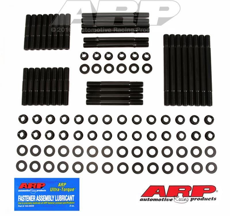

The prices are the cheapest I could find (Maybe ARP bolts are overkill?) and are a combination of Ebay, Amazon and the hot rod shop in The Netherlands.
ARP bolts are cheap insurance.

You don't need them for the pan or the timing cover. stock bolts are fine. For the heads, I'd use them for that.
One other thing is 7/16" rocker studs and associated roller rockers provide far more stability for the valve train flat tappet or roller cam. For roller cam I'd use them for sure.

No! ARP bolts are not an overkill. They are required. Never use stock head bolts on aluminum heads, ever.
The ARPs bolts have a built-in washer head plus another washer & lube to make sure the head of the bolt does not gouge the soft aluminum.
They are pricey. And that is why it's part of the "hidden cost" when switching to aluminum heads.
Better yet, get head studs.
(and a MLS head gasket)
