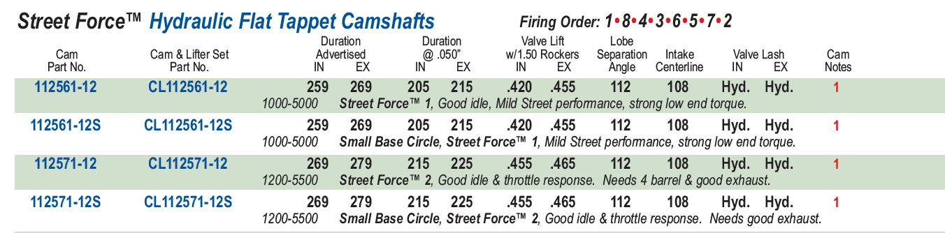

FT Cams:
For low 9 CR the old school Comp 268H was dead near perfect. It built as much cyl pressure as possible.
It has 218* dur @ .050" that's a good upper limit before the lower rpm cyl psi starts to die off.
And this old school cam has 50* hydraulic intensity (spread between advertised and .050) which lives much better & easier than the fast-ramp XE cam that was mentioned..
I do not like fast ramp flat tappet cams. They have high lobe failure rates. Leave that trick for the rollers.
One way to almost guarantee the lobes will live is to use Jebbysans detailed break-in procedure.
Another is to use Howard Cams Guaranteed warranteed not to fail combos.
They are the only co in the industry to do this, and they choose 50+* ramp cams (surprise) and Comp has had some issues with their XE cams and other cams.
Their 213* dur cam has 54* ramps and is close to the Comp 268H, but warranteed against failure.
If you want a tiny bit more cam/HP they have one in their regular listings.
The 215* Street Force 2 fits the bill. And should build low end cyl pressure, and come on strong right off idle, 1200rpm up.
Done and I bet you can "afford" the AFR heads, and stay under budget, and make more HP.

The AFR heads are worth a small premium over others, if you can handle the cost as-landed.
As mentioned before the guy that stocks & imports heads in your country will likely have a $ advantage.
Talk to him, maybe he can do the AFRs also.
What ever heads you buy, match the springs to the cam.
Those are HR springs and slightly stiffer than you would need for a flat tappet.
You want as light a spring as you can get with a flat to increase your likellihood of no lobe failure.
Those are PAC springs which are very very good ones.
It should be pointed out that the AFR enforcers mentioned in this thread are likely available under other brand names in Europe and direct from china as they are not actually AFR castings like AFR's other heads. With the Enforcer line the castings used are a chinese knock off of the dart pro one head design that AFR just recuts the valve seats and installs 8mm guides in and sells as their budget line.
They are the same chinese heads a half a dozen other people have also been selling as other brands of heads and Eric Weingartner has done a number of you tube videos on these showing they are a pretty good value. These are also the same heads skip white sold as the NKB heads until they started just reselling the enforcers themselves.
