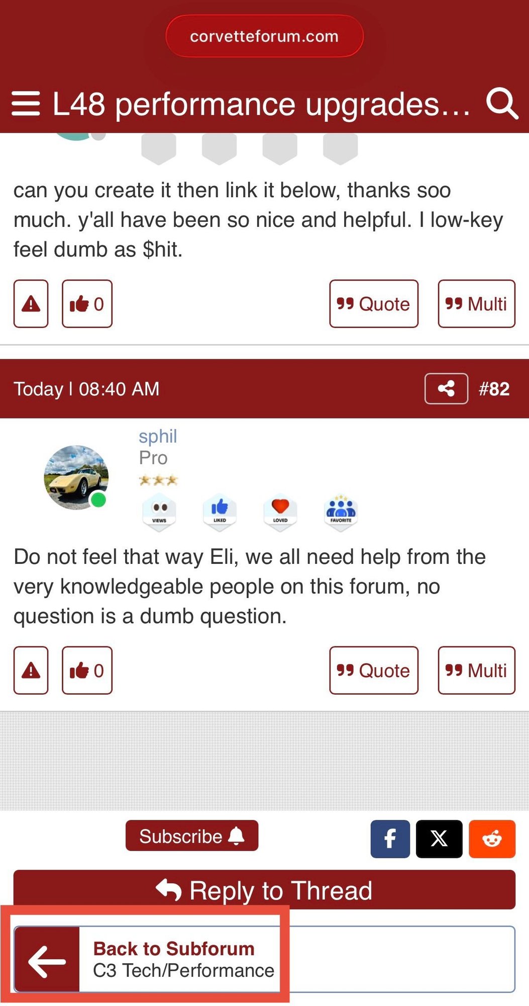

can you create it then link it below, thanks soo much. y'all have been so nice and helpful. I low-key feel dumb as $hit.

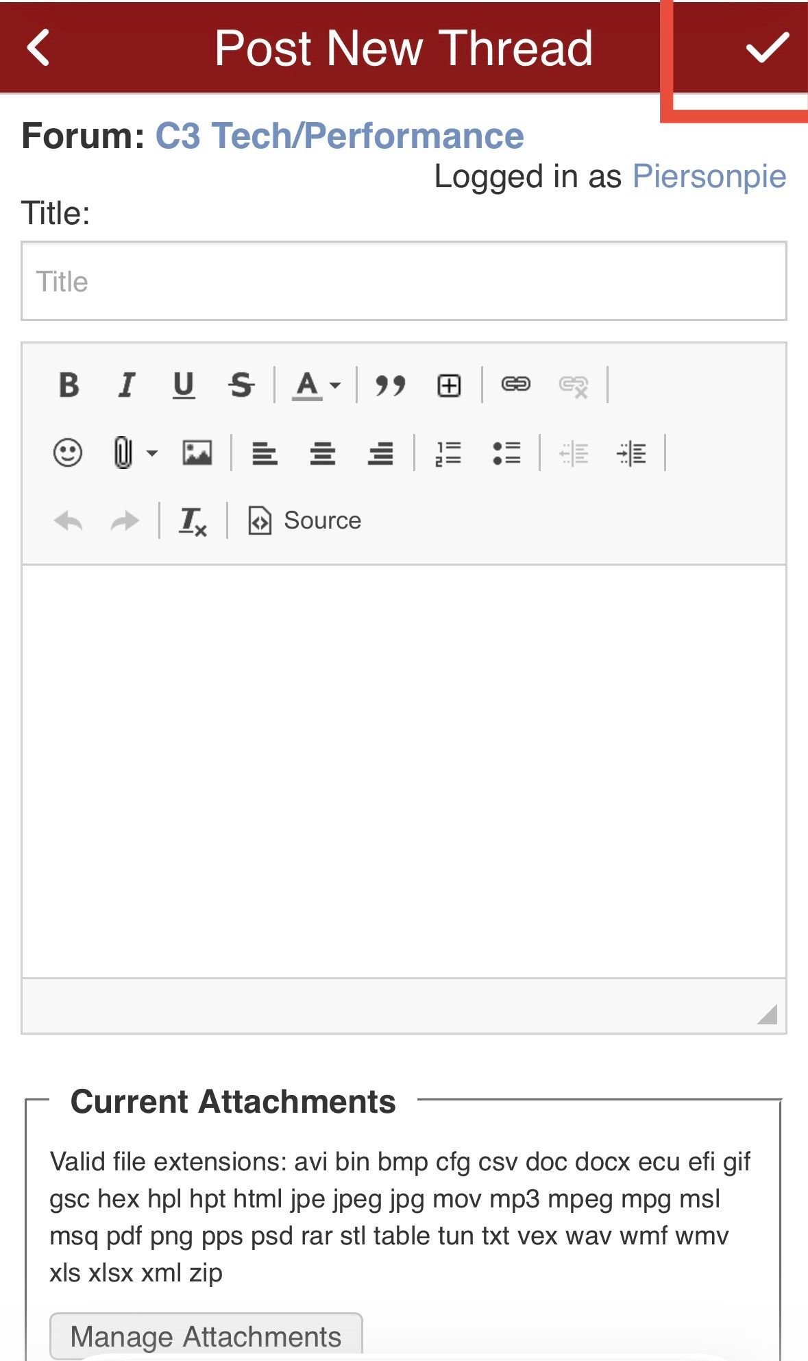

You will have to be the owner of the thread to get notified of the replies, but they’re fairly simple to make. If you’re on a phone looking at this right now just hit the button that brings you back to the main page.
After that click the button that says “Post New Thread” at the top.
Then give it a title like “1979 L48 questions” and fill out the text box with your questions just like a reply. Once you’re done hit the check mark in the upper right hand corner.
