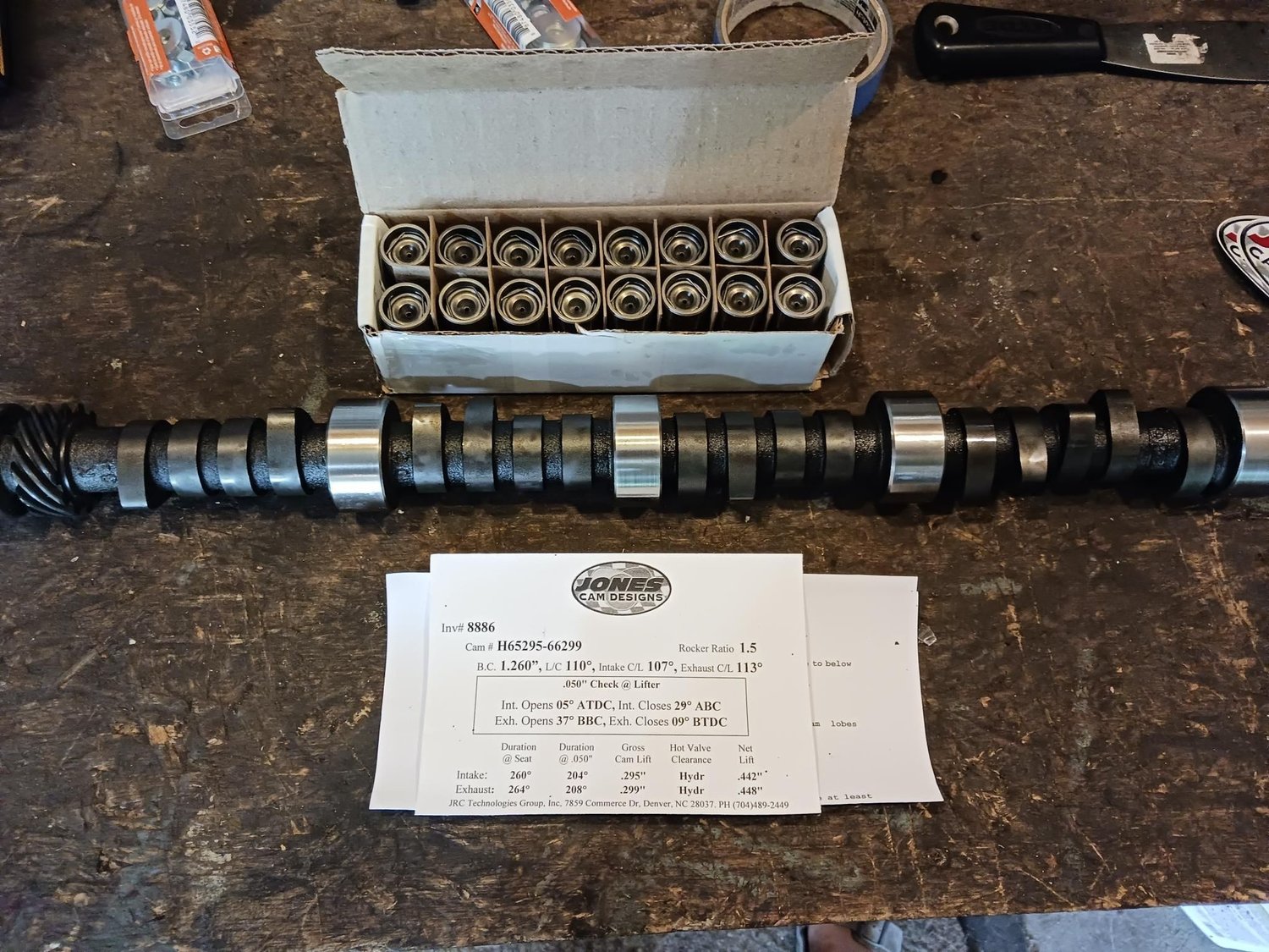

So, I originally bought the 268H cam back in March and would have my car running now if I didn't get distracted by the next shiny object, a Mike Jones custom grind. I gave him all my specs (similar to everyone living with the L48 bottom end - Trickflow DH175 heads, headers and duals, Eddy Performer, tuned Q-jet and curved distributor), told him I wanted peak HP at 5,000 rpm and a broad torque band and he came back with a grind that looked mild by the duration numbers but he claimed would make 350 HP and 380 ft-lbs. torque. These numbers are about the same as the Comp Cams website gives for the 268H. Just installed it and dialed it in yesterday, here's the cam and card:
Number look unimpressive....
The quality looks awesome, but the delivery was quoted as three weeks and was actually almost seven. It also degreed in 2.5 degrees advanced, but I had the Summit timing set so I was able to retard it 2 degrees. I have yet to read a negative review on his cams, so I'm hopeful for good results. Will post comments after I get it running.

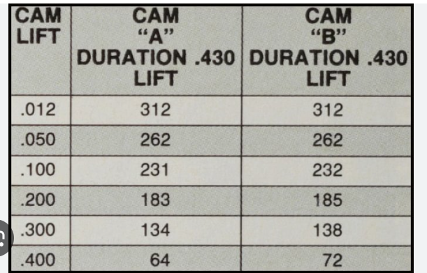

The really important cam duration numbers for cylinder filling are at .100, .200, .300 lift etc.. Not at the seat.
And not enough manufacturers give data there to be able to compare one to another.
As consumers we do the best we can with .050 and "advertised" numbers.
And note that "advertised" numbers vary as well, some are at .001, .004 .006" lift, etc etc.
And IIRC Mike Jones uses some really interesting lobe profiles.
"Inverse radius" or similar.
So they make the power of a much larger "typical" profile, and yet have much smaller "advertised" and .050" numbers which improve torque, driveability and vacuum.
Here is an example where both cams have the same advertised and .060" duration, and lift.
Yet from .100" on up, cam B has more duration, up to 4* or 8* larger duration.
They may drive the same, but,
they will not make the same power.

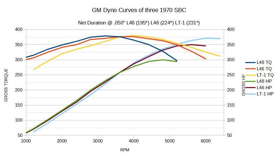

There is one more reason to keep your L48 upgrade on the "mild side" cam wise.
If you go too big in camshaft duration, low rpm Torque suffers, and then you need to add more gear to the car, to rev it up more, just to get the torque back, just to where it used to be.
Obviously the power moves upstairs, but it is what happens just "off idle" that determines how much "gearing" that you need for it to feel peppy.
I look hard at 1200-1500 rpm power for a street car. That is about how high you would rev it to release the clutch, or the torque convertor in an auto. 1 sec later, you are at 17 ft farther, (1 car length), at 18 mph, and at 2400rpm. For a drag-race 60 ft time, of 2.5 sec, you are still only going 30mph, at 4000 rpm, and just hitting the engine's main power band, 3 car lengths from the start. That initial dig, or "push" in the back, is all about torque not HP. It changes drastically if you want to rev it up more, drop the clutch at 3 grand, or put a 3 grand convertor in it.
I wish the aftermarket dyno runs started from idle, but they usually start from 3000, since they focus on peak power. And they have sold the public on "peak HP" not low-end TQ.
For a good street driver, you need to focus on low rpm torque, and that includes the gearing, and cam duration, as a package.

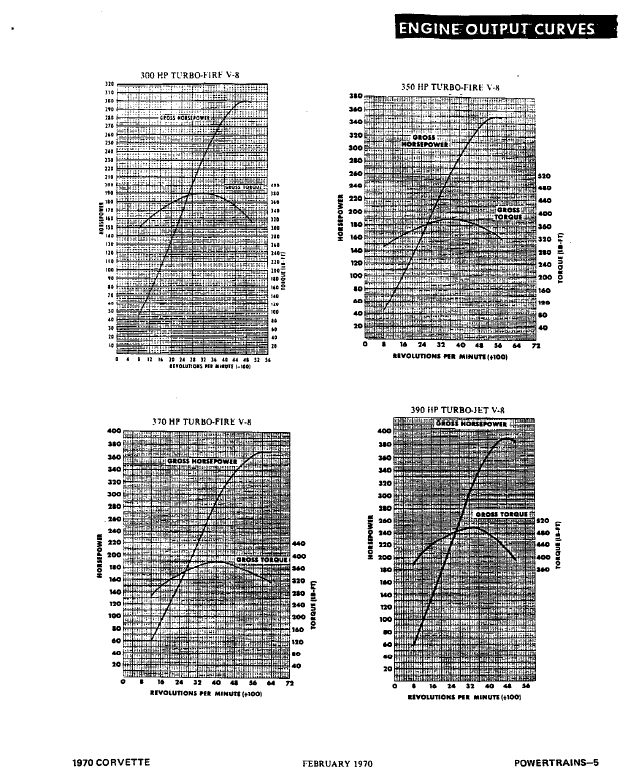

Fortunately the 1970 Chevy Historical specs have dyno sheets starting from Idle, on all their engine combinations.
They give terrific insight on what happens to off idle Torque as you increase cam duration.
It looks like, that at 224* and especially above that, you should add more gear to the car.
Cams bigger than 224* make less power up til 3000+ rpm.
The % of available TQ, at 1200 rpm vs peak, drops from a high of 84% with mild cams, to 68% with a typical larger duration but streetable hot-rod style cam (~230*).
That is 60 ft-lbs less TQ per GM. Or 20% less!
All of a sudden your 350 now pulls like a 283.
Is that really what you wanted when you built a "stronger" engine for your car?
The three 1970 350s, have the exact same peak TQ, but the available TQ at say 1200rpm, at a stoplight pull-out, drops 20% with a LT-1 type cam, with it's rumpity idle.
You can increase your duration from the stock 195*, to about 224*, before the low rpm TQ starts to drop noticeably.
FWIW the majority of musclecars had factory cams in the 210-220* range. Just like the LS5.
The L46 was my favorite SBC driver, and had the biggest cam that did not effect the low-end very much, while it added 50HP to the top end, and rev'd very well.
And it was one of the biggest of the "typical" musclecar cams.
The 224* duration spec is like the "point of no return". Another 7* gains you 20HP upstairs, but costs you 60 ft-lbs off idle.
Many of you will not believe my LT-1 cam duration spec, but Chevy specs the solid lifter engines differently than hydraulics, and I actually measured the duration on mine, while the valves were lashed. This was it's actual "net" duration, above the lash point, with it's valves lashed as spec'd. The famous "30-30" solid cam (Fuelie 327 or DZ-302) is another 8* bigger, or 239*, also as measured. It yields near 7k rpm, but the low end off-idle TQ is much worse, I can't find any chevy Dyno specs on that one. I drove that one for years, and my butt-dyno said it was very soft off-idle, much weaker off-idle than the LT-1. But it sure rev'd great. I had 411s, and it was still weak off the line! It was very demanding to drive on the street.

FYI here is the original GM 1970 Dyno Data. It starts from idle, unlike aftermarket dyno data
Here I graphed that data into a more modern format:
What strikes me the most is that the milder cam'd engine, the L48, is stronger than the other two until 3600 RPM. At typical street rpms.
The #1 most common hot rod mistake, is putting a TOO BIG hot-rod cam into your engine, or new engine, like a 230* or LT-1 cam, or bigger, and leaving the stock cruiser 3.08 rear gears in it.
And then being greatly dissapointed in your new engine on the street. It feels 20% weaker, because it is, until 3600 RPM.
The blue arrow represents how much rear wheel TOQUE you could use if you leave 308 rear gears in with a bigger cam.
The blue arrow represents how much rear wheel TOQUE you could use if you leave 308 rear gears in with a bigger cam. ( The circled spots are GMs recommended gears by engine).
If you just want to drive it on the street, buy a 220* or smaller "TORQUE" cam.
If you want to race it, and use the high rpm range, then buy a bigger "HP" cam.
Even then, 230* is still a decent "street friendly" limit, but you need gears.
Please DO NOT buy a street engine JUST based on it's HP!
If you want a huge jump in low rpm TORQUE, you need more cubes.
That is the reason 383s are so popular now.
This is a very unfortunate consequence of all those 3000+ RPM Dyno charts flying about.
