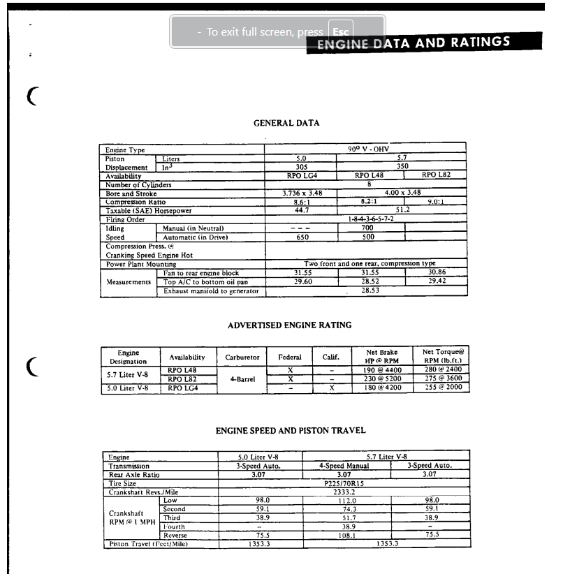

Not 100% on this but the places I have read, say that 1980 L48 had dished pistons with the 12cc

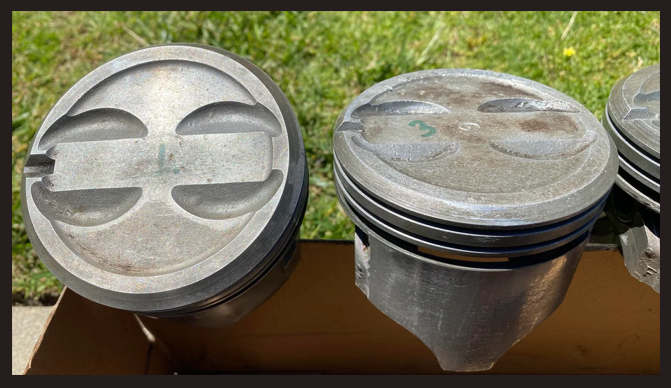

I found this pic of my engine, before 64cc heads where put on.

Absolutely correct. Original stock pistons have no effective quench zone as has been stated many times. A d-dish or flat top are only piston designs that have an effective quench. Of the two, I prefer d-dish. Smaller combustion zone promotes better burn vs the larger area on the top of a flat top piston. Also promotes turbulence during compression which mixes the incoming charge better creating a more consistent mixture of air and fuel for a more complete burn.
my d-dish pistons with 12.5 cc dish will not detonate, or at least I have not ever been able to irregardless of mixture or load or temperature. It's very detonation resistant at my 10.6 CR. I usually run 88 octane to 90 octane.
in my area you can get 85 and 91 ethanol free. So I mix the two often, by alternating which fuel I purchase when about 1/2 full in the tank.
I used to race motocross on a yz250. That 2 stroke engine was extremely detonation prone due to its .055" quench. I couldn't get a high enough octane to prevent detonation.
I took the head off and had .015 shaved off to get a quench of .040. It never detonated again. I ran 91 octane with no problem. Where as before I could run 95 octane and it still detonated.
Quench works.

Okay I found the specs on the manual to my car. This is what it states:
To L48 performance upgrades by the numbers
