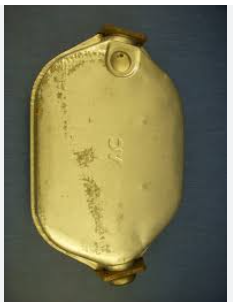

Look under and see if you have one of these:
This is the original GM style "pancake" catalytic converter from the mid '70s.
It is (was) full of pellets and horribly restrictive.
Replacing just this one part with either a bypass pipe or a newer honeycomb convertor (much less restrictive) will get rid of the 16psi restriction and add 50+ HP.
That converter may as well have been a cork, it was so bad.
The dyno test in the above post also added better flowing mufflers, and that would add say 20HP more.
Magnaflow mufflers are highly used and liked by forum members.

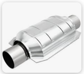

Most replacement converters today will have this shape. They are the much better flowing honeycomb style.
If you already have one of these replacements, there is very little HP to be gained by replacing it, even with a straight pipe bypass.
Now whether you need a cat at all, on a 45 yr old classic car, totally depends on your local state rules for classic cars.
A by-pass pipe would be much less expensive, if allowed. Any muffler shop could do that.
