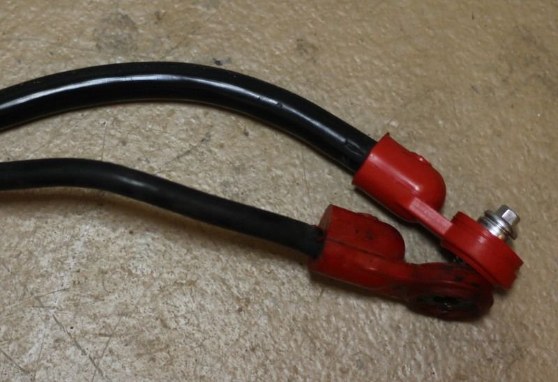

Old Apr 8, 2025 | 07:40 AM
zwede's Avatar
zwede
Joined: Sep 1999
Posts: 11,361
Likes: 383
From: Plano TX
Originally Posted by nwav8tor
I believe the original cable (at least on my 71) is a 2ga. If you've upgraded the alternator iy would be a good idea to up size appropriately. I plan to go to a 0ga. I.m not sure you makes the "best" corvette specific cables but you usually can't go wrong with Letric Limited. I plan to get custon cables made from an online outfit like batterycablesusa.com. $5/ft
The battery cables were beefed up in 1972. I replaced the cables on my 71 with 72 cables and it made a big difference in cranking.
If you upgrade you should do all 3 cables: Positive battery->starter, Ground Battery->Frame and Ground Frame->Engine block.
Here's the difference between 71 and 72 cables.
Old Apr 8, 2025 | 09:42 AM
pspicci's Avatar
pspicci
Joined: Apr 2020
Posts: 789
Likes: 419
From: Western NY
I did exactly what Zwede did above. my car is a 71 and I ordered a cable for a 72. I got mine from american autowire.

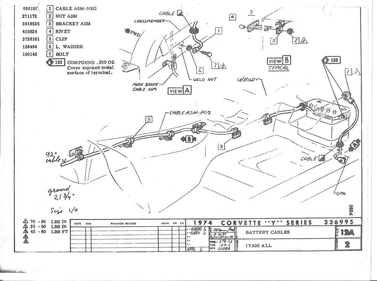

Old Apr 8, 2025 | 01:40 PM
OldCarBum's Avatar
OldCarBum
Posts: 14,399
Likes: 8,204
From: Napa Valley California
Like the 72 cables pictured above my 73 cable is the larger thicker cable and believe it may already be 0 gauge.
I know my question was only about the positive cable, but my plan is to replace the negative and ground cables with the same gauge wiring.
I purchased all new wiring harnesses from American Autowire and am very happy with what I received.
They don’t show the gauge for their battery cable sets, so I’ll give them a call.
I am running a Powermaster gear drive mini starter!
Thanks everyone!
