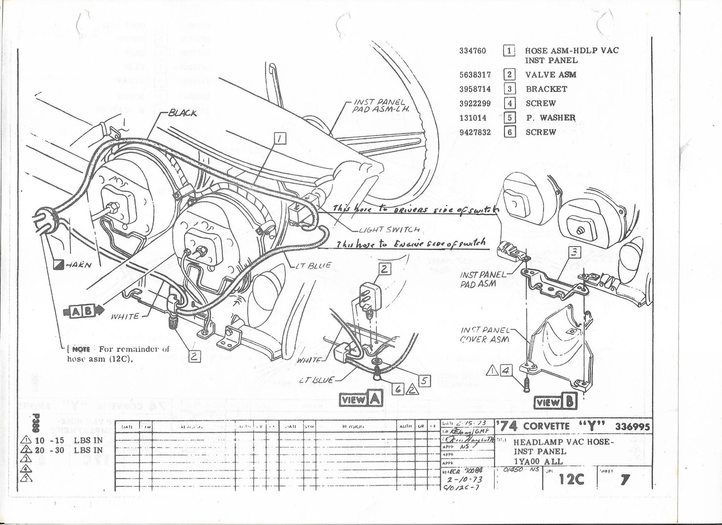

https://www.corvette-101.com/vacuum.htm
Start at the manifold and check for vacuum at each connection.
Check that the hoses at the headlight switch are correct.
He stated electronic headlights which I assume no longer vacuum operated.

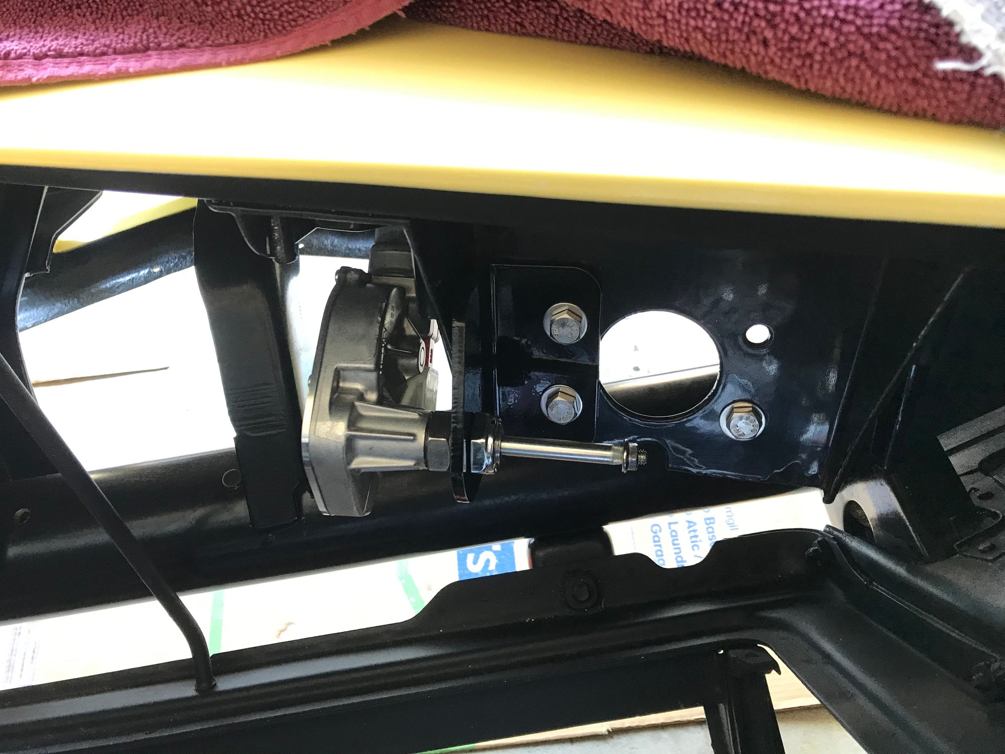

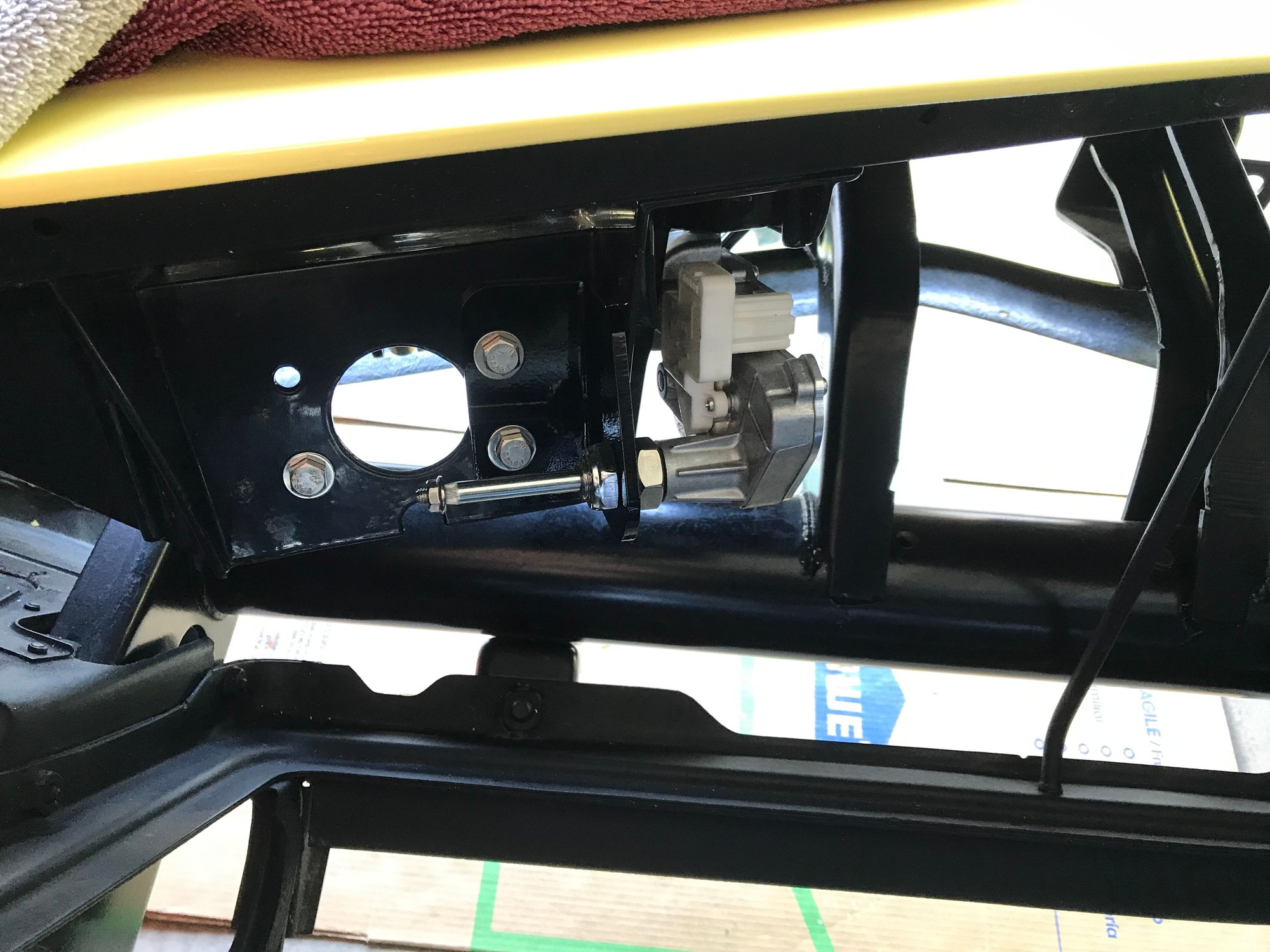

Post pictures of what you’re dealing with.
If you don’t know what you’ve got some pictures will help us see what you have.
For example, electric headlight motors will look similar to what I’ve installed on my car.
If you don’t see similar electric motors up under the hood surround, you may not have electric headlight actuators and may still have the oem vacuum actuators.
