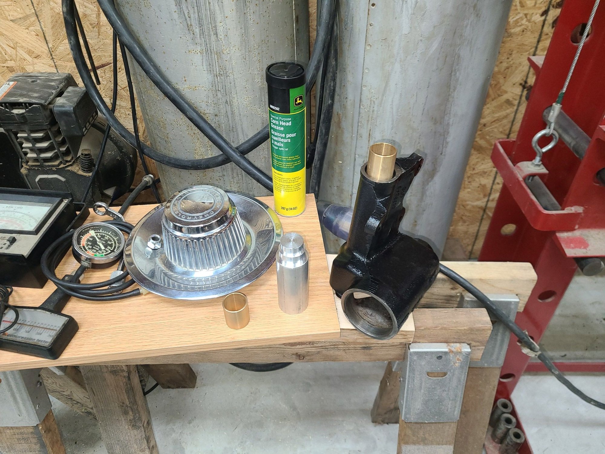

Originally Posted by GTR1999
The John Deere grease is a poly grease, same as I use from Lucas, I expect both will perform as expected.
"John Deere Corn Head Grease - AN102562. Polyurea thickened grease that is a superior corn head lubricant. Great problem solving grease for gear boxes with leaky seals. Excellent performance at extremely high and low temperatures. Resists corrosion and oxidation in wet operating conditions."
I rebuilt my steering gearbox and it's not that difficult. I used John Deere Corn Head Grease. The only issue is you need a dial type torque wrench to set the bearing preload and the high center gear preload. The kit I bought was great except for it had four 0.001" thick shims instead of the correct shim washers so I had to make a new shim washer. The service manual covers the rebuild process in detail.
My rebuild thread is here https://www.corvetteforum.com/forums...-overhaul.html
JT

I just rebuilt a box that had the John Deere corn grease in it. It was the first time I checked it, since I don't use it in my builds. While it does cling to the metal, it is too thin for my liking. I would be concerned it will weep past the seals over time. While all grease has a drop point, the Lucas Poly has been the best grease I found to date. It is not as common to find as it once was because of a very long backorder, well over a year.
Adding grease to a box that has nothing left or a mix of sludge in it, won't hurt but it's not going to bring it back either. The box in the picture shows deep mesh already and if loose chances are the gears are shot. Some box casting, relatively few, are what I call deep boxes. Most were C2 boxes, although I had a late C3 box like that last year. These are castings that should have been rejected at inspection but were passed and used as is. While I doubt this box is one of those, you never know until you check it.
These boxes should not have any play on high lash, none. Note, high lash and true center are not the same and setting up a box at the wrong position will not provide the best steering. The common rebuild kits sold today have good bearings and cover gasket. I don't use them as I have my own stock and used to machine my own bushings. Now I have the bushings made to my spec and size them to each polished sector. The kits no longer come with a cover bushing.
If the Lucas grease is not available then corn head grease would seem to be the way to go if a mechanical type guy didn't want to wait a year for a tube of Lucas grease.
Not only do the kits not include the cover bearing the one I got didn't have the proper shim washer set instead they had 4 pieces of 0.001" shims while the photo of the kit showed the proper shim set. I chose not to use them and made my own bushing to get the gap down below 0.002". There was no wear on the cover bearing so I didn't try and replace it.
JT
My concern with the corn grease is the possibility of it weeping out under pressure. Mobil 1 is a good grease but not for boxes for that very reason.
The kits sold today are not like that once were when Tom Reina was in business supplying them, but it is what it is. I don't use them. You have the machinery to make some of the parts so that is positive but most don't have that option. I replace the cover bushings and fit them as well.
And I'm happy to lend anyone the adapters I made to press things for the gearbox. They just have to pay shipping.
JT
