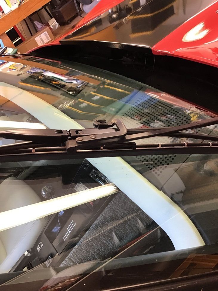

the wrong wipers can hit the hood..need low profile.. at least on a 79
https://www.corvetteforum.com/forums...ting-hood.html
